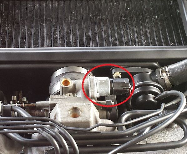

So, while fiddling about on the weekend with my intercooler trying to figure out why the secondary felt like it had lost power, I found I hadn't tightened up the secondary hose coupler properly. Just enough boost was escaping to give a decreased power output on full operation, but not enough of a leak to hear it.
Solved that issue and got curious/bored while in that general area and decided to remove my idle air control valve.
Holy smokes Batman.
This thing was caked in carbon deposit. Gave it a good clean with WD40 and a wipe with a rag, then cleaned all the gunk out of it's manifold housing and fook me, solved my idle issue!
Car would carry on like it had a bad vac leak when in N and P, since the clean up, it idles so smoothly it doesn't even sound/feel like it's on. Super happy.

Nice one Jim! On both counts. Did you bother replacing the IACV gasket or rinse/repeat with the old one? Mine wants to hunt every now and again, other times smoooooth
#353 Jimbo
Jimbo
    Livin' the Legacy
  • 2,771 posts
  • Location:B'town
Posted 07 December 2015 - 07:31 PM
Now that you mention it, it didn't have a gasket  :scratch_one-s_head:
It had an O-Ring at the end of it where it sits in the recess. Not sure if there's even supposed to be one there lol
If you have a spare 5 mins, might be worth whipping it out and seeing the condition of it. I was stumped on where I was getting the leak from and it was driving me mad, even when slowing down quickly for a driveway it felt like it was about to stall. The little bugger must have been sticking and starving the engine.

Hrmmm. Might be cause different Rev. I baulked at removing mine because no have gasket. I've given it a blast in position - will have to find the part no. and then clean that sucker properly.
With the gasket thing, I was going off this
Attached File  Untitled.png   104.51KB   6 downloads

Ahkay. Mine's different to what's pictured there. That appears to be later D-E setup.
Is yours the same as what's in the FSM picture?
#356 Robert
  • 9,419 posts
Posted 07 December 2015 - 08:58 PM
Yep can confirm that there's a little o-ring on the body of the valve

tbh I can't remember whether mine matched your pic or matched the FSM. Here's a post from Cam that made me hit the brakes cause I didn't have the gasket. Ended up nuking IACV with UEC without removing.

Major change wasn't until Rev D-E so yours being a C should be the same as mine unless there's something sinister going on!
