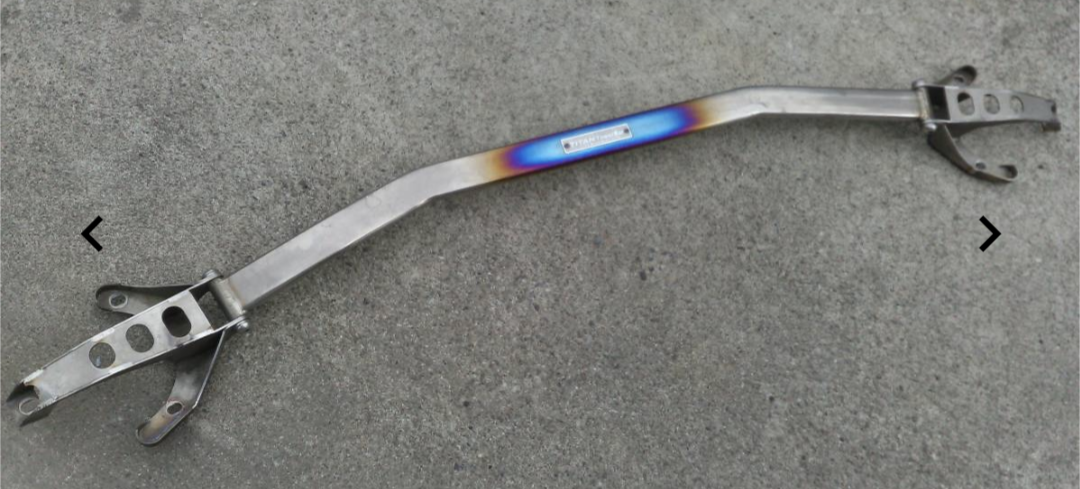

Ganador strut brace.

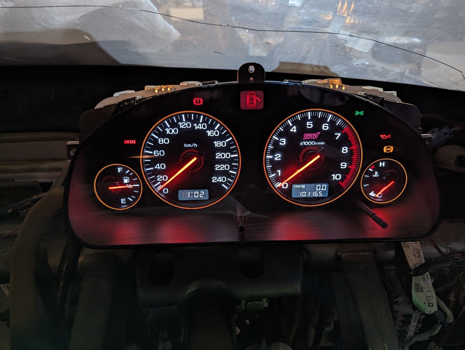

Coilovers rocked up, as well as an STi 10k cluster. It's from an auto, with a 7k redline, but that doesn't matter, I won't be watching the cluster that much anyways. At least it'll look cool AF.

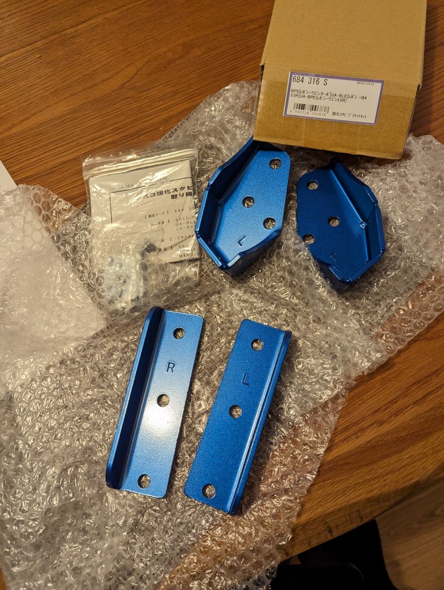

Needed to buy some cusco rear sway bar mounts as well, as the arms only came with one side's bracket, and it's too hard to find OEM ones... So they're on their way also.

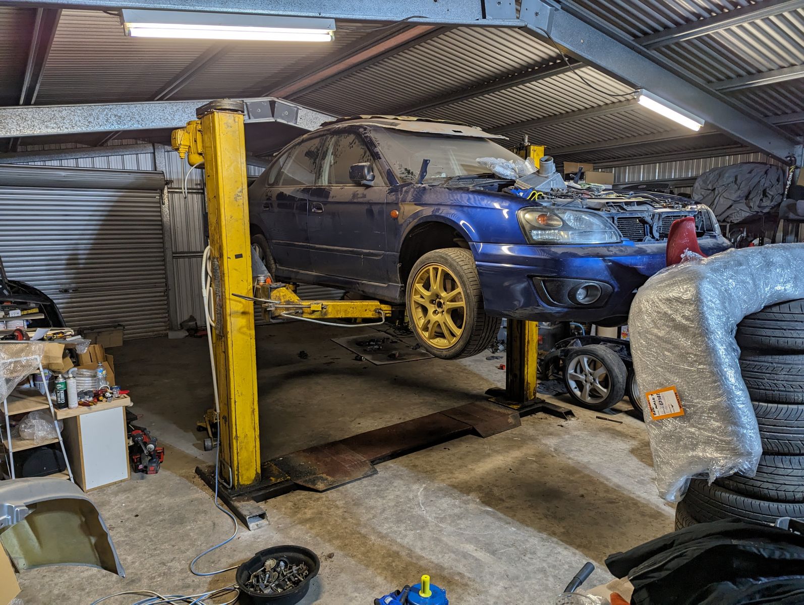

Let the shenanigans start!
See what she looks like next week once I've finished putting stuff on.

Good to see that hoist working Ben.

Thanks Simon, it's a great feeling to have it put together and going. Something I've wanted for about 15 years I'd reckon.
