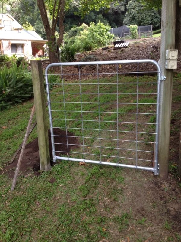

#224 Morgan
Posted 30 July 2012 - 11:17 PM
My 2c -
Bring the gate back to the grass line. It's close enough to the current position ;)
Hire a post hole digger for a morning and dig two deep holes on either side of the drive.
Throw lengths of treated pine down there and cement them up.
Wait a good week so it's definitely solid and straight.
Hinge the gate up to your desired side and a latch to the other.
By the size of your gate (assuming you're to recycle it) it will have to be hinged on either the front or back of the post and will only be able to open in one direction?
We've done 3 gates this way over the years and they've held up fantastically. We also used round pine logs but depending on your style, you might prefer the square ones.
Here's our most recent one (from a few pages back) -
Don't seem to have any finished pics though?

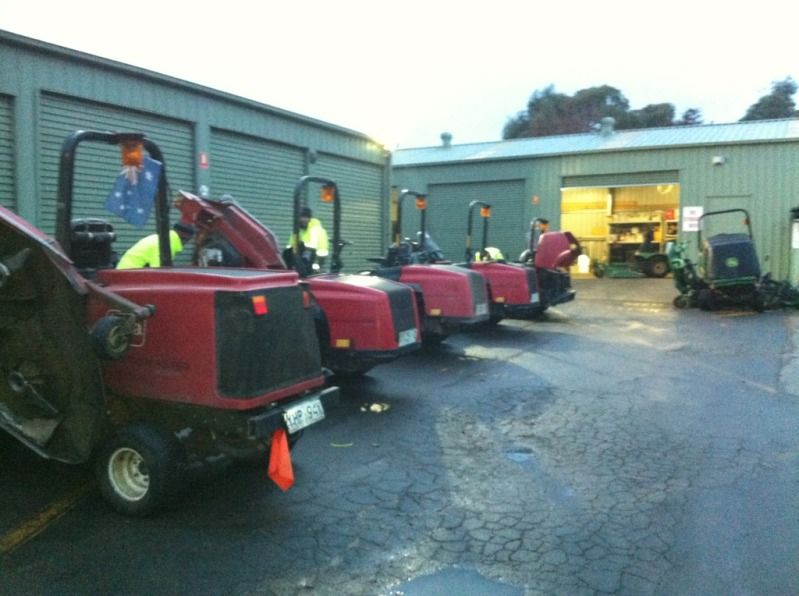

Half of our Toro mower Fleet
