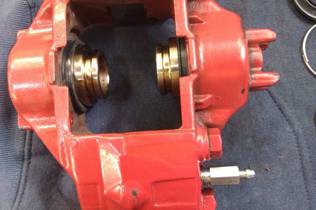

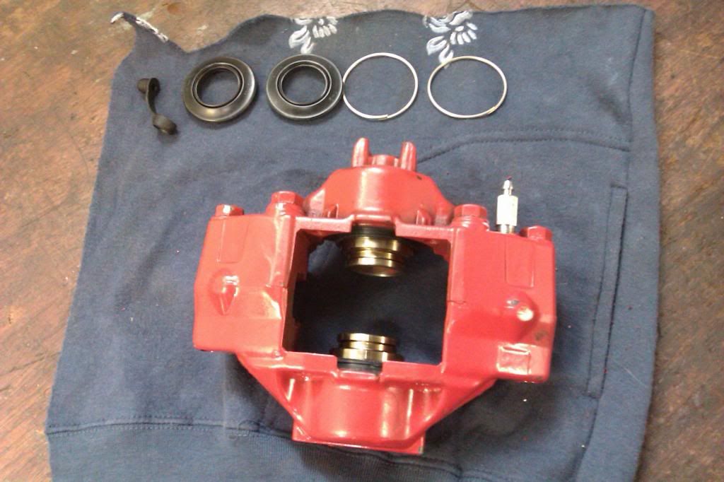

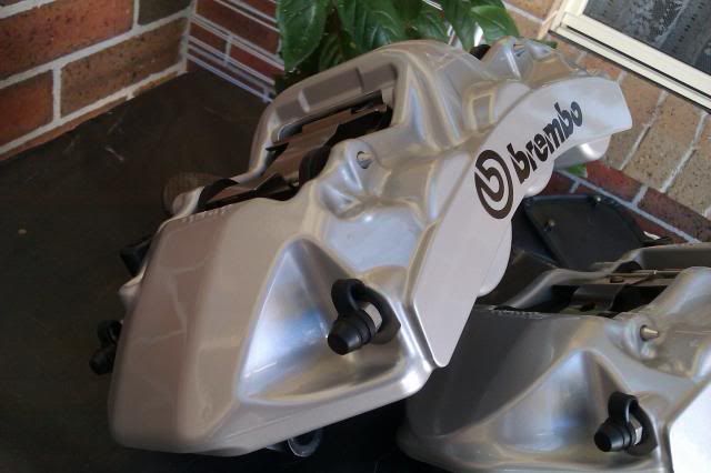

So I really havent put up any step by step pics.....

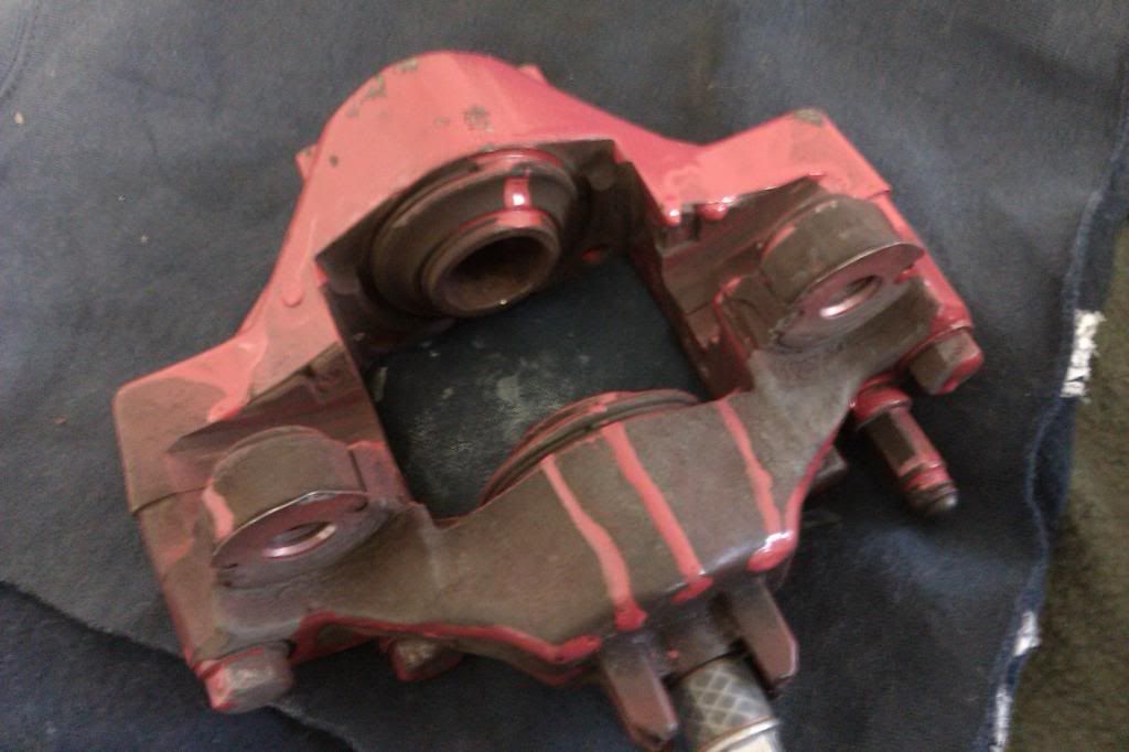

Your standard, shitty, on the car paint job where EVERYTHING gets painted.....

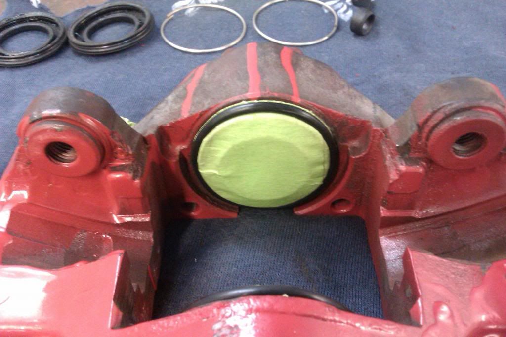

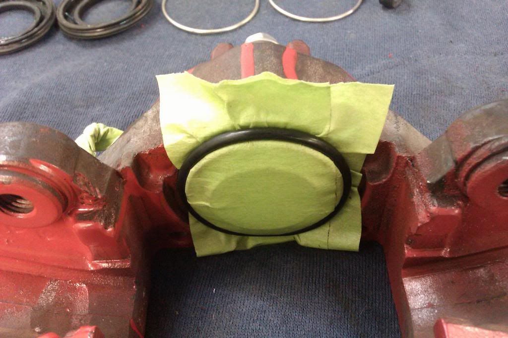

Remove and clean paint off bleed nipple, nipple cap, seals, seal rings. Remove pistons, inspect and clean crowns.
Push pistons in, cover with two layers of tape and an O ring to seal it tightly, cut excess tape off.
Sandblasted.
Paint.
1 coat hitemp primer, 3 coats color, 3 coats clear.

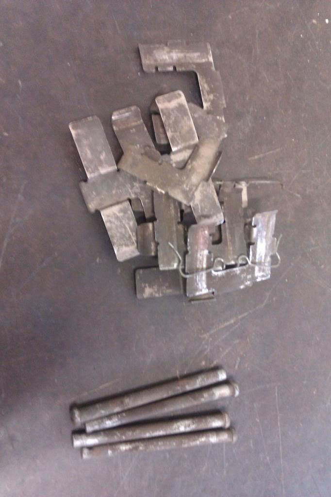

Standard s/h shims, clips and pins. All get cleaned.
Painted and all back togther.

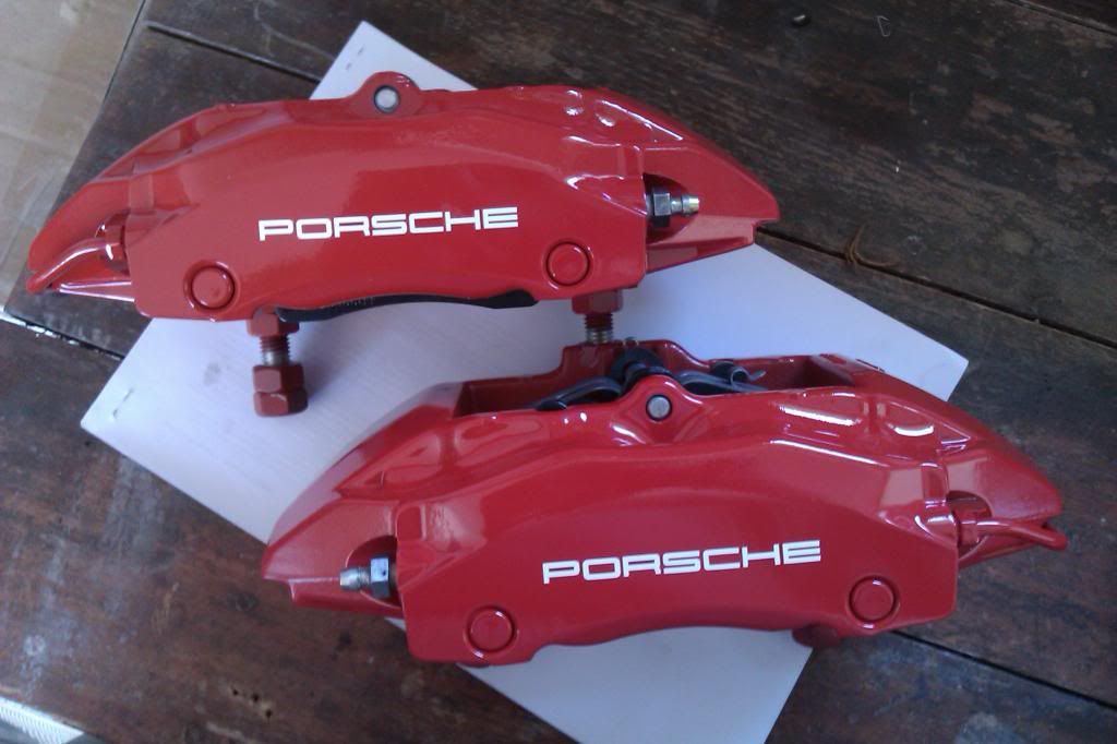

#129 CRUISN
Posted 19 February 2013 - 03:14 PM

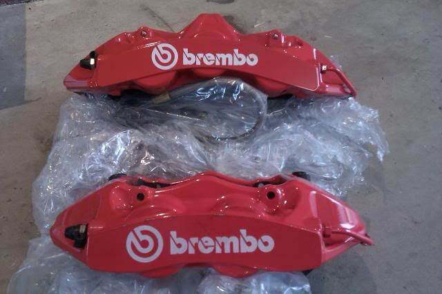

Porsche Brembo's.....

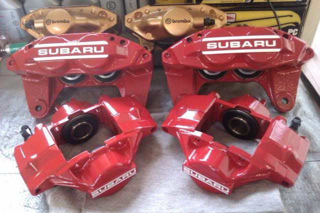

#130 CRUISN
Posted 21 March 2013 - 05:19 PM

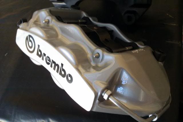

WRX 4/2 pots...

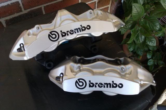

#134 CRUISN
Posted 22 June 2013 - 02:02 PM
This one is definitely brake porn! Brembo monoblock calipers. 6 pot 355mm 2 piece rotors front, 4 pot 345mm 2 piece rotors rear.
Before....
After....
