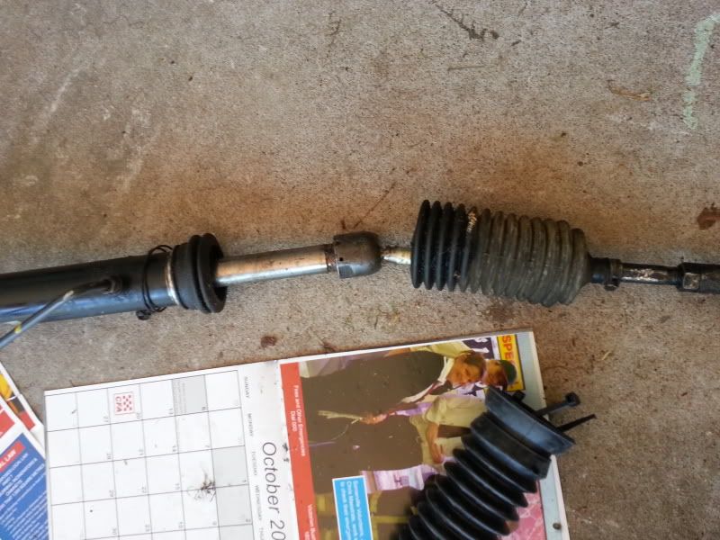

GC8 control arms?? if so did you use the gc8 sti endlinks onto a B4 swaybar?? as the standard lib links wont work properly, and the GD sti links are too short
are you talking about the GD sti steering rack?? as they arent a straight swap over due to differences in splines....a gc8 sti one will swap over pretty easily though ;)
Saying that, steering rack boots are cheap as (or you could use the wrx boots?)....but make sure theres no play in the inner tie rods as this is common on older racks...easily repaired with new ones though
Though the lib racks are shit compared to a wrx rack or better yet an actual "quickrack" off an RA......i love my quickrack!!
+1, do it once, do it right ;)
at a minimum the dust covers are easy to do...i just dropped my old 4 pots into a brake specialist with the kits and had them back in two hours and it cost $50
I used B4 control arms. Im using B4 hubs and shafts aswell as the STI ones didnt fit and my lib ones got damaged.. Havent tried to fit the sway bars yet but i did notice the connections to the control arms are different..
I do have a B4 front sway bar so that should bolt straight up.
The rack i have is a GD RA.. I did think about just changing out the boots.. So that might be the thing to do.. I just wanted to know if i could use the STI one as if it was better its just sitting there..
Cheers Vice.

Youll need B4 or GC8 sti endlinks as the lib ones dont work too well, they fit but with bad angle etc..i just got new sti ones off a GC8 and some nuts to suit
The GD sti rack wont fit without either a whole steering column replacement or a custom uni joint (this has some legality issues, but hell most of our cars have legality issues lol) due to different spline patterns
If you use the GD power steering bottle and pipework the GC8 sti racks bolt up easily, and can be had for pretty cheap (the standard 2.7 racks that is...the 2.4 RA racks are rare and very hard to find) and ya can probably use the power steering cooler aswell
Sell the GD RA rack on ricenet and get one that works without mods i say, dont pull boots off that, just get new boots as someone will grab that and itll be harder to flog off without boots

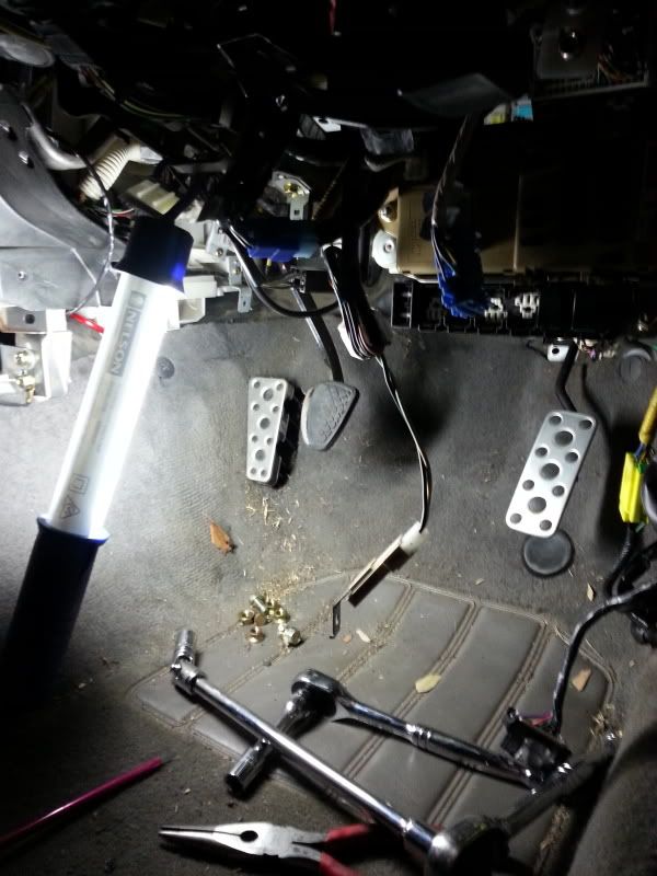

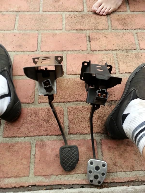

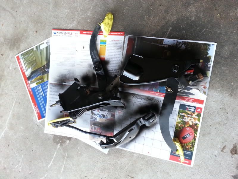

I did get a bit more done tonight tho... Pulled all the pedals out the STI and prepped them to go into the Gen 3..
They where farily rusty like the rest of the half cut so i ended up giving them a quick going over with a wire brush and some can paint...

Posted 20 December 2012 - 09:17 AM
Went about installing the new pedals last night.. went failrly smoothly..

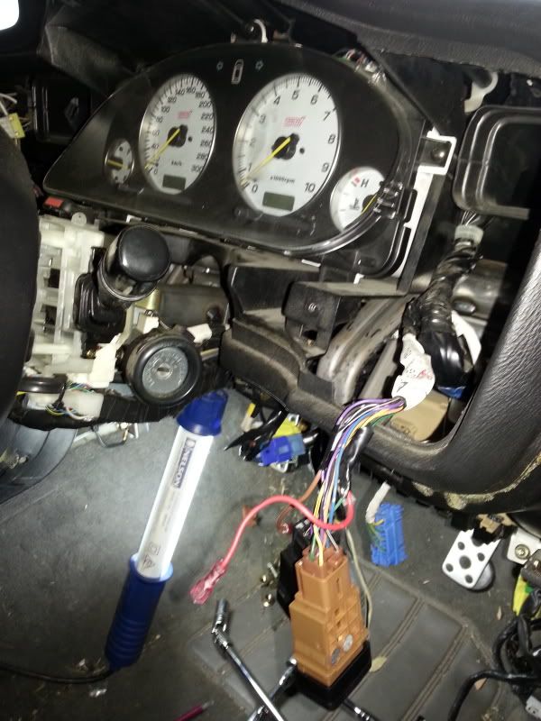

little bit of work over the weekend between drinking and eating.. Got the rest of the pedels in and replaced the broken steering boot on the steering rack.. Was a bitch getting the bolts off the rack so i could get the new boot on as someone had put lock nut on the thread..
Also went about fitting it to the car :)
