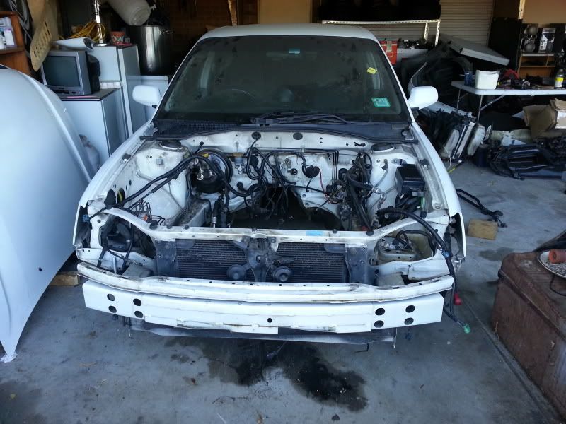

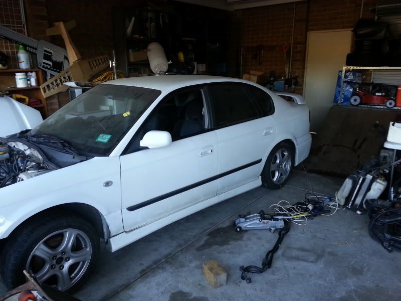

Oh and shes back on her wheels after 6 months on stands !!! Going to the tuners to have a the FMIC, exhaust, turbo, fuel system, injectors, new engine, etc etc fitted next week .. :)
Just got the little fiddly bits finished last night..

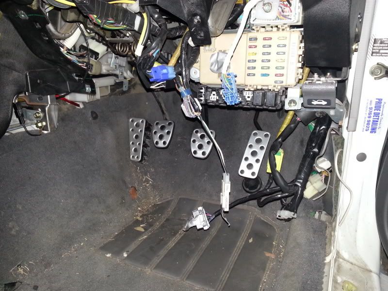

Finished off the pedel install.. Swapped over the full gas and brake pedal setup, But only swaped the pedal cover on the clutch as the lib one was different to the wrx one..

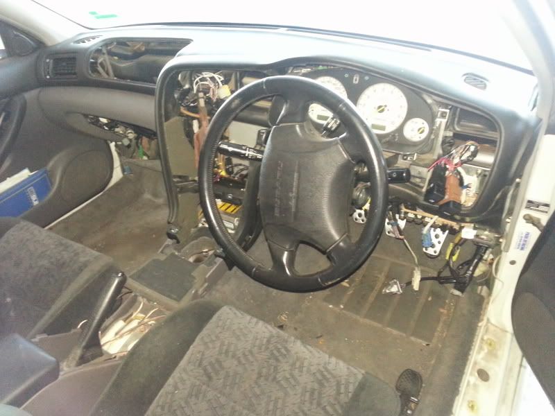

The interior is going to remain at this stage untill all the electrics have been checked .. So ill be driving like this for a bit..

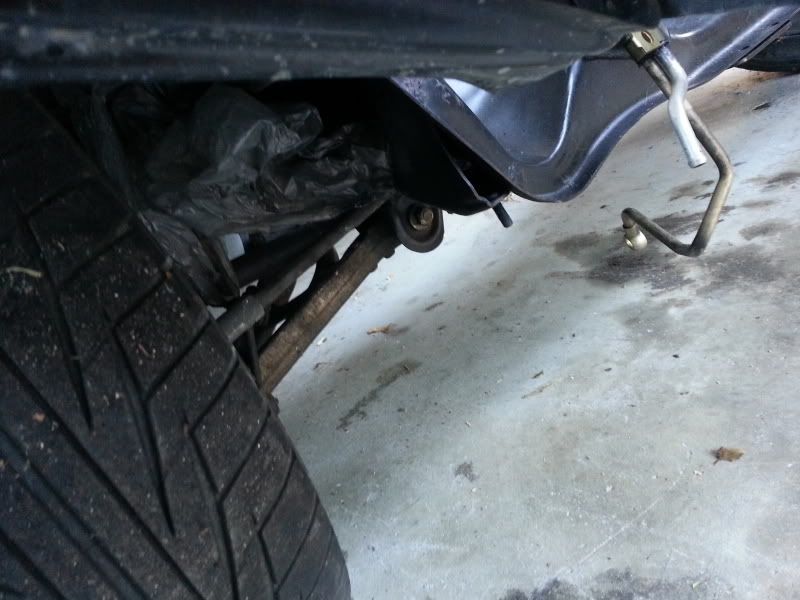

I also finished up setting up the ball joints on the hubs, steering linkages etc..
Good times ahead.. Vice

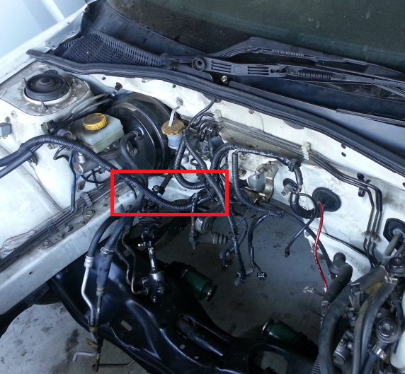

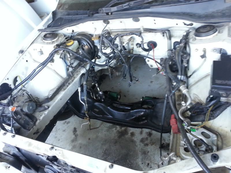

BTW.. is this the brace that needs to be removed to make room for the down pipe ? I rember reading that B4`s didnt have it..
Thanks
Thanks
Looking the goods, Can't wait to see it finished.
As far as I know this is the brace that everyone talks about being in the way.
