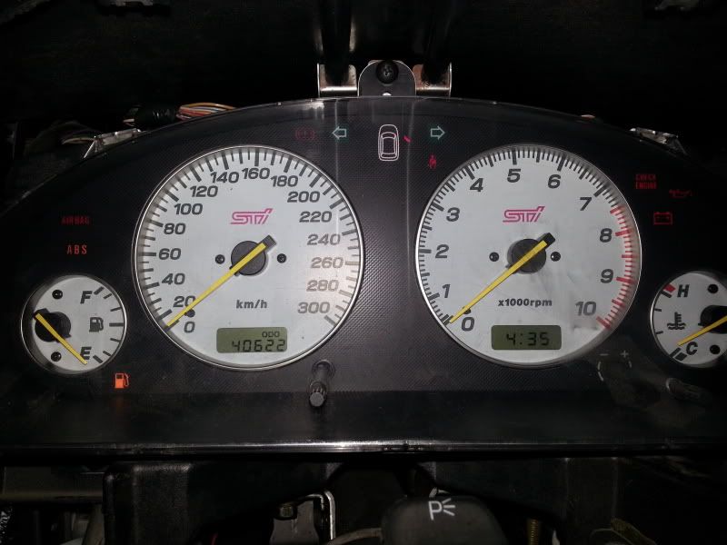

As for the solenoid problem Turns out one of the the solenoids was faulty and is being replaced atm.. The dash cluster is now working ( I just had a plug half pushed in under the dash ).. ANd the alternator problem is now sorted..
