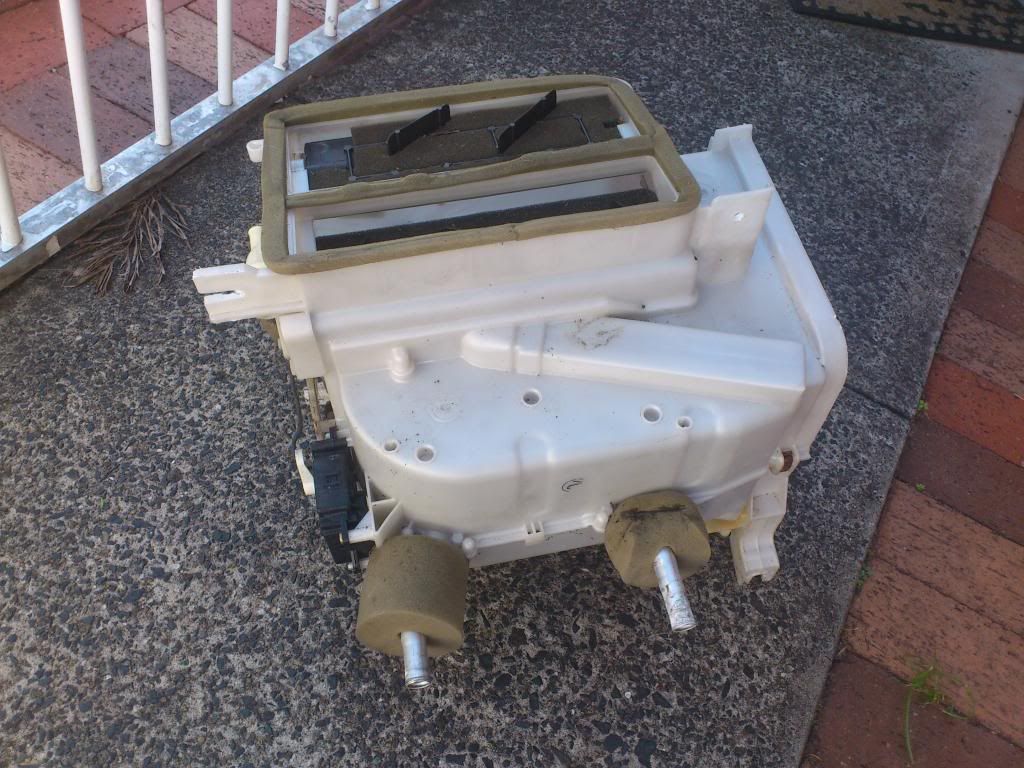

last night i noticed a coolant leek under the car. after further inspection turns out its coming from what I can see to be the inside of the car.. SO im assuming its the heater core..
Worst thing is everything in the dash is now working and I think ill have to pull the whole thing apart now.. ive checked where the hoses join on the firewall and they seem secure and dry.. Any other ideas ? This is ending up in a small ammount of coolant in the passanger side footwell.
Cheers Vice
#791 CodeBurn3r
  • 4,048 posts
Posted 29 April 2013 - 10:12 AM
Heater core for sure...
you may be able to get under the glovebox and pull out the glovebox and inner cover and see whats going on.. hopefully just something loose.. but if not.. its going to be a bitch but has to be done :(

#793 Scuba-Roo
  • 6,960 posts
Posted 29 April 2013 - 11:40 AM
Just by pass the heater core
Because racecar.
Because racecar.
Its defiantly a option I considered.... Could I just Close the loop as in the in pipe connect it to the out pipe and be done with it ?
Maybe a temp fix until the parts arrive.
