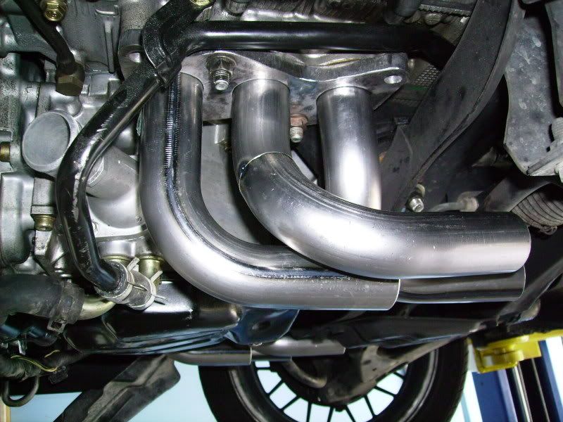

Progress.
Inlet manifold on, throttle cable anchor bracket made.
Got a box full of bends and flanges to make the extractors. Ended up short changing myself on the mandrel bends so only got one made today.
Drivers side headers done. Went with 31" long primaries after some googling. They obviously aren't 100% equal length but are within an inch of each other. The secondary pipes will meet behind the gearbox.

Dang that's some speedy work. Love the throttle cable bracket, looks pretty much factory. Do you focus on 1 car at a time Al, or are you also making similar amounts of progress on other cars at the same time?

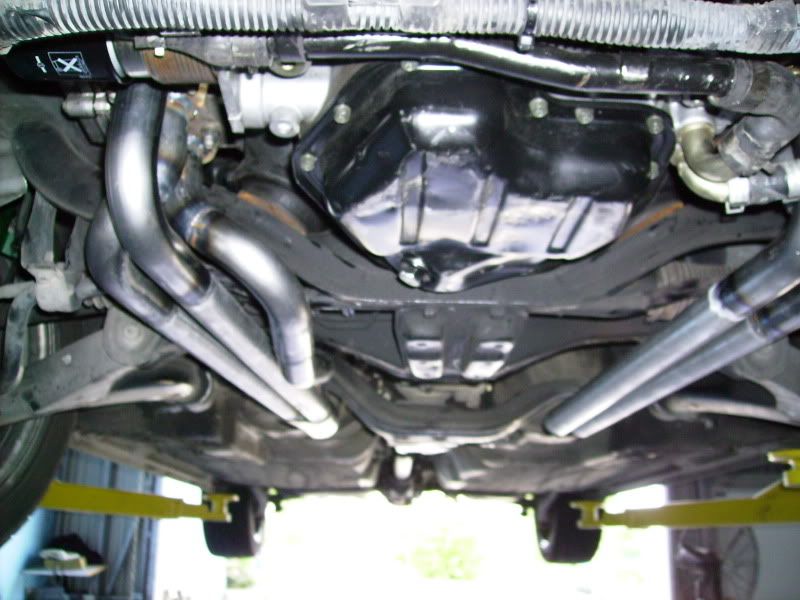

All are you going to merge the exhaust, or run it as a twin system right to the tip??
TSM
#355 Blaeven
Blaeven
    The Renowned
  • 1,400 posts
Posted 05 February 2009 - 05:20 PM
we're just going to run it into the 2.25" exhaust that's on the car... the fartyness shouldn't be there, and 2.25" should me more than enough for the 3 liter...
if it restricts power when it's on the dyno, i'll look into it more, but for the time being, we're sticking with the one that's on there...
#356 CRUISN
Posted 05 February 2009 - 06:39 PM
If it were mine, id definitely be going bigger than merging them into a single 2.25. Put an X pipe in there and run it twin right through!
#357 jzk25
jzk25
  • 158 posts
Posted 05 February 2009 - 07:36 PM
LH headers being welded to flange plate and collector inner welded. The flange is bolted to a 10mm plate to minimise warping.
All done.
The mandrels are all black pipe so will rust pretty quickly without protection. A can of heatproof paint does the job.

Al, do you think it would gain anything from a twin system? I know how it effects V8's. I'd apply the same theory to the h6 and expect similar results. Do you think it would have the same effect?
