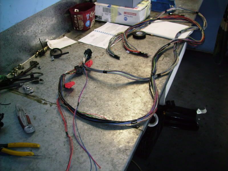

Anyhoo, I wired up the V88 today. 67 wire loom, I didn't use that many of them though.
Took a full day to get it to a usable state. Started by making notes on what the inputs and outputs would be assigned to and whether the wires needed for them would remain in the car or go out to the engine bay. I seperated the wires that needed to stay inside the car. These were for things like ecu power, fan control, tacho, A/C request and relay and fuel pump relay control.
After getting a position reference for wiring length so the loom would reach inside the car to the ecu location I then chopped up the original engine loom and pulled out all the plug connectors that were needed. I then joined the V88 loom to the engine loom connectors.
This took about 6 hours. The EZ30R has 4 control solenoids for cam lift and timing, one crank and two cam position sensors, 6 injector and ignitors, a map sensor, tps, water temp, intake temp, idle control and cannister purge solenoid. It all adds up. There's also the power and ground network.
Here's the pieced together harness. It is one piece from the engine to the ecu. The ecu plugs are then routed out into the LH guard under the fuse box and up the guard into the LH A pillar wiring grommet and down to the std ecu location.
Once the harness was routed into the car(this required dash and fan box removal) I could then make a connector for the power supplies and control wires that go to the original loom.
Then I powered up the loom sans ecu and checked all the power supplies were present. All good. Plugged in the ecu and updated the firmware via the latest software. Went through and set the triggering and settings for sensors and input/outputs. Had a couple of q's about some settings so I rang Mark at Godzilla and he walked me through it over the phone. Half hour later and we are all sorted.
Hung up from Mark and looked at the time, 5.15pm. Fark, have to pick my 3yo up from Kindy 15 mins ago.
Shut the door and picked up my Son, the end.
'sif. Did a final check and craked the engine over again.(had already cranked it to get oil pressure earlier).
Gave a splutter or two. Upped the total injector ms from 10 to 15 and gave it another kick.
Fired up and idled nicely. Gave it a few revs. Nice.
Vipec/Link, good.
