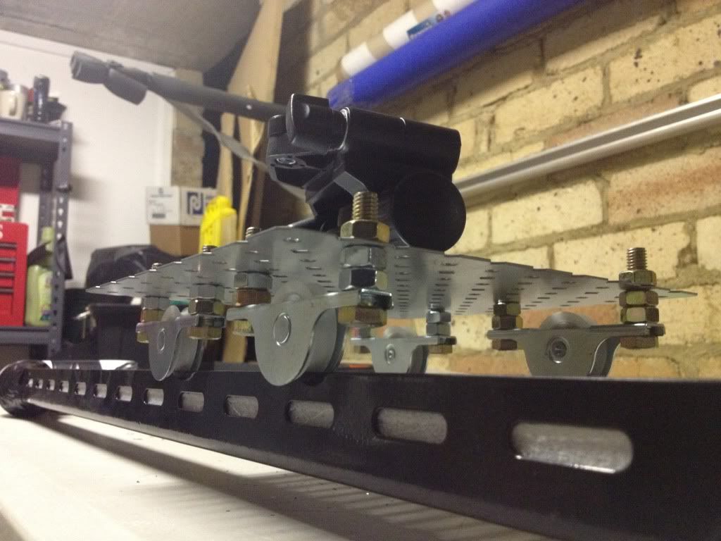

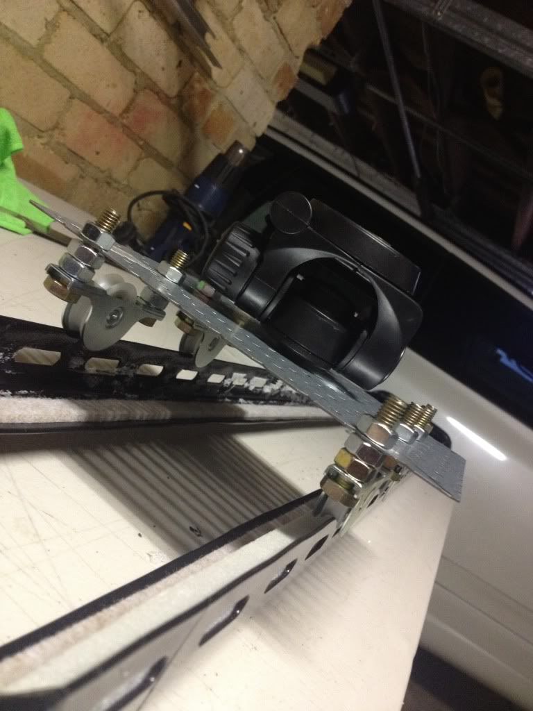

So I redesigned my slider. The old one was rubbish. Jerky, didn't slide properly, and made the footage way too shakey.
Anyway, here is Slider v2.0. I'll most likely design a new track for it in a few weeks, as the one I have now is a bit warped, but yeah, a million times better already. I used wardrobe wheels with floating bearings for moar smoothes. At $22 for 2 wheels, they aren't cheap, but the end result was worth it.

Most of those shots are fully zoomed in using an 18-200 lens, so I'm pretty happy with the stability even on full zoom. The "dolly" itself is perfect, now I just need to change the rail, as the rail is slightly warped causing it to shake when going quicker. Watch in 720.

Also, could you re use the angle by spinning it and using the pointed edge for the runner? Or is it wavy aswell?
Well the issue is that the cabinet rail is around 2mm thick, and the wheels need a ~4mm thick runner to fit nice and snug. There is about 2mm of free play at the moment, which is causing the instability AFAIK.
Plus, I wouldn't mind having a longer rail.

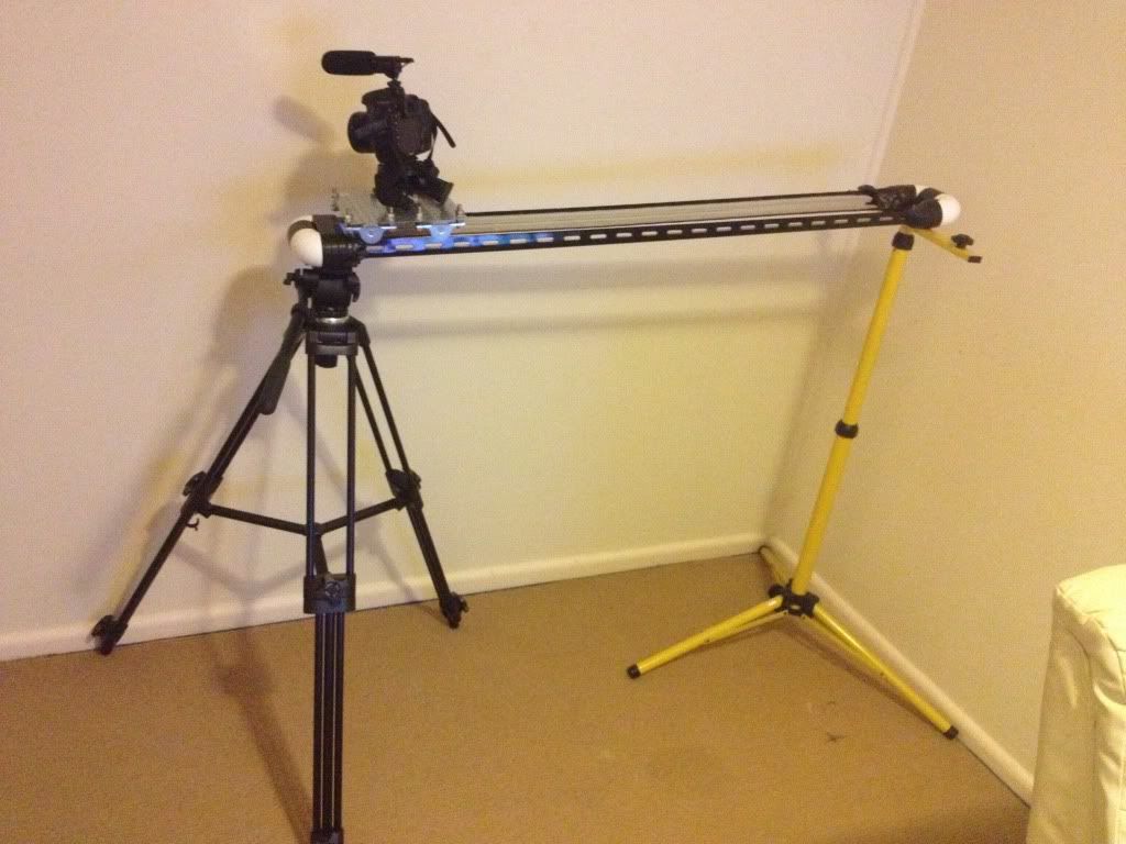

Well my slider is now height adjustable. And I've added an external mic for better sounds with less wind noise
