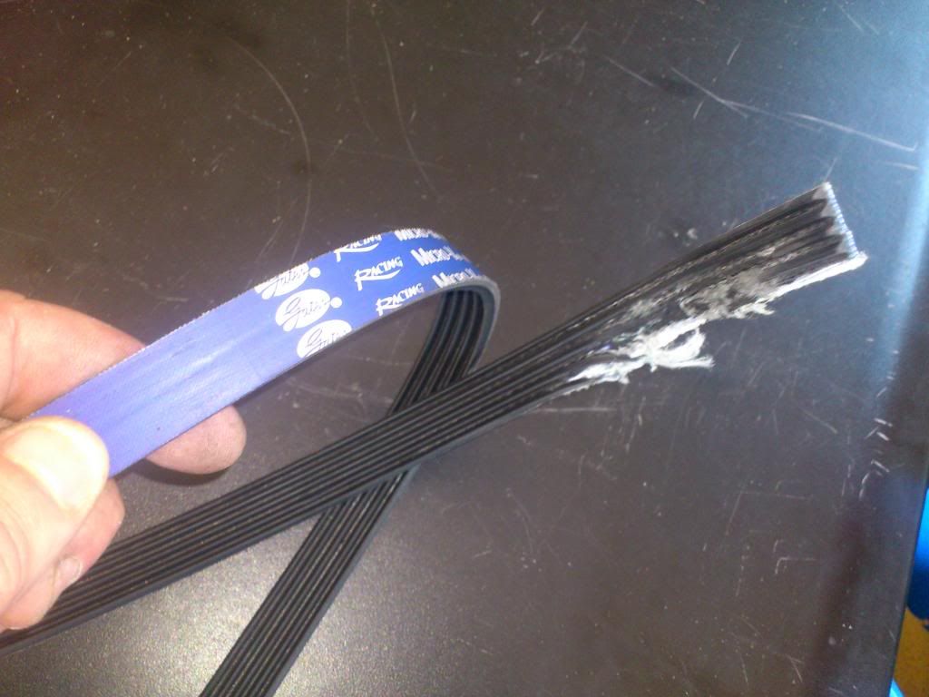

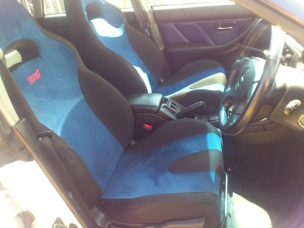

Picked up some 06 STi seats. Had to muck around a bit to get the drivers seat to sit true but all good now. I thought they might not go with the darker B4 blue interior but they actually go together quite nice so the B4 bits are here to stay.
While we are on the subject of blue, my Gates belt decided it was time to shit itself. Luckily I had a spare in good condition.
I love having heaps of spares  :D
#266 Liberty
Posted 14 September 2013 - 12:26 PM
Looking good man. Told ya the seats would work out.

Haha sti seats go well with anything. Looking good chief.
#268 Guest_KONG_*
Posted 14 September 2013 - 01:52 PM
Hahahaa true. Cheers mate.
Yes you did mate and you were right. Cheers.

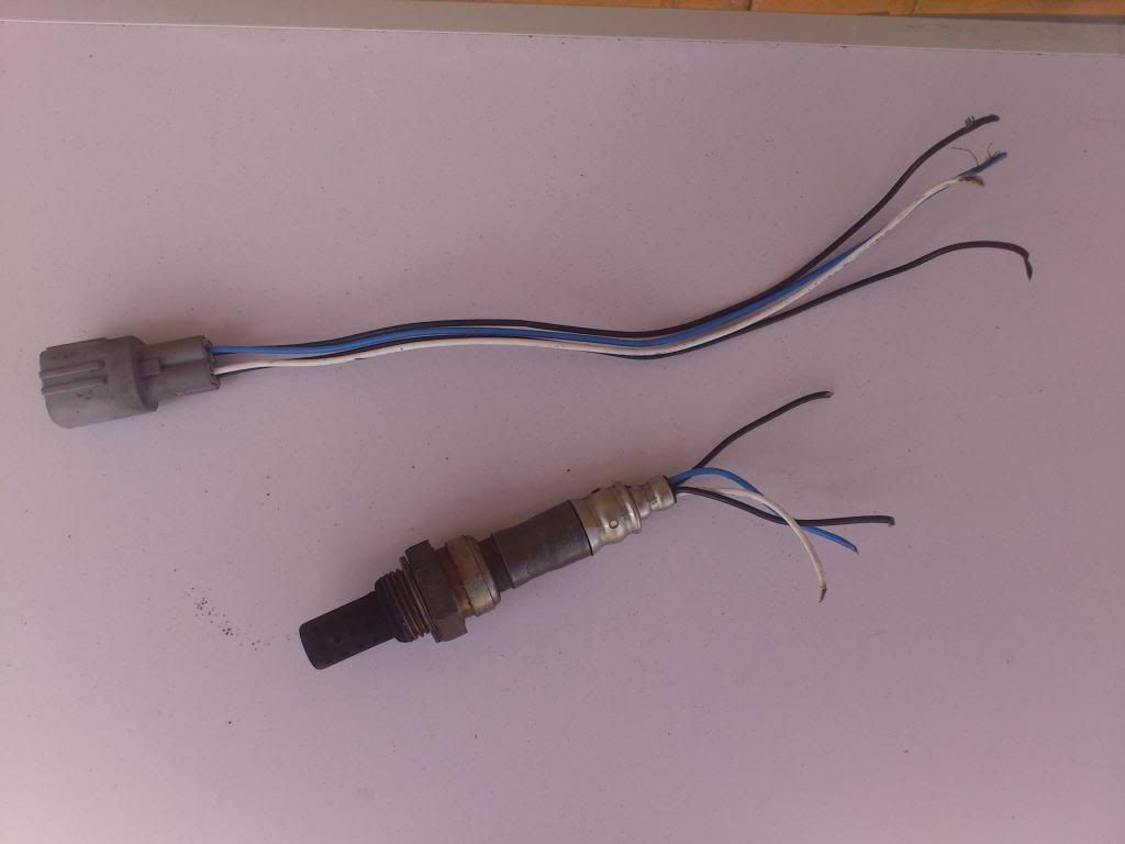

Had check engine light come up recently. Rear O2 sensor was the culprit.  This is what I found....
#274 simon
Posted 21 September 2013 - 12:26 PM
Umm...... yep that will do it.
#275 Guest_KONG_*
Posted 21 September 2013 - 12:31 PM
The old "wire caught in the tailshaft" trick.
I've put a spare in. Not sure if it's any good though. Will reset the ECU and see how it goes. If that doesn't work I guess I'll be trying to reconnect the wires.
Only problem is, not sure which black wire goes to which or if it even matters seeing they both would be earths. Will find out soon enough.

One is the signal and the other is the heater circuit for the sensor.
It's pretty straight forward which wire is which, Look at how they come out of the sensor. Make sure you strip back and crimp with terminals, Solder is no good for 02 sensors.
I dare say you would have stuffed the sensor if it's been pulled at from the sensor end of it but :(
I whacked in my old sensor and reset the Ecu.  The light went off for about 5 secs then came back on. The old sensor is most likely bad anyway.
Thanks for the advice. Will crimp.
