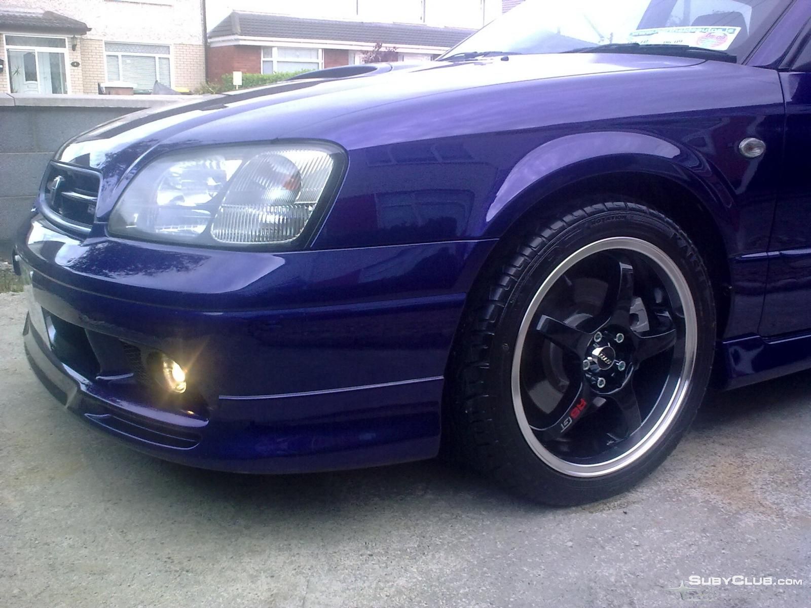

I painted mine with some high temp silver caliper paint to match my calipers, came up a treat, all i have to do now is give then a blast with the pressure washer when i am washing my car and they come up all nice and clean again.
You can kind of see them here.
http://www.subyclub....6_60_263958.jpg

Well that looks better!! Were they as rusty looking as mine before you painted them? What did you use to clean them prior to painting? Did you just mask-off the disc and paint them while on the car?

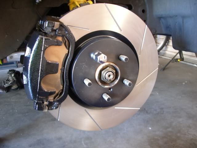

I always paint my calipers with Killrust enamel paint and use a small brush to apply it. A little time consuming, but the finish is worth it and the paint goes rock hard after a bit of heat is put into the calipers and it lasts forever. I just use caliper and rotor spray on the rotors and remove them and mask out the braking surface then spray.

Mine were not as rusty but i rubbed them back well with some fine wet and dry sandpaper gave them a good clean and painted them on the car with a brush, takes longer than spray but the finish is much better as Cruisn said. Once the caliper paint drys the finish is very tough and easy to keep clean. Take your time with the prep work as the better you do this the better the finish will be..

Did you use primer on the calipers and/or rotors?

I've done the same as Mark.
No priming. If you use high temp. caliper paint, it's self priming.
Follow the instructions on the can in terms of prep (wire brush to loosen excess crap) A couple of coats and she'll be apples.

As Alex said no primer needed, just a few coats of the paint. I did 3 on mine, both calipers and hubs.

But what's this Killrust Enamel? Is that a self primer too?

Still curious about the Killrust Enamel - doesn't anything enamel require priming? Unless the Killrust label is in a league of its own...???

From Cruisn's pic it looks a little like stuff we have over here called Hammerite, if its the same type of paint it does'nt need a primer. You just need to make sure the surface is clean and free of loose surface rust and crap.
