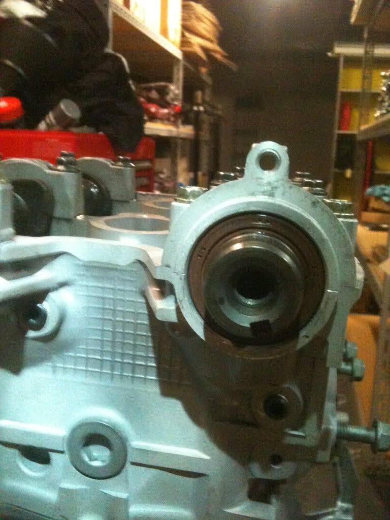

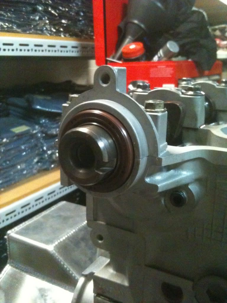

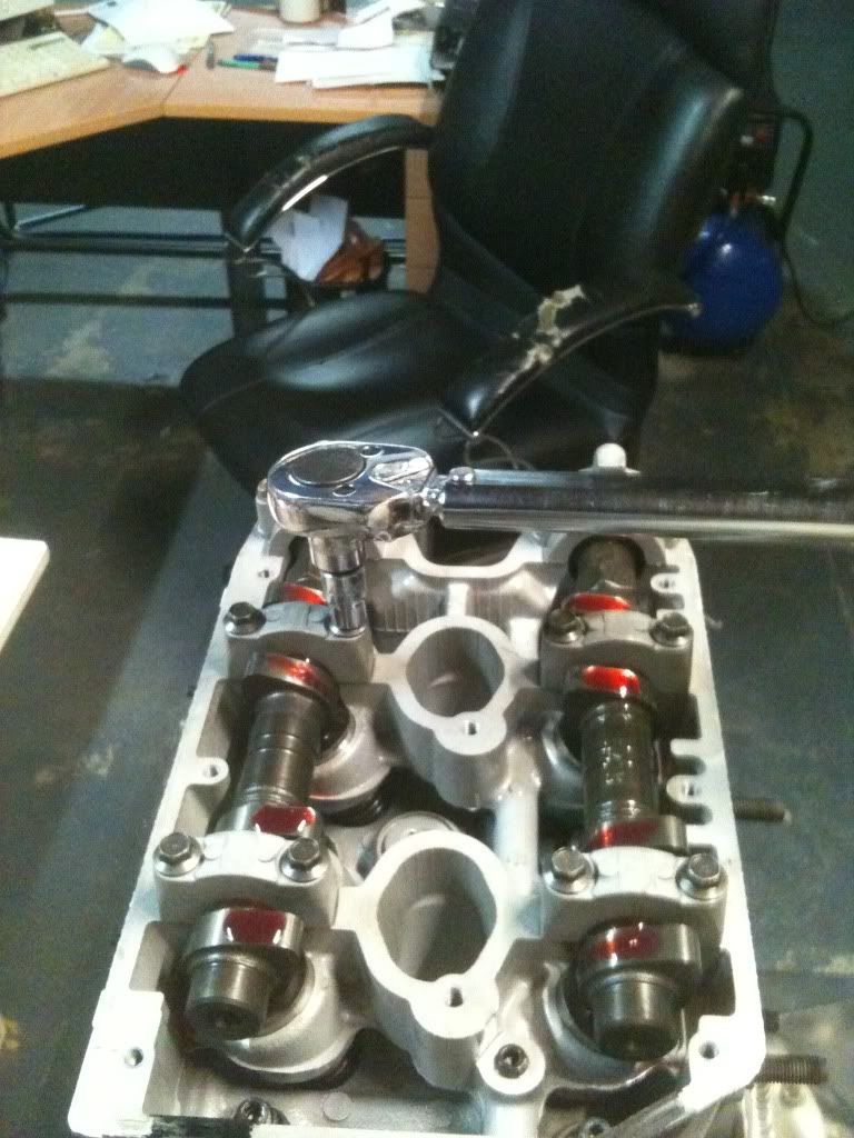

Well I've been slack documenting everything as usual.
I didn't want to stuff around while I was torquing down the heads so I've completed that and am now getting close to an assembled engine.
Threw the cams in with some red goop.
Lubed up the cam seals.
Popped them in.
Had a couplesmall issues that I'll elaborate on later. Nothing a helicoil kit couldn't fix.

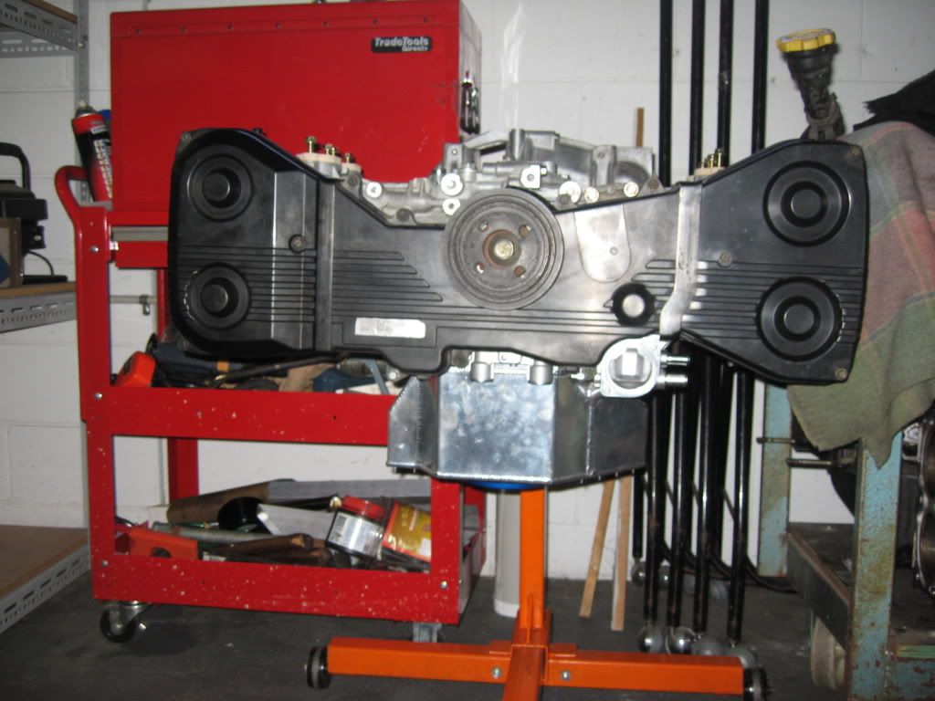

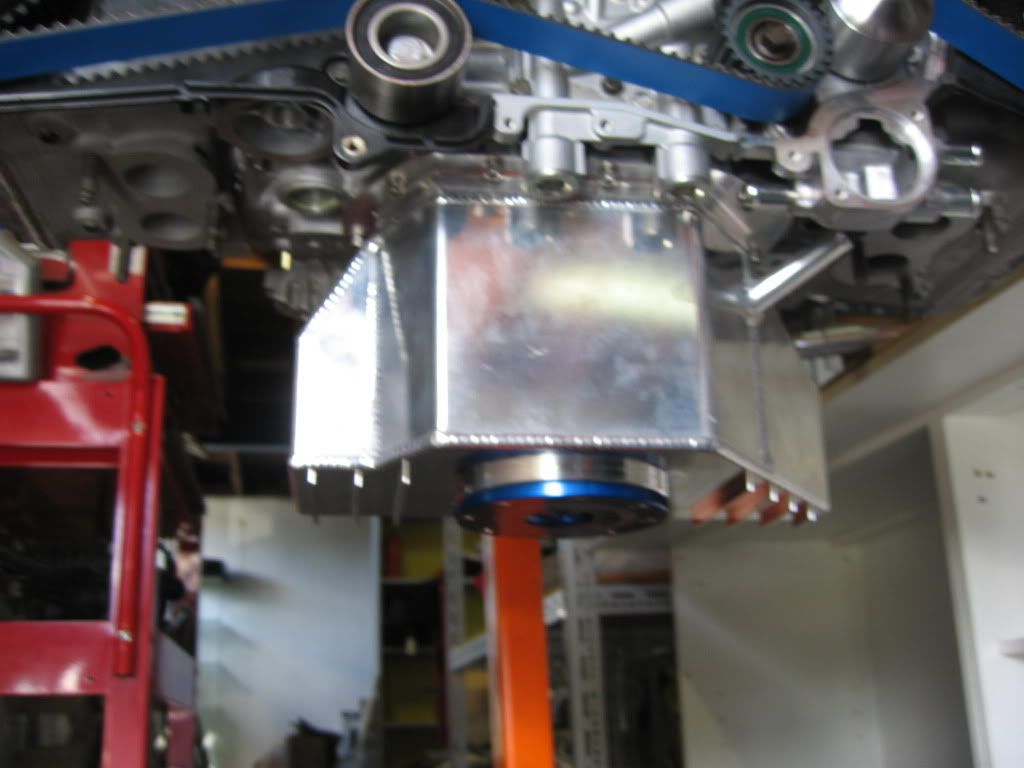

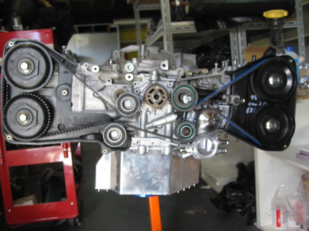

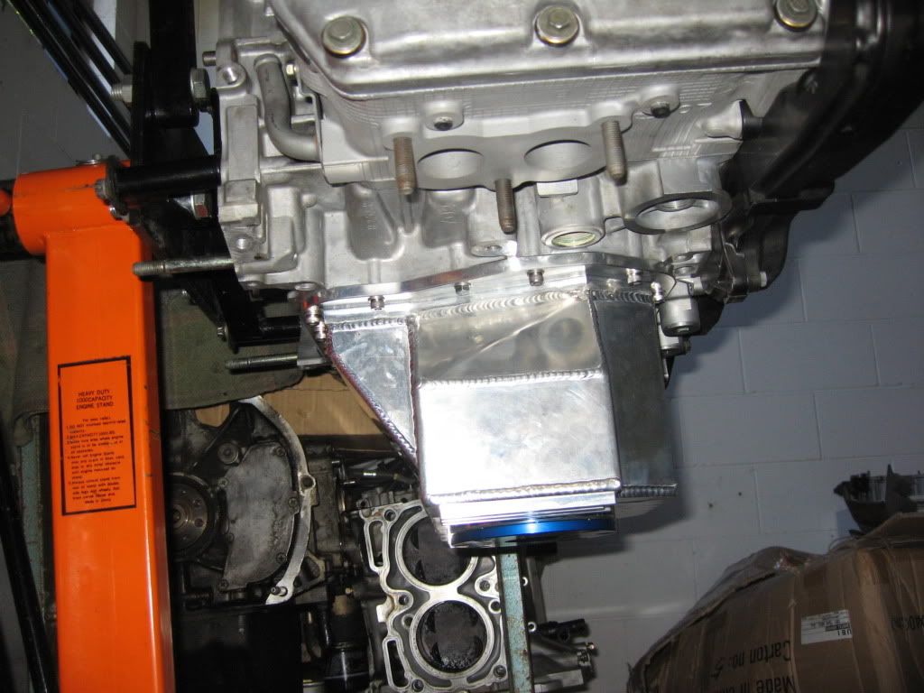

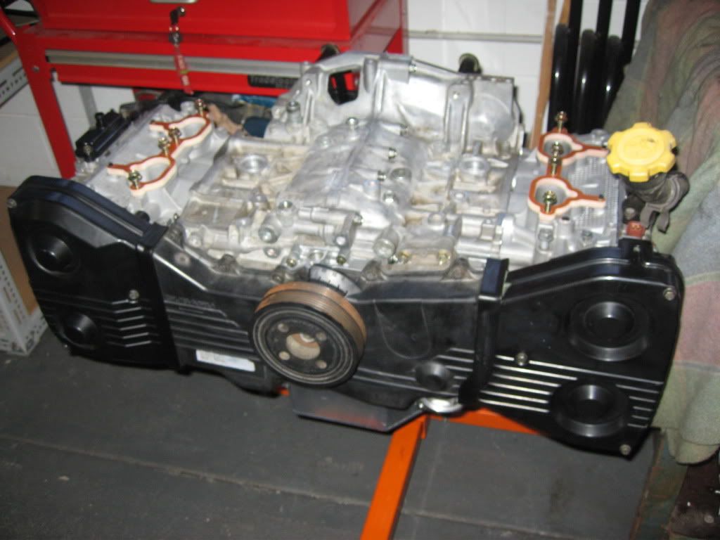

Well the guts are finished now.
Just have to add all the externals.
Sump pics
Finished
Phenloic spacers
Couple other engines in the background. More little projects comming up.

Posted 11 April 2011 - 04:57 PM
That sump is the ugliest thing I've ever seen.
As if you'd buy one!
#73 acres
acres
  • 572 posts
  • Location:Gold Coast
Posted 11 April 2011 - 05:29 PM
Such an awesome tool. My kit has saved me a few times.
That sump looks huge. What volume does it hold?
#74 fatcat67
fatcat67
  • 1,206 posts
  • Location:Brizzy
Posted 11 April 2011 - 08:48 PM
Yea, i had a little trouble with the 6mm bolts stripping the thread out of the block. 1 cam cap and 1 waterpump. Really saved my bacon. $46.00 for 2 repairs is cheap and I have 8 left in the kit.
The sump has a capacity of 6 litres.
Alex,
"That sump is the ugliest thing I've ever seen.
As if you'd buy one! "
Ha, your right, I should have gone black. :drinks:

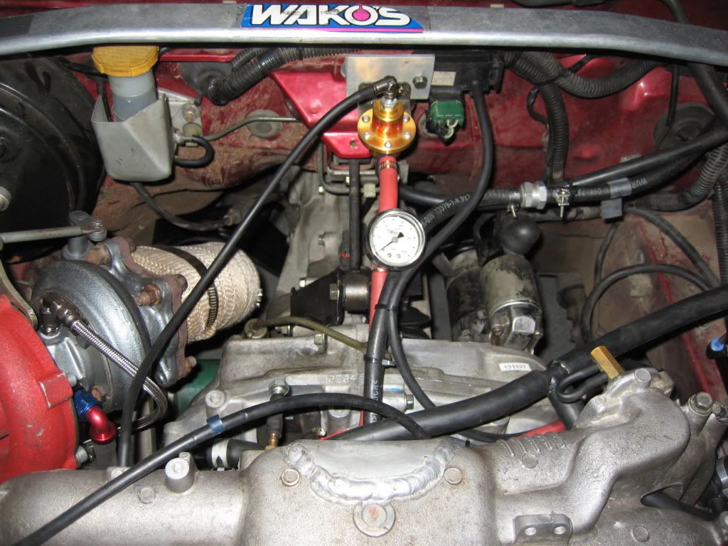

Hey Reece
Motor has run breifly and sounds alright, but I hope it stays together.
Tune is booked in for the 31st May. Tuesday week. Run in tune.
I haven't got any boost control for now, just wastegate pressure for run in.
I can't do much while my brother's bag of crap EVO9 is in the way.
Here are some snaps of the engine bay.
Plated rear diff is in.
Straight cut box with plated front diff is in.
Only problem is how do I do the run in milage with a deregistered car with a roll cage.
More looking forward to Morgan Park and Lakeside than QR but anywhere will be fun.

#77 Shaz
Posted 21 May 2011 - 03:32 PM
Looking good man.
One question, what's the purpose of the phenloic spacers?
I've not seen them before.
Shazza
#78 Richo
Posted 21 May 2011 - 03:36 PM
Stops heat transferring to the intake plenum. It can also be used to raise the plenum for clearance
