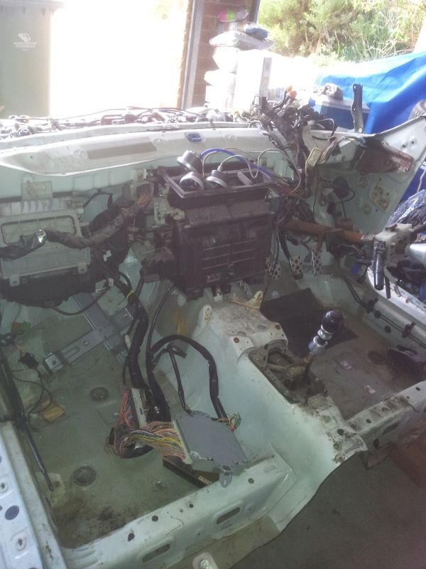

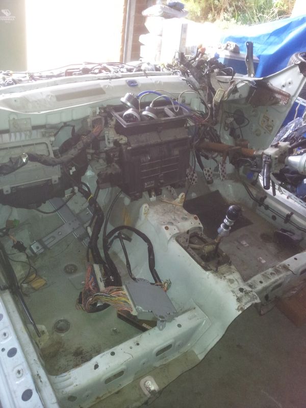

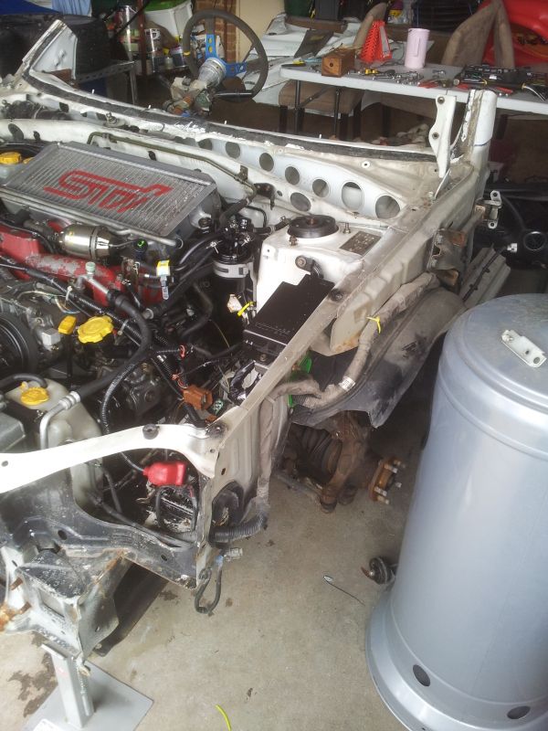

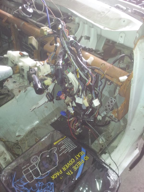

Got a fair bit done over the weekend..
Went about pretty much unpluging every wire i could see that seemed to be attached to the loom as well as removing compontents that where in the way of the cables.
First went about removing the sides
Then went about removing the intercooler.
After that got right into removing most the frame around the dash as it looked like it would be easier with it out the way..
Turned out being a bitch of a job as i missed a bottom bolt and hadnt realised untill id ripped it off using force lol..

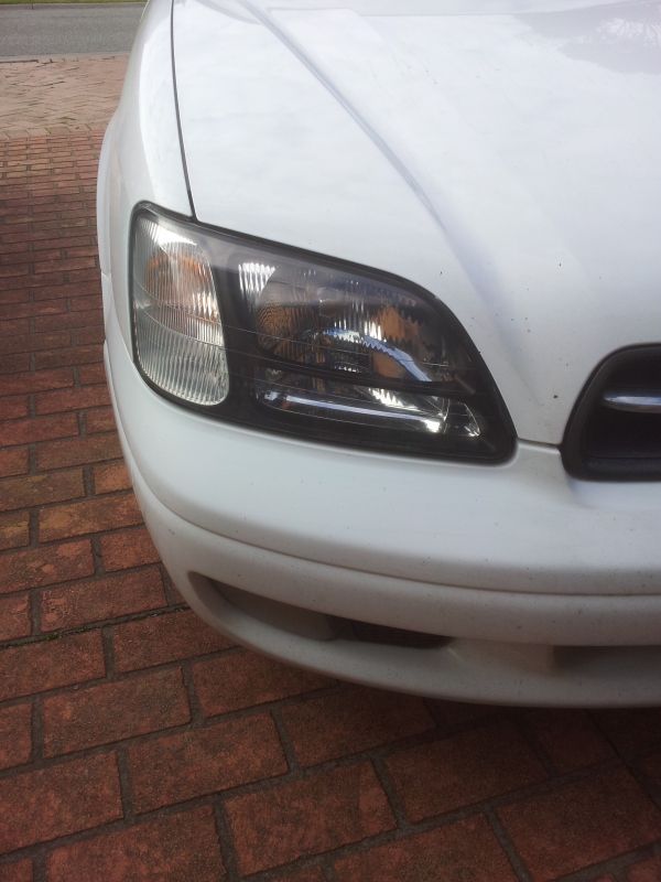

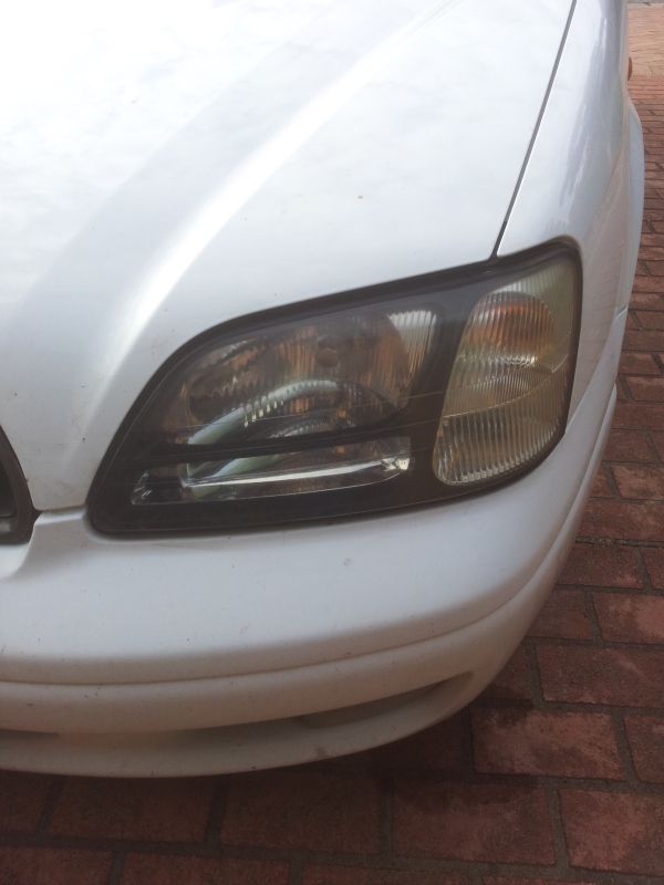

After all this was done i then moved onto a few jobs iv wanted to do on the car that iv been putting off..

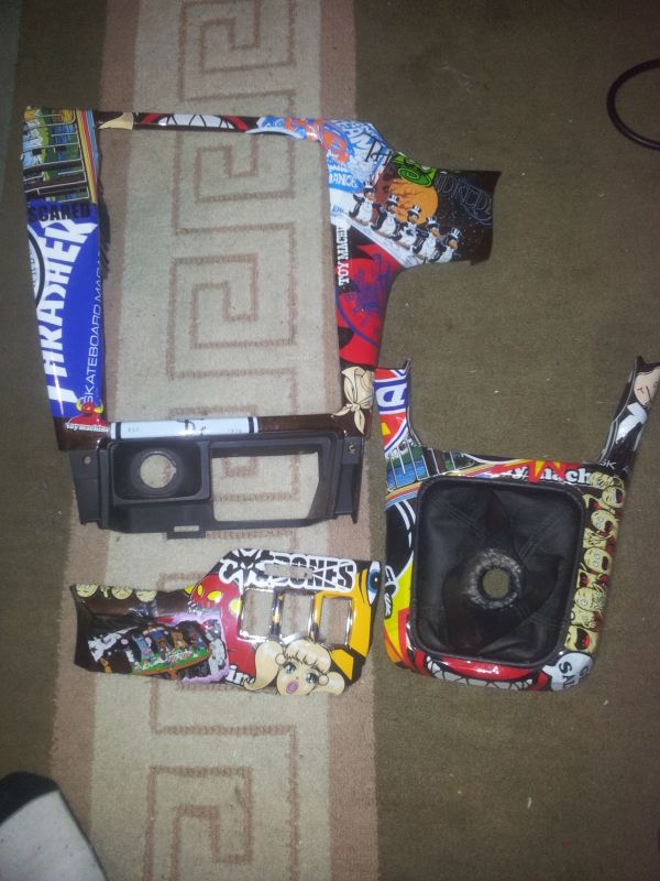

First was to restore the what where horrible front lights.
Before
After

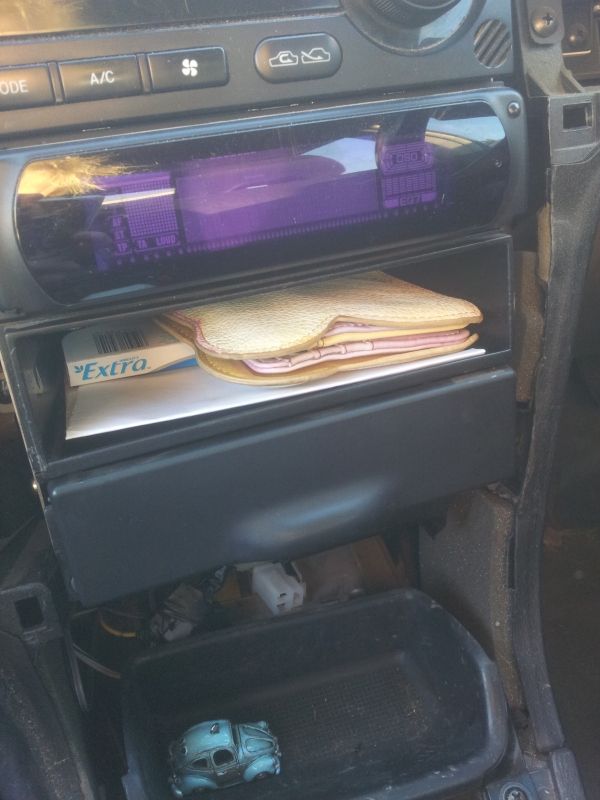

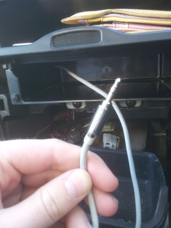

Then i moved the storage dim with the door to the bottor rung of rack and drilled a small hole in the upper rear side for a Aux input cable.
Really happy with it in there as you can close the door when not in use and also big enough to hold a 7ft cable that reaches the rear seats comfortably..

Posted 21 May 2012 - 09:15 AM
You really have to remove that massive brace anyway. I don't know if would even be possible to get at all of the interior loom with it in place.

Posted 21 May 2012 - 01:10 PM

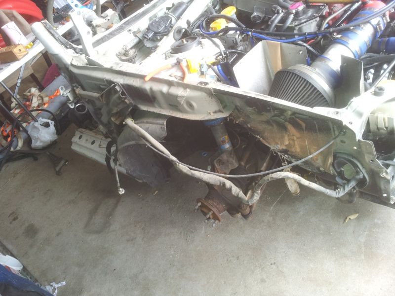

Iv been looking where the loom goes and it seems to go under the radiator.. Im assuming i need to take that out next, Any tricks to letting the coolant out ? I pulled the top hose only to have it poor on the floor.. SO its obvously full lol..
Also how do you go about removing the grommits from the firewall ? Can i just get into them with a stanley knife ?
Oh and one more thing.. Im thinking i will need to take out all the vents/aircon area to get to the cabin side of the gromits ?
Cheers Vice.
#250 Adam
Posted 21 May 2012 - 01:27 PM
There is usually a tap/plug on the underside of the radiator for drainage
#251 Xon
Xon
  • 1,535 posts
Posted 21 May 2012 - 01:34 PM
Posted Image the plug, just pull the bottom hose off.
Don't be lying under it when you do this.
#252 Shaz
Posted 21 May 2012 - 02:14 PM
Cheers Vice.
Radiator: Undo bottom hose, and let the coolant pour out. Make sure you have a tray underneath.
Grommets: Use a flat bladed screwdriver to get under one side, then run the screwdriver around the hole, and the grommet should pop out. You can cut it if you wanna remove the loom from the grommet.
Passenger Grommets: You will have to take the heater core out, and all the surrounding plastics to make it easier to pull the loom through regardless, so you might as well do it.
Shazza

Did a little more sticker bombing last night..Still need more but heres a update..
