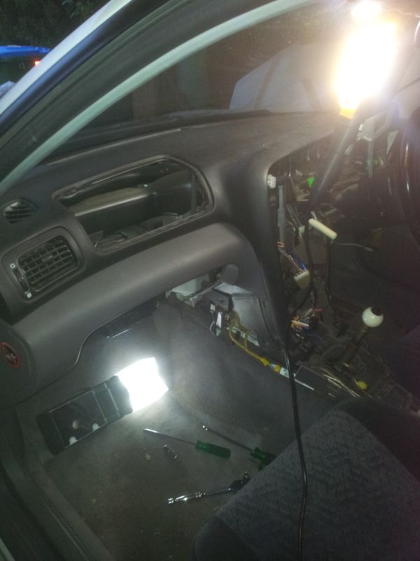

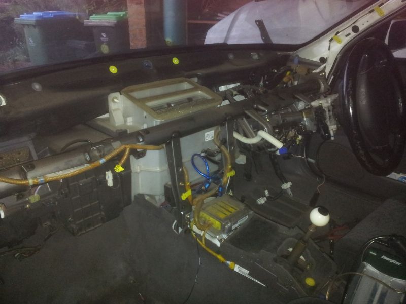

Posted 13 July 2012 - 08:05 AM
Morning guys
Got the air bag out after strugling for 30 minutes with the impossible yellow and green clip !! and pretty much every visible bolt holding the dash in but still cant seem to get the bastard out.. It seems to be held from the top/front as in up under the windscreen..
Any ideas welcome..
Cheers
#328 Shaz
Posted 13 July 2012 - 10:32 AM
I'm fairly certain from memory that you will need to unbolt the dash from the big metal reo bar under the dash mate. That might be the bolts that you're missing.
I removed the whole support bar completely, and then it all just lifted out.
Shazza
#329 vicelore
vicelore
  • 1,579 posts
  • Location:Somerville Vic
Posted 16 July 2012 - 08:15 AM
Got it out.. Just had a few cables holding it in.. Plus the plastic covers around the steering colum.. Really going to start putting some more effort the project as iv got some spare time coming up over the next two months.. And i was given a big gas heater so thats awesome and preventing ball freeze..

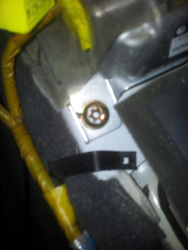

How do i get these bolts out guys ?? Whats the tool called ??
#331 Jovi
Jovi
    When one set of Twins is Just not enough.
  • 453 posts
  • Location:Penrith (Western Sydney)
  • Interests:When one set of Twins is Just not enough.
Posted 16 July 2012 - 07:03 PM
Torx bits you need for that....and you really should have dropped the steering column it would have been easier to pull the dash out....
*When you buy the torx bits get the ones with the hole in them you can get the cheap ones at bunnings or any tool shop they come looking as a set like allen keys...or you can spend some $$$ and get them ready for a 3/8 drive socket...

from my experience those torx bits on the airbag computer are Posted Image'ing tight, i'd get a socket (3/8 or 1/2)
MY07 GT spec B
#333 Jovi
Jovi
  • 453 posts
Posted 16 July 2012 - 07:10 PM
Heck yeah tight as...if you get them on a 3/8 drive ADD a bit of pipe for extension to undo them, Don't slip as that metal bar that holds the dash edges are sharp....
