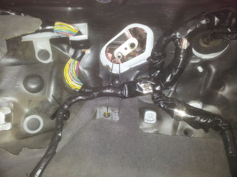

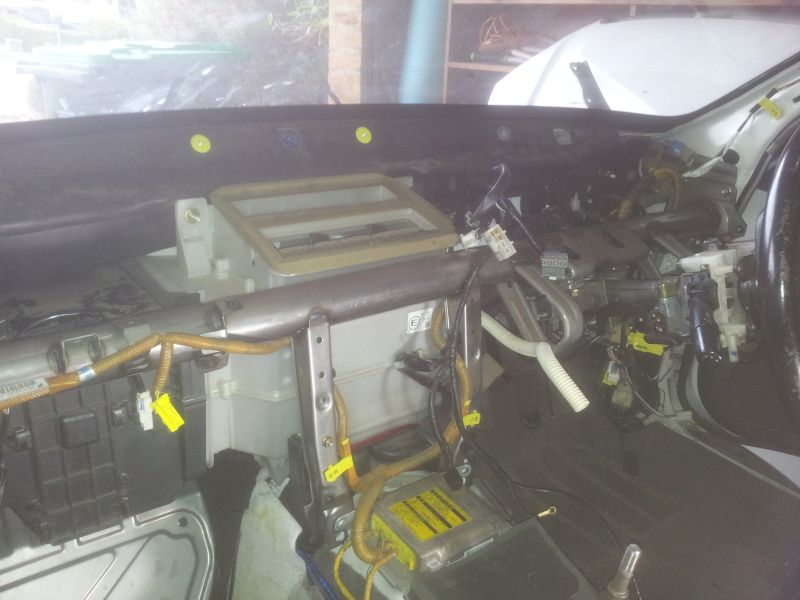

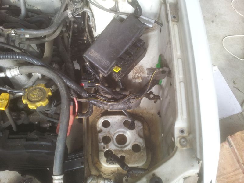

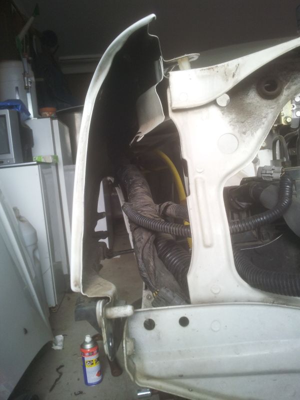

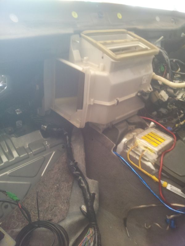

Posted 07 September 2012 - 07:47 AM

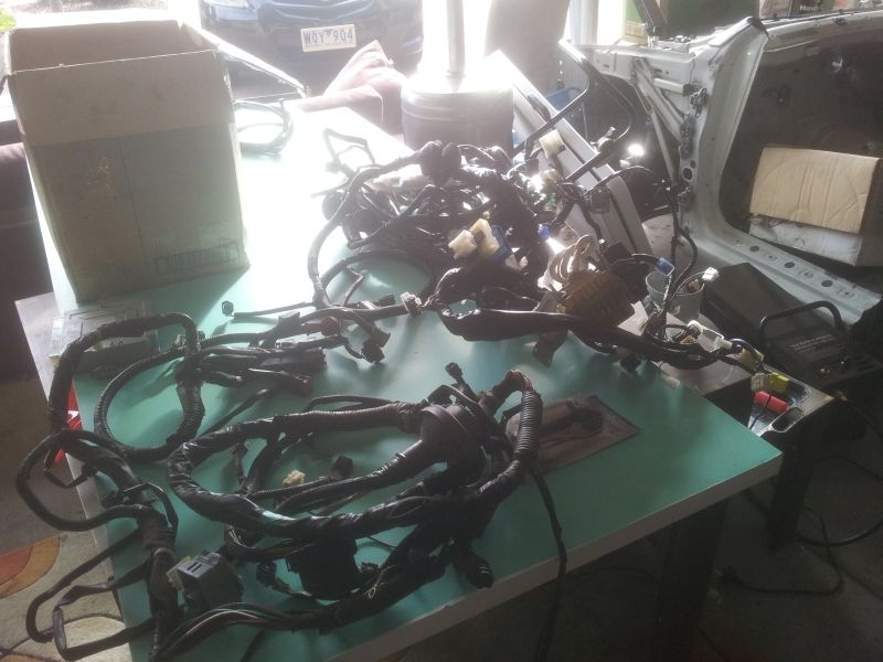

Got heaps done this week.. after getting the loom back i havent been able to stop working on the car.
first up un boxing of the new loom..

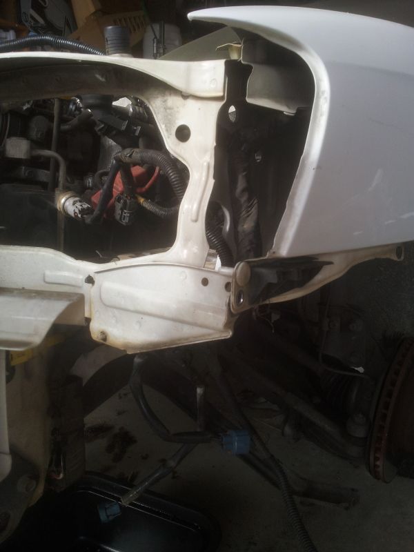

Then i went about putting in the 2 side looms down the fenders and under the front bumper.
IF you see anything looking incorrect id appreciate the tip off..

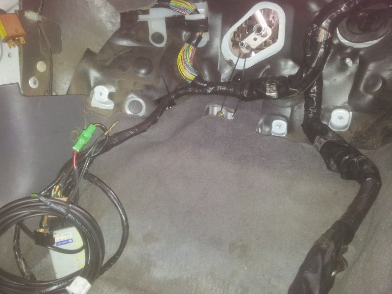

Then i went about puttin in the main cabin loom..
Started with the white plastic clip in the center then worked out from there..
And then went about putting all the wires for the engine bay and their bungs in next.
Then went in the heater box after cleaning up its pipe connections on the engine side as they where corroded as Posted Image..

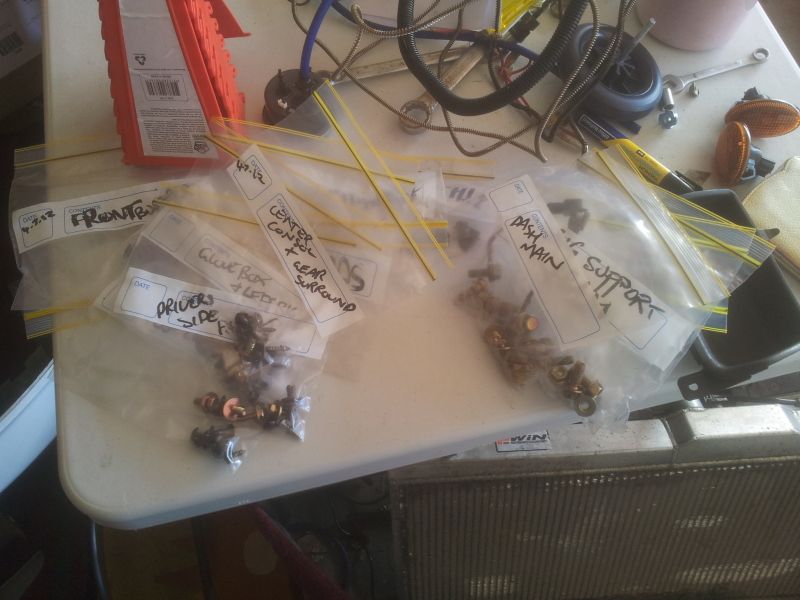

The Air con unit went in after that.. twice.. As i forgot to put me subbie power wire through the bung before hand !!! Posted Image
You will see my useage of labled bags in the pulling apart phase has paid off here..

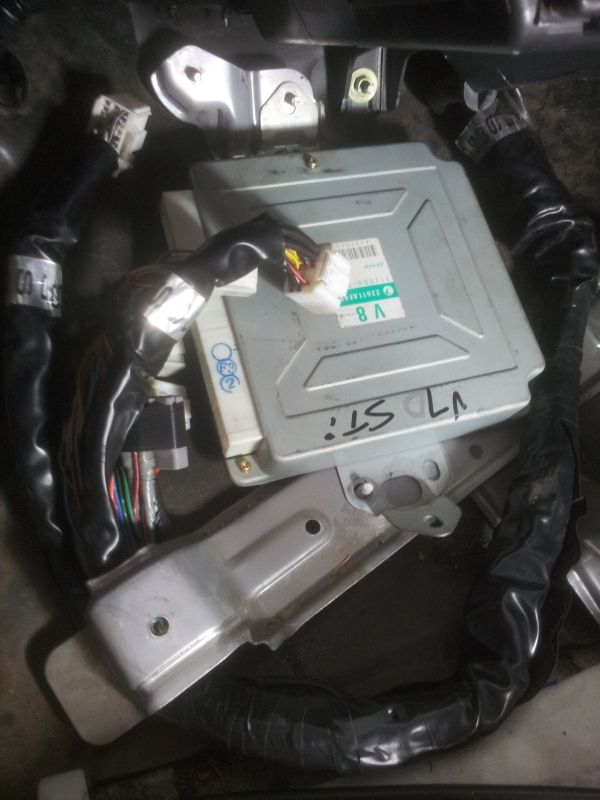

I then went about making sence of the fuse box/plug section on the DHS. Got allot of the plugs in their place which is suprising since i forgot to take any photos of the layout for some reason.. ( to many beers say..)

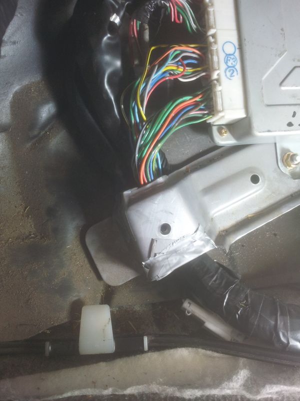

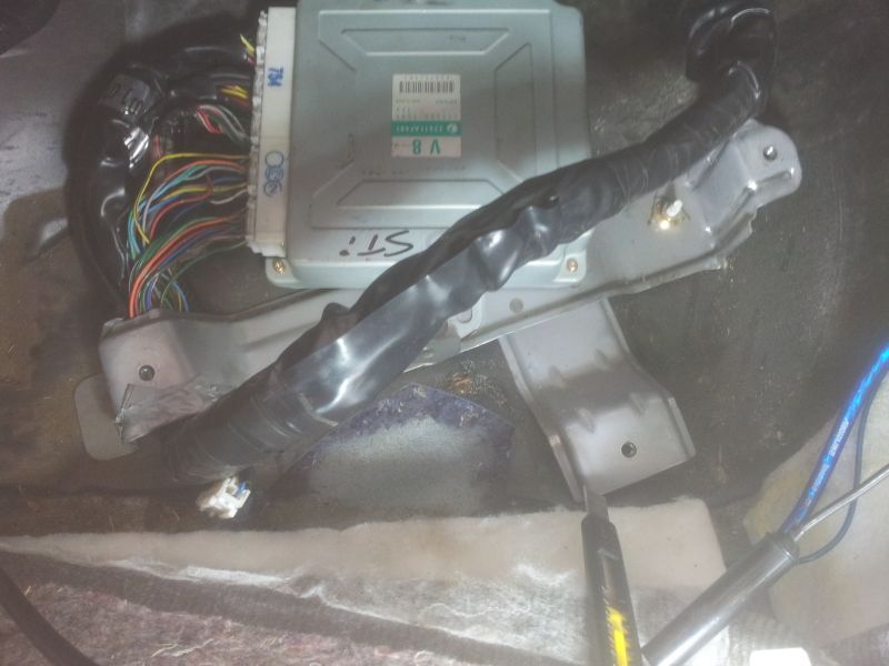

Last thing i got done was wiring in the ECU, I had to cut a little of the carpet away to make room for the larger loom wire so it fits under the cover.
Put a bit of tape around the sharp edges to save the wire`s..
Ill keep the posts coming as its starting to move again now.
Cheers Vice

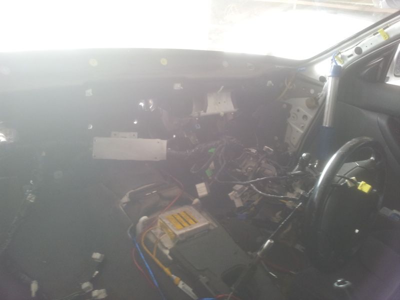

Posted 11 September 2012 - 07:14 AM
Morning boys.
Well got another lot of stuff done yesterday.. Got around 90% of the loom plugged back in so thaught it was time to put the big support beam back in.. All went smoothly except crushing my thumb in the process..
After that was in i went about connecting the steering column so i could see any missing plugs.. I still have a few wires that arnt plugged in but i think most of them are for plugs in the dash.
I also mounted the DCCD computer that i had to remove from the STI half cut.. Lucky the liberty had the exact same mounting holes for it next to the steering colum so it screwed straight on.

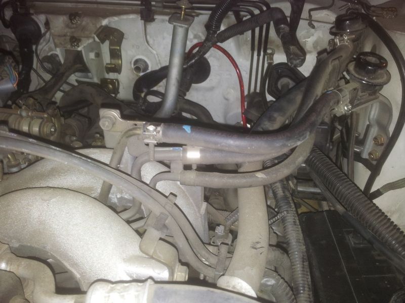

Also.. Iv removed all pretty much everything from the engine that i can see. But I have 4 hoses i wasn't keen to unplug as i wasn't sure what was in them and if it was going to piss all over me. Iv got some shots of them below. If you could let me know how to disconnect that would be great..
Im assuming one is for the clutch plate and is hydrolic fluid.. The other three I have NFI..
Thanks again guys.

1st is clutch, other 3 are fuel.

Oh ok.. Sweet. How do i go about unpluging them.. Im assuming i can just clamp the fuel ones ? how about the clutch one ? do i need to drain the hydraulic fluid ? Is this done down near the pump ?

Edit.. Done a bit of reading ( after i found out what the clutch master cylinder was called) and it seems i can just undo the 14ml bolt on the top and lift the hose up.. They said a little fluid will come out but not much. And im assuming i can just re attach on the 6 speed box in reverse..
As for the fuel im just going to raise the lines and hope for the best.. may clamp if need be.

The fuel shouldn't really flow out, it may be a little pressurised so just be cautious! Maybe wear some eye protection :)

You won't have to clamp them - no pressure in the system. Maybe wrap tape around the ends to stop shit getting in them.
Clutch master is up the top (where you fill it with brake fluid), slave cylinder is down the bottom bolted to the bell housing.
Just undo the bolts holding it to the bell housing and move it out of the way.

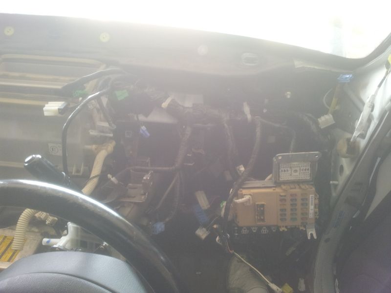

I got up a couple of hours early for work and did a bit more work, got the dash back in temp this morning to see what plugs i still had left and unfortunatly have around 6ish that i dont know where they go.. Iv taken a few of the ones on the passenger side if you guys have any idea.

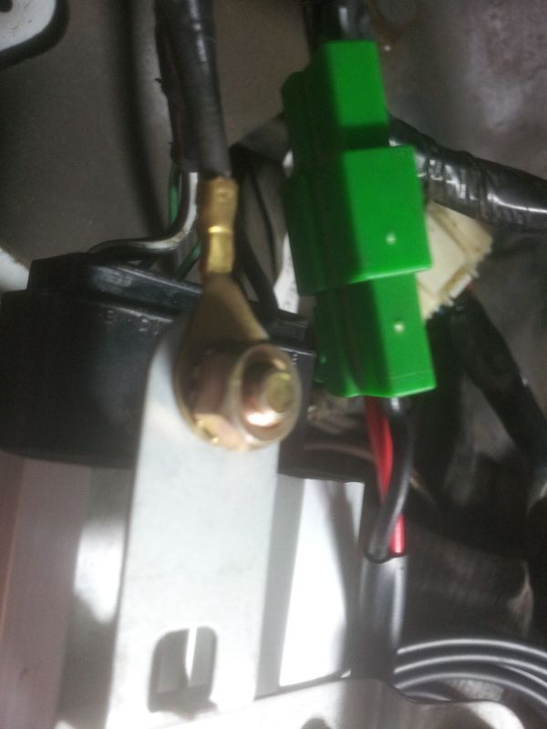

I also had a earth coming from the fuel control unit that i didnt know where to screw.. Screwed it to the back of unit.. Do you think that will be ok ?

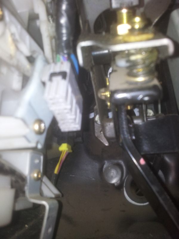

Posted 14 September 2012 - 08:17 AM
Thanks for the tips guys.
I went about removing the coilovers/sway bar and control arms from the cut last night but then got stuck on a stripped nut, Going to tackle getting the rest of it off over the weekend then lower the engine/box out the cut..

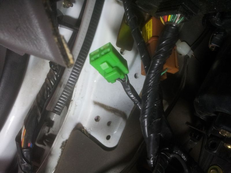

Im assuming i just need to undo the above then unbolt the engine and box X member and it should drop down ? Do you leave the lower control arms connected ?

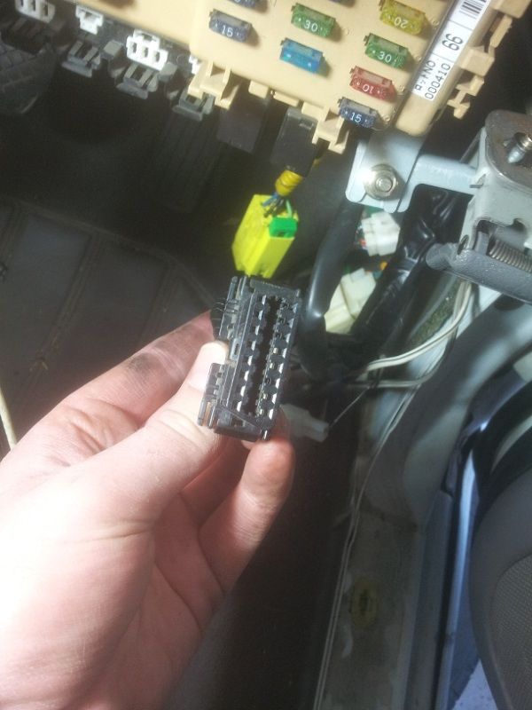

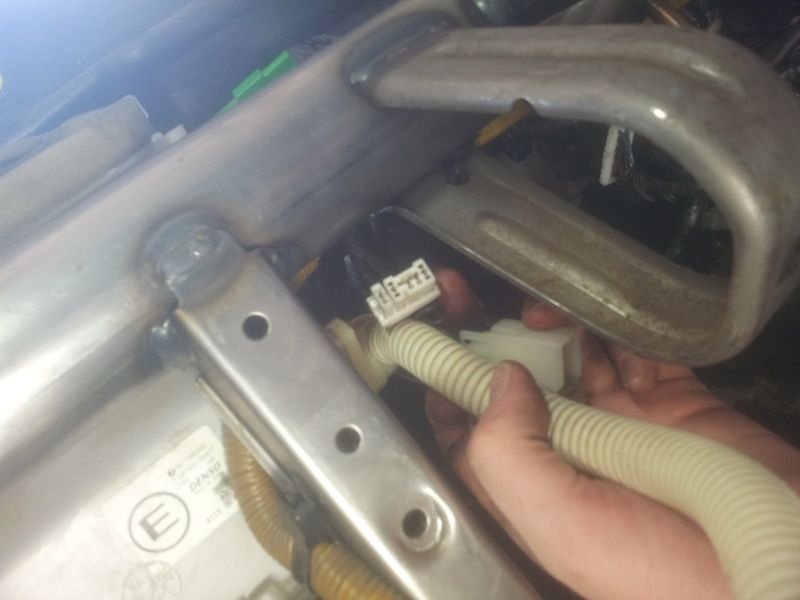

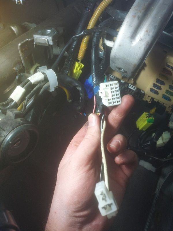

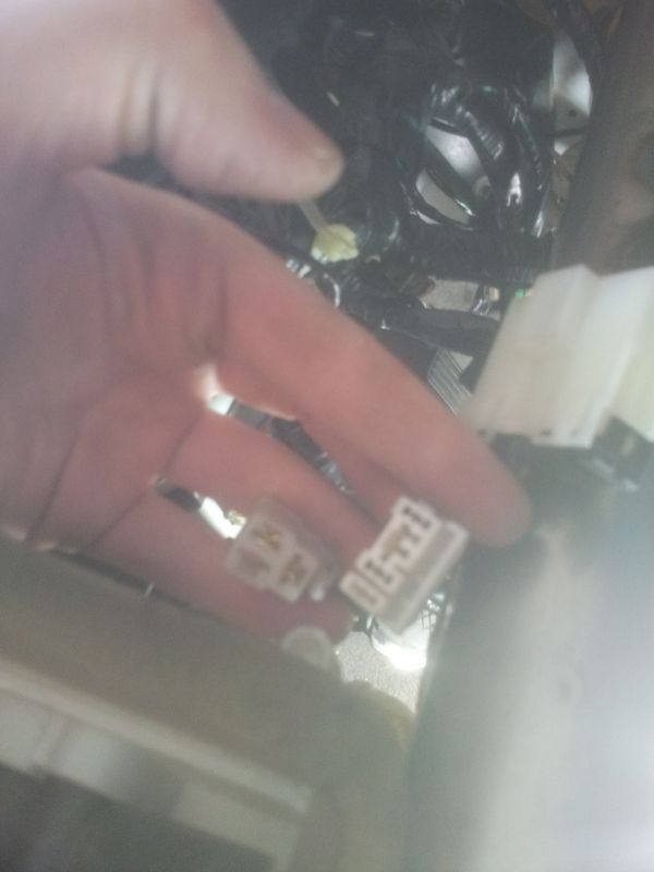

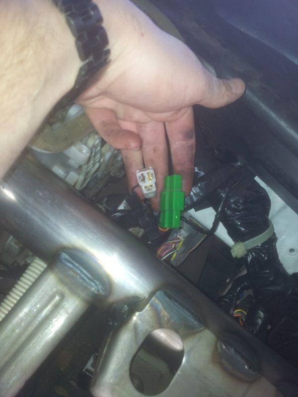

Also just stuck on 5 connectors in the cabin now that i cannot find where they go.. Any ideas appreciated.
Cheers
#380 Morgan
Posted 14 September 2012 - 08:44 AM
Last one looks like the OBDII port.
Those green ones are for accessing the ECU so you can unplug those otherwise you'll get a flashing CEL.
Not sure about the others
