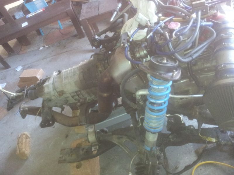

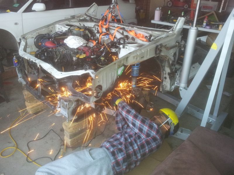

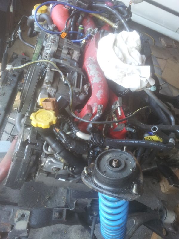

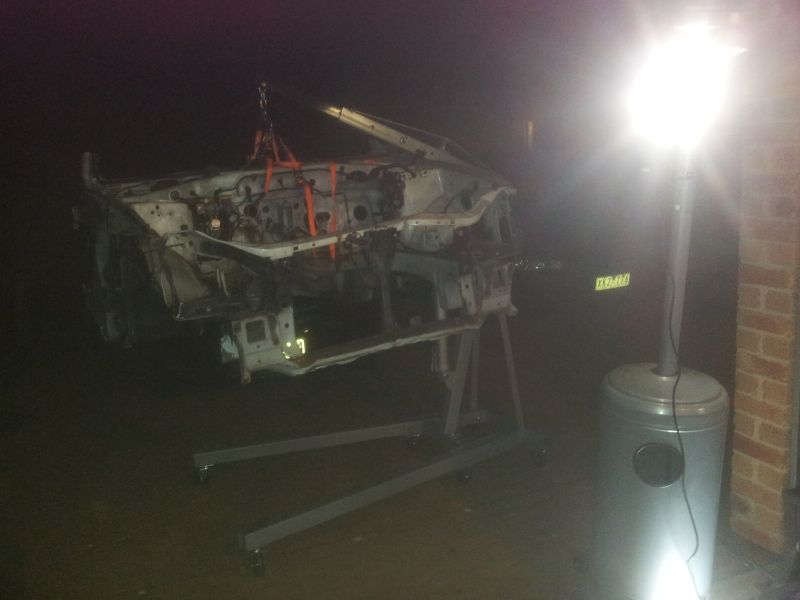

So got a bit done over the weekend..
Went about finishing off all the wiring in the cabin and all is in and well.. Have left some of the interior panels in as i want to test first but apart from that its ready to drive...
After that i went about freeing the engine and G box from the cut..
This seemed pretty easy after i had laid under the car for half a hour and planned how i was going to seperate the sub frame from the body..
Anyways there is only around 12 bolts holding it together, ANd after purchasing a breaker bar all but 6 bolts remained. The 6 bolts that where kiling me where 4 for the engine cross member and 2 for the g box cross member.. After multiple attempts from 3 diferent guys the bolts where destroyed and it was time for a trip to masters to pick up a new grinder and 3 discs and some cutting to start..
Having never used a grinder before it was a bit of a learning time for me.. Espually since i started in a t shirt with shorts.. Learnt that lesson there straight off the bat..
End result below :) The guy in the pics is my brother in law btw..

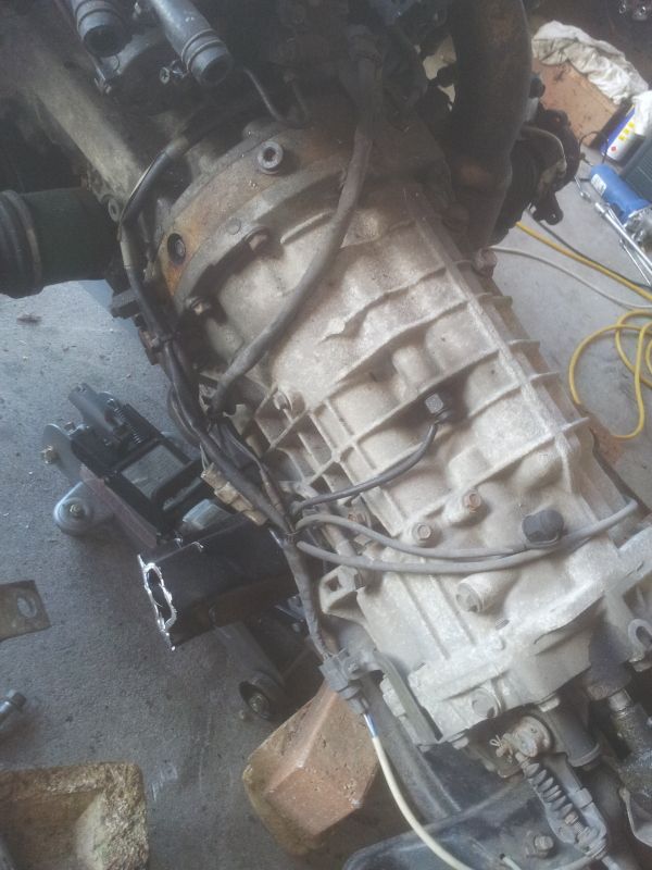

SO this is what im now left with.. Ready for the new cross members to be bolted on and some cleaning / servicing to happen next..
One thing i did notice was that there wasnt any b box oil cooler .. ( was expecting one after being told it was a RA STI..
Cheers guys !!

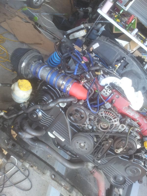

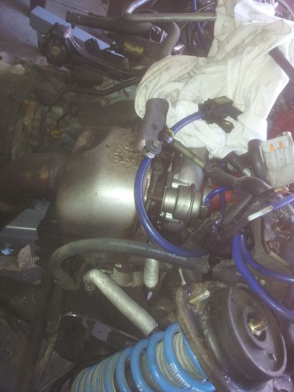

Its coming along!! Man you really took to that gearbox x member lol...got another spare to use in its place?
Is that an aftermarket boost controller? If do are you going back to stock boost control?
And wheres the airflow meter? Im looking but i cant see one on the pieced together intake?

Posted 24 September 2012 - 07:57 AM
LOL yea.. As i said i was learning witht the grinder :)
Hrm.. not really the response i was after there lol.. I was pretty sure i could use the lib gbox cross member ?? I was told i needed a new engine one so i sourced a auto B4 one.. but thought i could use the lib gbox one :(
The engine did have a aftermarket HKS one but i had it removed from the loom as im going to replace with non HKS new one..
Air flow meter.. no idea what that even is..

Id just use stock boost control if you can? Its a lot better and safer ;) just stick a 3 port on it for better spool
I dunno about the gearbox members...you probably can re use yours? But im not certain?
There should be an airflow sensor with a plug connected to it after the air filter and before it goes into the red intake pipe before the turbo? Usually mounted into the aftermarket intake pipe if its there?
Unless its got an aftermarket ecu?
#396 vicelore
vicelore
  • 1,579 posts
  • Location:Somerville Vic
Posted 24 September 2012 - 10:29 AM
Used to have the standard CSU with a HKS system piggy backed on top.. I had it all removed..
Ill have a look around for it.. I may of removed it .. I havent tackled any of the engine wiring yet.. Was going to take that on when the engines in its spot.
Cheers Vice.
#397 aekOne
  • 10,349 posts
Posted 25 September 2012 - 01:59 AM
Have you still got the piggyback ecu mate?
That intake looks like the HKS unit (but modified) with MAF delete for MAP sensor tuned cars.
#398 vicelore
vicelore
  • 1,579 posts
Posted 25 September 2012 - 07:22 AM
I do have the ECU aek.. But wasnt going to use it as i herd no one in VIC could tune it..
Can you let me know what this means in simple terms ?
"That intake looks like the HKS unit (but modified) with MAF delete for MAP sensor tuned cars.'
I take it your talking about all the small blue tubing ? non of that looked standard to me.. Am i going to need to purchase a new intake ?
Maybe i need to google what a map sensor tuned car is ..... Dosent sound good to me..
My plan with the engine was to take things back to as close to stock as possible then mod up from there. As im not sure how good / tuneable all the HKS gear is ( was told not very tunable in VIC)
Thanks again. Vice
