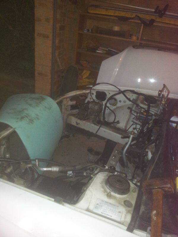

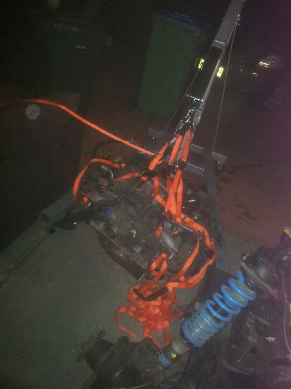

Made a big lot of progress last night.. Had allot of awesome help from codeburn3r.. Great Posted Image'ing bloke and knows his subys :)
Went about removing the engine from the lib..
Started out disconnecting all lines to the engine that i could see.. after that tackled the 4 botls each side of the gearbox.
they all came off ok but as some on the suby club FB page will know.. I didnt know that i had to remove the clutch fork pin.. After looking around for 45 mins i found the pin and removed it.. Turned out it was just a nut on one side of the box and after that you need to remove the oil dip stick and then pull the long bolt from the other side.
after that me and Ty tried to pull the engine but i had forgot to remove the headers.. SO back down it went and they came off..
After that and a little love the engine was out and flying through the air..
Gonna go about removing the 5 speed tonight. Stay tuned !!
