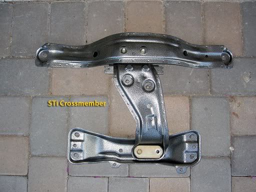

Remember if going 6 speed and R180, that the STi rear hubs wont just bolt up as the Lib is multi link rear end.....to fit the R180 you need to machine your stock Liberty hubs to press in the STi bearing...than modify the rear driveshafts (shorten) to fit...the R180 requires a tiny little bit angle grinded off to fit in the rear diff carrier (banana looking bit)
Front hubs you will need yes, as the CV's are huge in comparison to your current ones...and if going 6 speed, youll also need an auto B4 tail shaft as the STi one wont fit without mods (and i think it rubs on the tunnel as its a lot thicker)
And i think youll need a different (turbo) front subframe??? mine is using a Gen2 GTB one
turbo cross member from half cut would fit won't it?

No, GD has a completely different cross member compared to a Gen3
Either a B4 or a gen2 GT/GTB or i think even the Gen2 RX ones fit......i remember Al had to change mine out (03 Gen3 Liberty)

Posted 18 April 2012 - 11:00 AM
Gen 2 RX got a turbo crossmember for some crazy reason, so if a gen 2 GTB or GC8 one fits, then yes an RX one will fit too.
this. i'm using a rx crossmember with a V7 motor and i assume your doing the same Luke?
Yep. Yanked out the 2.5 and plopped the v7 motor in without touching the crossmember.
