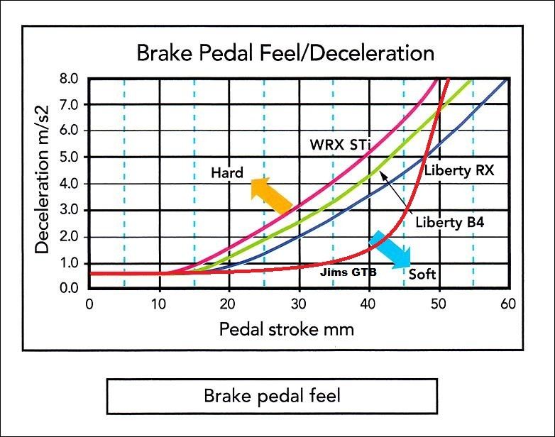

Jim I remember reading somewhere (here?) about the Gen3 brake application and feel. It was designed for exactly the feel you're experiencing. Less race car and more gentleman's wagon, so the brake application is not linear. I've rebuilt all my (stock 2-pot) calipers, new DBA rotors, new QFM pads and I barely noticed a change to the "normal" braking, but an ABS stop will just about knock your teeth out.

#205 duncanm
duncanm
    wha' who ?
  • 2,019 posts
Posted 09 August 2015 - 08:39 PM
You probably remember reading this autospeed article.

#207 cowie165
cowie165
    Garage 改善
  • 599 posts
  • Location:Newcastle, NSW
Posted 09 August 2015 - 09:55 PM
duncan that is some impressive search-fu. Nailed it, and thanks for the pic!
I wonder if difference in braking force is due to different calipers or different MCs? Bang for buck, would it be worth swapping an STI MC onto your BE/BH instead of the calipers?
PS. Graph explains the point, but it's also worth noting the WRX STI has a 20% greater deceleration over the standard B4 system. That's quite a big difference.
#208 Jimbo
Jimbo
    Livin' the Legacy
  • 2,771 posts
  • Location:B'town
Posted 09 August 2015 - 10:05 PM
This is what mine feels like..
When I was chatting to Dave about it (original owner in Japan) he had a Subaru engineer explain something similar to him. He told him that it was a "progressive" feel, so that you can adjust your speed with light application but when you need more braking performance, the bite is still there further in the travel.
It's similar to how mine feels. I think I might have a crack at re-bleeding the system and maybe trying different pads before giving up on the 4pots. The BH/BE Legacy S-Edition was fitted with 4pots up the front as standard but highly doubt they would have changed the M/C size?
In saying all this though, there's a big thread on Nasioc that claimed there wasn't a great deal of difference between the turbo 2 pot's and the 4 pots. Obvious advantage of the 4 pots being a bit lighter and better for heat dispersion. The pad surface area is nearly the same but the 4 pots win out with slightly more braking torque.

#211 CRUISN
Posted 10 August 2015 - 09:51 AM
Factory option was 4 pot fronts. No change in MC. I found 4 pots to feel identical to the 2 pots both running Bendix GCT.

#212 duncanm
duncanm
    wha' who ?
  • 2,019 posts
Posted 10 August 2015 - 12:01 PM
There's a couple of interesting things going on 4 vs 2-pot.
2-pots are 42.8mm piston diameter. 4-pots are 40.4mm (I think).
For initial bite, the pedal movement will be proportional to the pad/rotor distance (run-out) times the total piston area for the 4-pots - but double that area for 2-pots (as we have to move the caliper the same distance). So initial pedal run-out will be slightly more (~12%) for 2-pots because of the bigger pistons.
However, when you look at clamping force, only two pistons count - 4-pot or 2-pot. So the 2-pots will have ~12% more clamping force.
then - what's the rotor diameter difference 2-pot to 4-pot.
There's a nice spreadsheet here which calculates braking torque.
It says 2-pot to STI 4-pot is an 8% drop in braking torque.

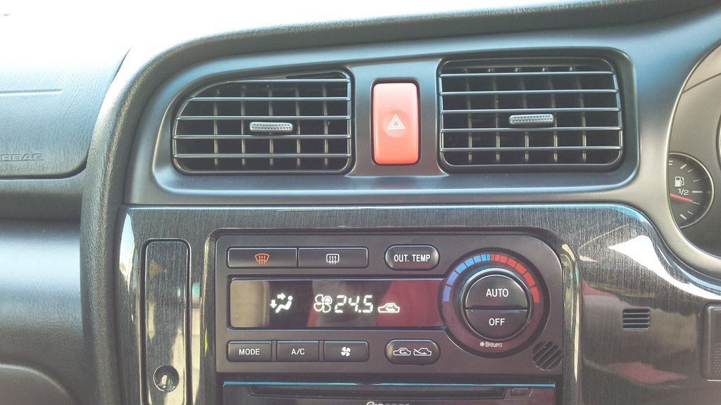

Also just an update on me noble steed.
I fixed the climate control! Turns out, last time I pulled it apart, when I put it back together I shamefully crushed the cabin temp sensor into itself unknowingly. It would have given a dodgy signal and conked it out.
I discovered this while installing the de-greenification screen mod. Looks much better. Still have to fix one LED which has worked itself loose.
While I was up in there, I installed the S401 hazard switch, which looks tits. I had no idea that the hazard switches were illuminated. Pulled apart the OEM one to find, indeed, they are (globe blown long ago).
I might chuck a LED into my old one and see how it looks. If it looks good I'll do a how-to :)

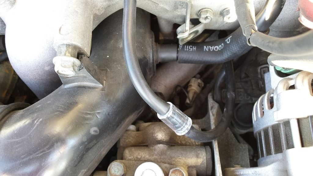

Some will also remember I had a problem with the Purge Control Solenoid fittings snapping off .... fixed it for $2.50. Result? No more vaccum leak and better fuel economy.

#218 CRUISN
Posted 11 August 2015 - 08:08 PM
Looks identical to my centre console with the surround, white AC and S401 hazard. :D

#220 Adictions
Adictions
  • 165 posts
  • Location:narre warren
Posted 11 August 2015 - 08:34 PM
Looks good. got to love fixing a problem so cheaply to.
Never new about the hazard switch lighting up haha, are the cruise and fog light switches supposed to light up aswell. mine dont but i thought i saw 2 light fittings in one before. I hate them at night.
