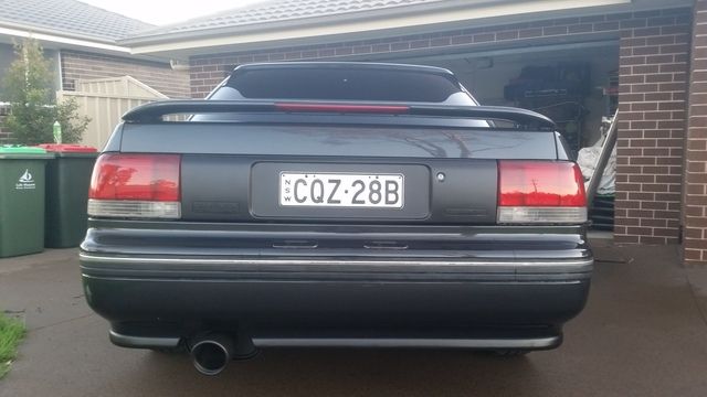

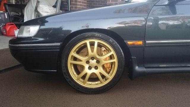

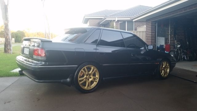

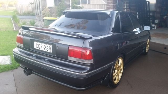

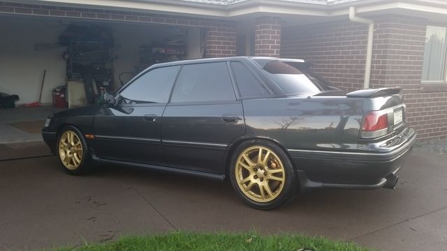

Posted 08 May 2015 - 05:15 PM
Put the spats on today...i wanna redo the fronts as i think i forked up lol
And took the old girl for a drive as i need to put 500km on the clutch before the tune
Put a huge smile on my face...havent gunned it or nothing but its torquey as hell and wants to get up and go!!
And finally gave her a good bath...interiot needs one asap lol...so filthy!!
Few after bath pics...excuse the rusty rotors :D
getting there finally!!
And also getting used to the solid clutch!! Hooray!!! Requires lots of throttle blips and heel toe...but im getting used to it all again after driving autos for 2 years lol

#670 RX25SE
Posted 08 May 2015 - 05:55 PM
Those spats look elegant (not like the abomination that the GenIIIs have) and the black muffler/tip really work well

#671 CRUISN
Posted 08 May 2015 - 05:58 PM
Nice. :D
Black tip was the right decision.

#673 Matt
Matt
  • 4,380 posts
  • Location:Lake Maquarie NSW
Posted 08 May 2015 - 06:01 PM
You have inspired me somewhat, I think I need mudflaps for the RB.
Cheers Jas!
I think so you need some too lol
The early gen3 spats arent too bad ;)
I gotta redo them though as the front arent sitting right :(
Nice. :D
Haha thanks Mark! I fully agree!
Still hate the gold rims on gold brembos?
The brembos are a darker shade of gold :D
#674 Morgan
Posted 08 May 2015 - 10:09 PM
That's not rust on the rotors... You've gone for a third shade of gold, haven't you?!
