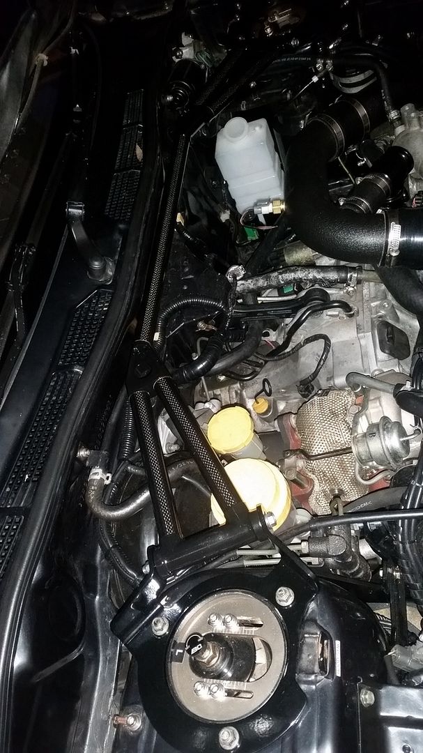

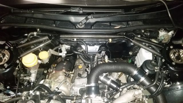

Got sick of looking at the dodgy painted ends on the sti carbon sttut bar so i tore it out and went to town on it
Wire wheeled all the 4 or 5 colour layers of the ends and carefully sanded the paint off the carbon sections as half of it was covered in paint...they obviously had no idea on how to mask areas off lol
Gradually brought the carbon clear coat back up to a good shine using finer and finer sand paper and finished it off with an enamel clear coat...looks tops!
And also sprayed the alloy sections black as they were looking fairly crappy
Came out alright though! Not perfect, but it was a rushed job lol

Looks good! I tried to bring my aluminium bit's back to life but it's way too fiddly! The black suits your engine bay

Is that strut on the right side of the car?
Looks tits.

Yep i played with it and just got over it, wire wheeled it all and painted it lol
And the engine bay is only gonna get blacker....i wanna eventually do the ps pump,a/c and all the brackets and eventually the manifold
And will probably spray the radiator when i swap the coolant out soon aswell ;)
Hell the turbo may even go black if it comes out in the future lol

Strut is correct..but hats are swapped for max caster but with still a touch of camber
Can still be rotated again to only control caster if needed...but not fussed atm, will probably put some plate in the rear of the control arm bush to add more caster
