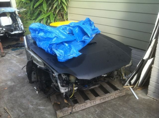

UPDATE TIME
So the car has been sitting idle atm fixing and replacing bits and pieces

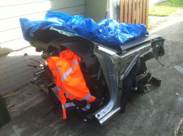

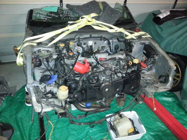

But a few weeks back I was talking to Cam about how i want to eventually run a GD engine and ECU in the RS when one comes up for the right price......and it just so happened he knew of an engine that fit the bill
Enter Cams old wrx, or whats left of it after attacking it with a grinder lol
This engine spun a bearing and was freshly rebuilt with a 207 short block, refreshed heads, bc 272 cams, all new pumps, belts and gaskets and a set of the ever elusive killer b 321 stainless equal length headers
Engine only had approx 10k put on it in a run I tune before the car was written off...so shes a fresh engins that never had to do much at all :)
The cut came with all the loom, ecu and engine ofcourse...minus the gbox and turbo etc as I have no need for them with my new 6 speed and a 15km old vf34 still on the RS
So I paid a deposit and waited for a day when we both were free, and thankfully Mark (scubaroo) was free to lend his trailer, crane and general help as I would not have done it without him....big props Mark!!!
Anyway we had a lot of fun getting it on the trailer and off the trailer and into the garage, was a struggle but we conquered it in the end....what a mission though!!!!!
So yep here it sita in my garage...gotta prop it up on jackstands soon, but ive just been stripping unwanted crap lile air con and cruise etc and vacuuming all the shattwred glass off the cut to stop me cutting me up so much....and pulled the silicone intake as it was a soft ebay one and I have a new avo intake ready for install
So once I pull the motor ill be sending the headers off for coating with my dump, installing my killer b sump and putting it all together on an engine stand ready for install into the RS
Gotta get the looms spliced and the jim berry clutch rebuilt in the coming weeks aswell...but ive got some time to waste so im not rushing

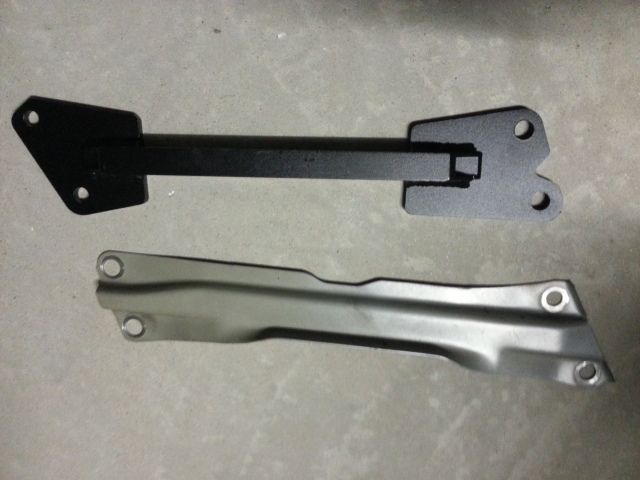

Also got my kartboy/tic order the other day and fitted up the tic fender cowl braces whilst the front guards are off...tidy gear I must say!

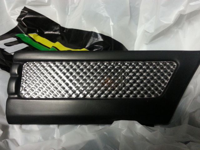

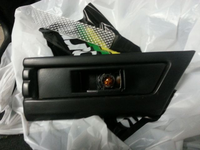

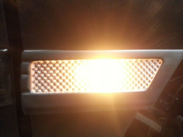

And also played around making up some clear indicators with diffuser, except I painted up the inner plastic black so that it doesnt stand out too much. ..which will go with the murdered out theme im going for atm....more on that later though ;)
So ill just keep chipping away with all the plans I have for her and update in good time....but with the 207 and a 6 speed In the garage im pretty damn excited of the coming months :D
Peace out!

Posted 29 June 2014 - 10:13 AM
Good work mate.
That engine is a PEACH! It'll knock your socks off once in and tuned, The sound is to die for. A little bit like a bridgeport rotary at idle and full rally car in the top of the rev range.
01+ ECU's are amazing things. Good choice.
If you need a hand in the near future, Give me a bell.

Good work mate.
Will do Cam!! Cant wait to get her going on e85 :) and yep excited to get michael to do some tuning again!

Although they'll work, the construction of those Kartboy braces looks basic and pretty rough for a brand name item.

Yeah they could be more braced I suppose...but its pretty solid 6061 alloy and I compared them by putting them in a vice and flexing them and they crap all over the standard ones....and are no heavier

Do those fender braces create a lot of NVH?
#198 Matt
Matt
  • 4,380 posts
  • Location:Lake Maquarie NSW
Posted 29 June 2014 - 04:55 PM
Highly doubt it...theres already ones there...havnt driven the car with them yet
Theyre simply a stiffer brace is all
Can vouch for this noise heard it scream personally in its old body  :D
Looks like this thing will be a beast probably make what your gen 3 power wise, but in a lighter body  :yahoo:
#200 Matt
Matt
  • 4,380 posts
Posted 29 June 2014 - 06:59 PM
Yep talking to michael south itll make about 235atw on e85...and in a much, much lighter body with a better setup suspension
