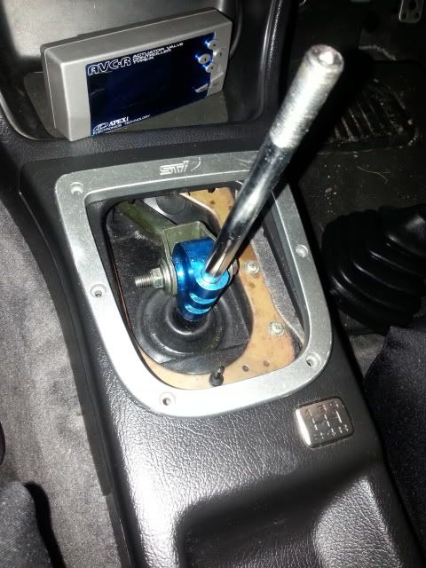

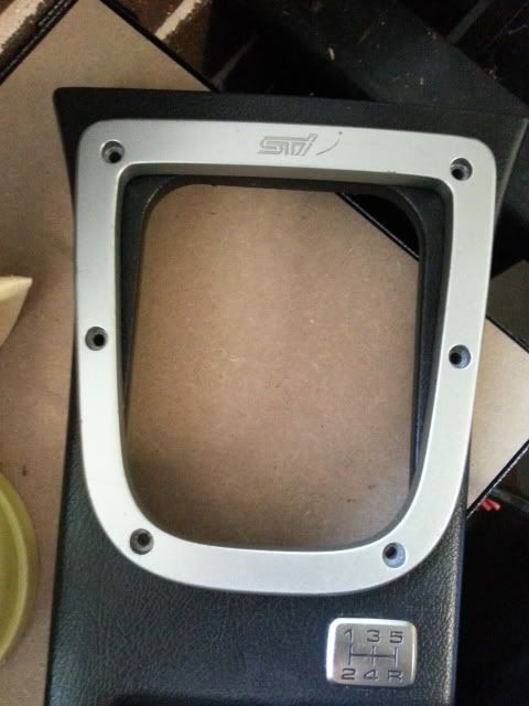

Package came in the mail today...bit of sti goodness..will be painted or powdercoated so dont mind the scratches atm
Now to decide on silver or satin black coat?? Whats the general concencus?
Just gotta get the dremel out and enlarge the hole to fit it...than get a redline black with red stitching boot to replace the rubber accordian boot...gonna get a handbrake boot aswell to go with a v7 sti red stitching handbrake lever that ill put in soonish...and tlk to them about a cover for the centre console...and the interior will be much like the gen3 was....and that was sooo nice ;)

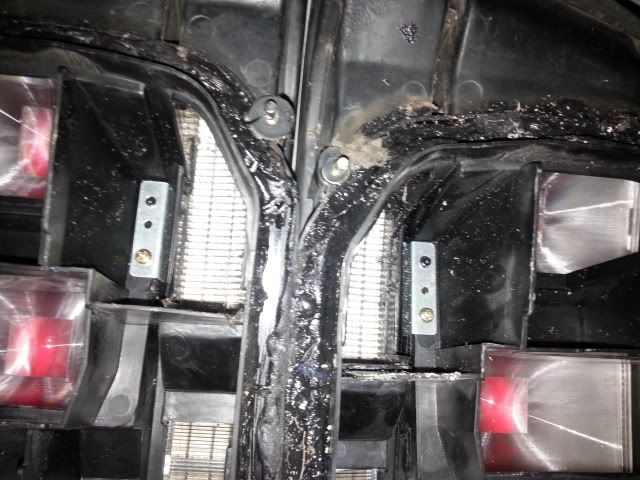

So...small update...with the big move just sorta finished I had a chance to spend ten mins on the car

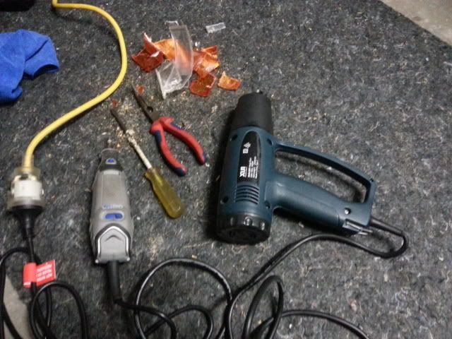

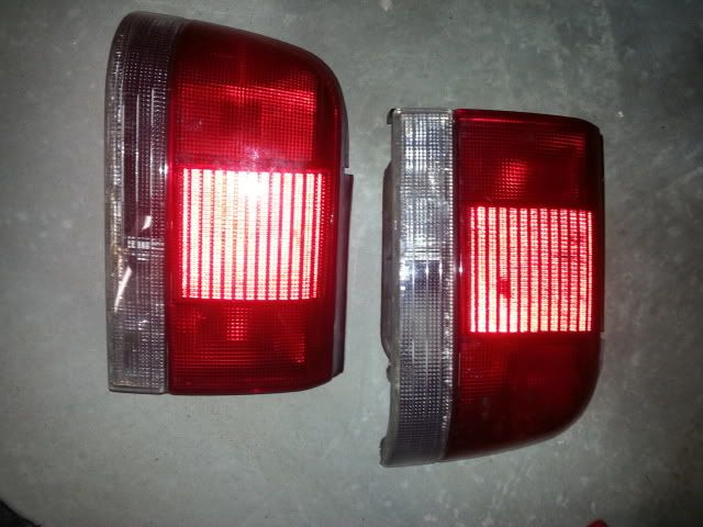

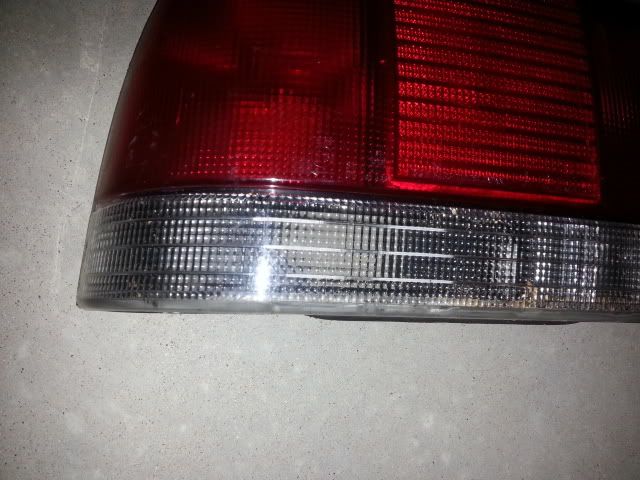

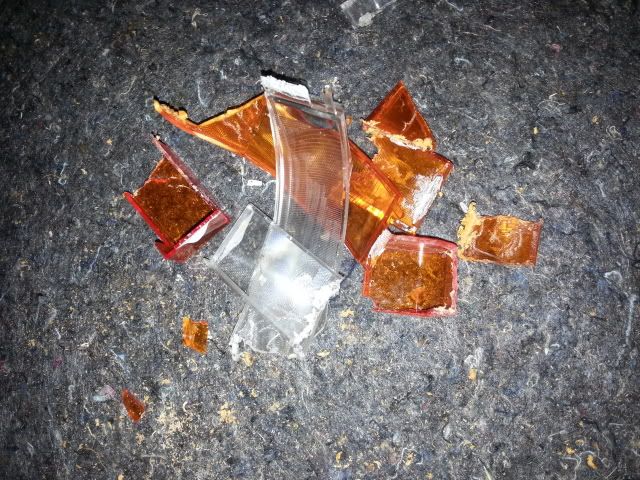

The rs came with jdm tail lights though they had been a tiny bit night shaded and had tiny cracks all over them
I wasnt too happy with the look of them so when I was at the wreckers last I pocketed a set of tidy tail lights of an audm liberty, though when I got home I noticed the indicator parts had orange plastic in them :(...and each side has a completely different setup which seems stupid...it made the passenger side one really orange and I was not impressed!!
I remembered the gen2 guys were able to mod the front indicator by cracking up and pulling out the orange insert so I thought I must be able to be done?
I had a wrecked light and accidently cracked that trying so I wasnt confident...but I rethought it and dremeled the plastic into pieces, bent and twisted...than hit the area witha heat gun..and after a bit of swearing they were de-oranged
They will have a wash tomorrow as they are full of plastic bits..but they look tonnes better now :)
