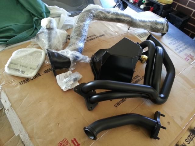

Coming along nicely Matt! Dayum those headers look good :)
Cheers guys!!...and yep they look awesome...troy at prospeed was talking them down on flow etc and the price...but im gonna give them a go with the vf34 and id doubt theyre all that bad with such a small turbo

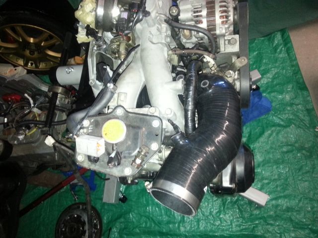

Got rid of a whole heap of glass off the engine today from when the previous owner cut the car up

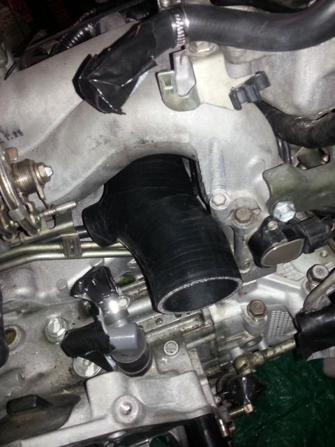

And also trial fitted the avo silicone intake the the engine...now all ive ever heard is how hard these are and they take like 3 hrs with tonnes of cursing? Yeah I have no turbo on the car atm..but it literally took me 10 seconds to slide it In?!
I couldnt believe how easy it was lol...looks a million times better than the soft (no metal wire support) ebay intake that was on it when I got the car
Also did a throttle body bypass mod while im waiting on bits which took up all of 5 minutes

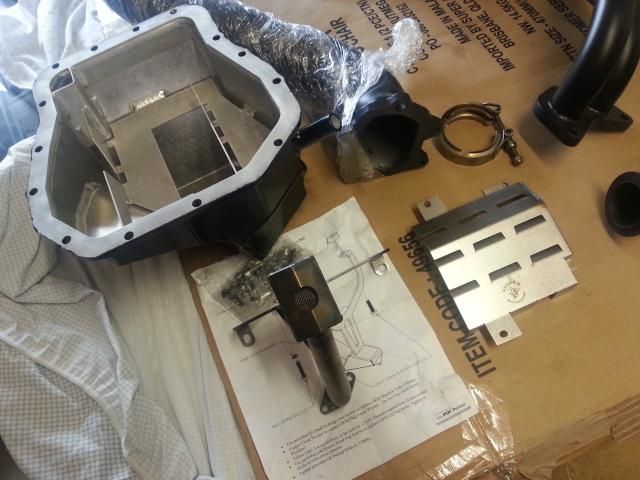

Sooooooooo, another quiet night shift with some free time. What better to do than to update this thread lol
Anyways, a bit has happened,...killer b sump package has been installed, ceramic coated headers are on, all rusty pipework has been replaced and the engine given a general tidy up and going over...just gonna put the VF34 on it soon and then wrap the engine up til its ready for install
Also in-case no one noticed, the RS will be matte black (eventually) I have coated about 70% of it so far with 3m wrap and it looks amazing!! if or when the wrap comes off and if I like the colour ill probably just cheaply paint it the same...as it will be a toy car after all ;)

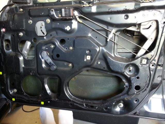

annnnd all the doors have had the central locking gutted and manual window winders installed for more RA spec lol, got a local trimmer I know to wrap the lx (blue) manual door trims in black wrinkle vinyl to sorta match the interior...came up pretty damn good!!!

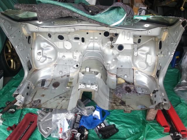

So up until a few weeks ago I had a garage overflowing with parts, junk, tools, the RS, the half-cut shell, my pet rats etc etc etc. Had barely enough room to move, let alone strip a car hahaha
But I had a week off and got jack of it and got stuck in, took a solid days effort by myself to tidy it all up.
I had to drag the wrx shell up to the road where I got the local scrappers to take it away, organize all the parts into sorted containers (rs bits, wiring looms, wrx parts etc etc) and put all my tools back into their rightful places (its awesome knowing exactly where my tools are again :dance: )

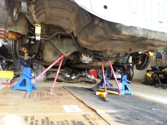

then I decided whilst the car was nose first in the garage id pull the rear end and freshen it all up....wow what a learning experience!! researched it a bit, though I had a fair idea on what to do and did it all by myself (woulda been much easier with some help though!)
I spent 10hrs in the garage on a 34 degree day replacing everything I could, cleaning bits up and torqueing it all back up properly and I have to say that the back end will be one tight mofo on the road!!
installed;
- Brembos all round with DBA t3 rotors
- project mu hi-temp hand brake pads
- BC coilovers all round
- Hardrace spherical bearing adjustable lateral arms and trailing arms
- Whiteline HD sway bar mounts and Hardrace spherical bearing sway bar links
- 03 STi rear sub frame (solid mounts)
- 03 STi front diff outrigger (t-bar)
- V2 STi RA r160 diff and corresponding shafts
- kartboy rear diff bushes
- kartboy clunk killer bushes
- whiteline sub frame lock bolts (more for sub frame alignment now)
- kartboy rear trailing arm bushes
- whiteline rear toe lockout bolts
And sent the old arms, subframes, disc rotors, rusty exhaust and shitty scraped up x-force muffler to the scrapyard to free up some space
I think that was it, doesn't sound like much when I write it.....but it was a huuugggeee and surprisingly fun day and there isn't much left to upgrade back there anymore......though I will need new axle boots soonish.....I will service them, but they can wait for now lol

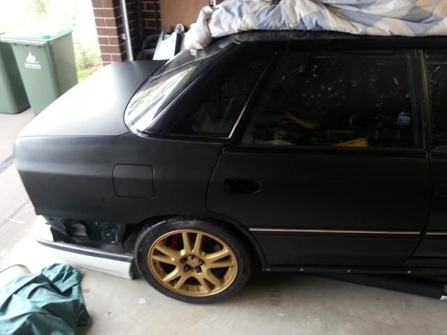

Pics, sorry not many as I was pretty damn busy lol...and excuse the crap quality shaky phone shots
A small glimpse at the colour scheme...been done yes I know, but ive always wanted a matte black toy car :)
WRX shell, gutted and taking up valuable space!!
Manual windows?? F*#k yeak retro stylin!!!
Out with the old
in with the new!!

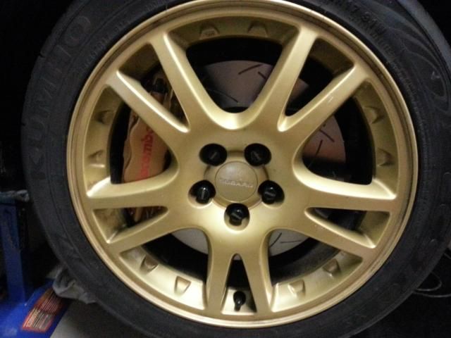

Couldn't resist getting Brembos again!!!!
Front hats brembo vs 4 pots.....bit bigger??
back from the coaters.....blaaaaccckkkkk!!!
where she currently sits...mouth wide open waiting for her lumpy goodness20141121_143237.jpg

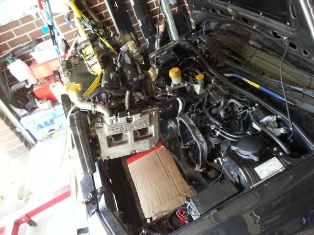

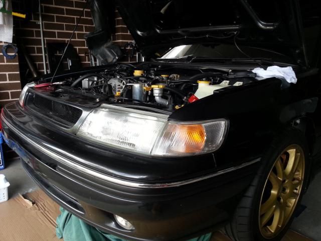

Posted 24 November 2014 - 01:31 PM

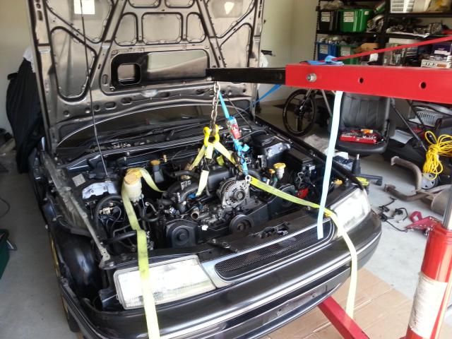

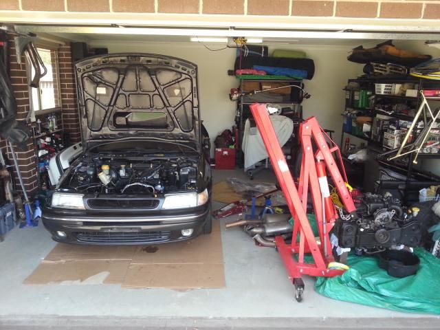

Had 3 hours to kill while the missus was at work today...so decided the engine WILL br removed from the RS today
And after draining some PS fluid...getting a sprayed a bit with fuel lol, struggling to crack some bolts and nuts and wrestling with the clutch fork pin for 30 mins...the car was lowered, and the engine was ready to be separated from the car
Was able to do it in the garage with plenty of space above the car for the hoist (cheering!)
And with my makeshift stabizer/angle adjuster (a ratchet strap hooked to the front of the engine) the engine came off incredibly easy!! It had a fairly fresh clutch on it so im sure thats why ;)
So now I have on engine on some bricks to sell on for cheap to whoever wants it (anybody?)...oh and some plug and play COPs that i will be selling on asap aswell.
The car is now back up in the air with the gearbag fluid being drained and the axle pins knocked out ready to start on the gearbox removal.
So all in all an pretty productive day I must say!! Once the box is out ill roll the rs out the front and give the engine bay a bath...though it copped a fairly good clean back at our old house..theres still a bit of crap I want tidied up before I move on to the new stuff
Ive also gott swap the brake booster over to an STi one I have aswell..as im pretty this will ve the easiest time to do it lol
Anyways ill hopefully get back into it on wednesday and get this box outta the way ready for the good stuff :D

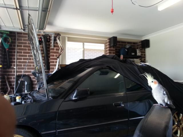

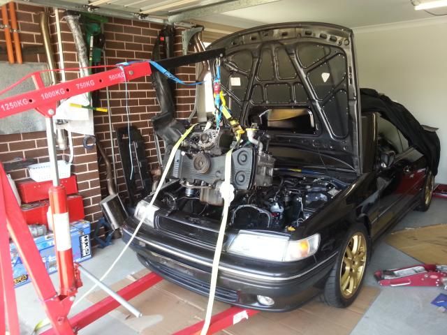

Posted 24 November 2014 - 01:45 PM
And away we go!!
My little helper for the day lol
The ratchet straps worked perfectly!!
And all out and tucked away until I can piss it off out of my garage
