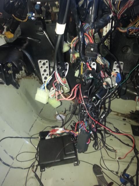

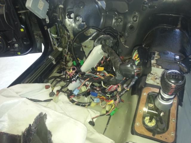

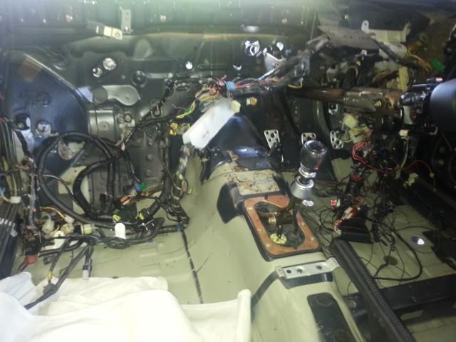

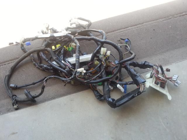

MISSION ACCOMPLISED!!!!!
Loom is out!!! Once I got the heater/ac gear ouy it was jyst a slow process of taking photos of how the loom runs and where every connection goes...I think i took about 500 photos lol....then add that to the 500 I took pulling the dash apart
Though im sure nonenof that will help hahahaha
Anyways loom is ready to box up tomorrow...just gotta pull the wrx back out, lay it out and pick out the part I need...and itll all be s3nt away on monday or tuesday for a holoday in sunny noosaville :D
While the dash and loom are out I will be stripping the previously hard to get at sound deadening and tearing out the rubber mat that sits on the firewall for more enjoyable...but noisy....weight savings
Next up is to roll the front end out onto the driveway and give the engine bay and front clip in general a good scrub and start cutting my newish reo to suit the fmic...as the original had been absolutely molested to fit it.....im a bit ocd about that sorta stuff lol

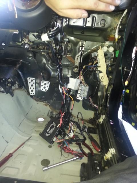

Once the heater core etc was out it was much easier to see what was going on
This alarm install?? Mind=blown!!! I hadnt undone anything at this stage lol
Got rid of some of the sensors, siren wiring, turbo timer and random old bits..much neater already!!
And interior loom and main engine loom are removed....tiny bit more to go

Posted 29 November 2014 - 12:18 PM

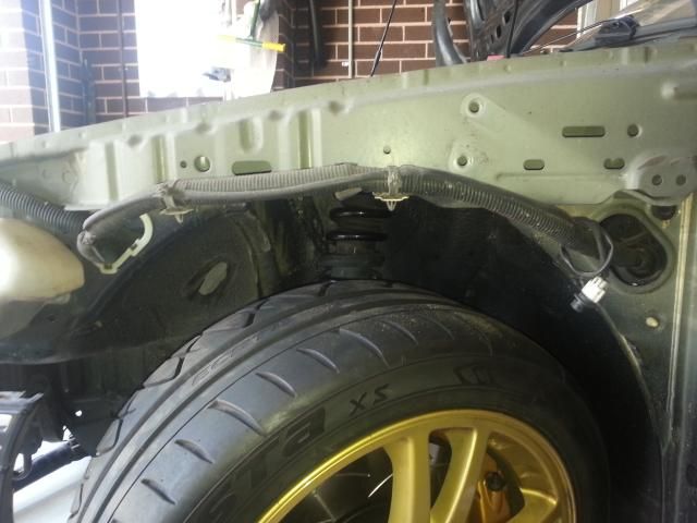

Had to remove this loom...so guard off...and a new guard will replace it :)
And loom is out finally!!!

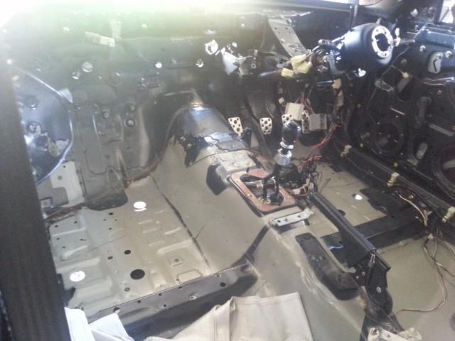

So bare in the cab now....hopefully Als loom will be soooo much tidier :)
The mess of loom under the column is just the old alarm wired into the key barrel...I will be taking this barrel off soon and putting the gd wrx one in its place due to the immobilzer in audm cars....think ill need to hack a bit of the steeri g column cover aswell to fit it

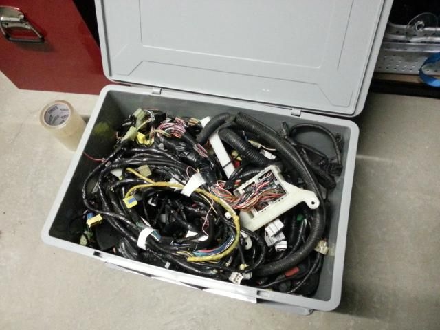

60L tub....24kg of wiring loom etc etc.....will be sent off over the next two days....hopefully will get it back much lighter in the coming weeks :D

#280 Matt
Matt
  • 4,380 posts
  • Location:Lake Maquarie NSW
Posted 30 November 2014 - 07:54 PM
WoW...Leave the wiring out, weight reduction?
If I just wanted to roll it down the hill like a billy cart yeah? lol
