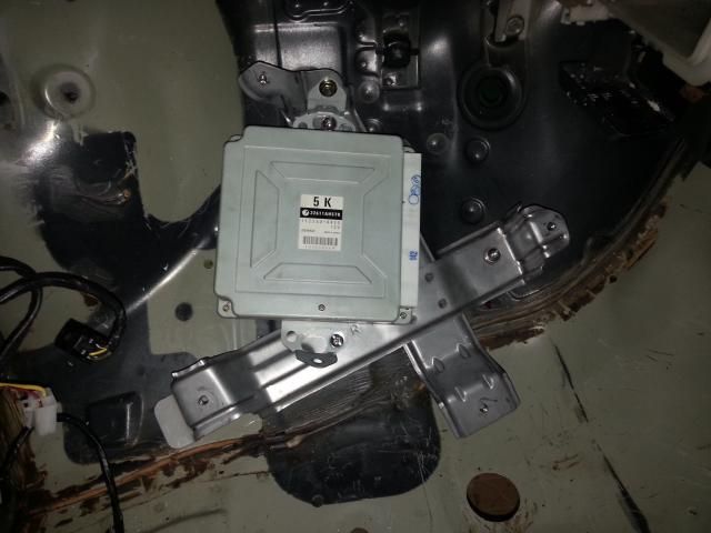

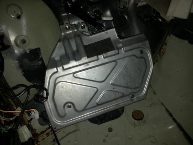

Had to custom fit the gd ecu mount to the rs....as some of the bolts went into the chassis rail I had to drill and tap some holes to hold it firmly. ..came up pretty oem looking I must say....also due to the wiring splice the loom to the ecu is much shorter...as the loom usually loops under the ecu and plugs in the other side...al said it wouldnt fit like this...but after I flipped the ecu 180 degrees and re-formed the wiring it fit perfectly!
See..looks like its supposed to be there ;)
Dash loom in..minus mounting the fuel pump controller and alarm

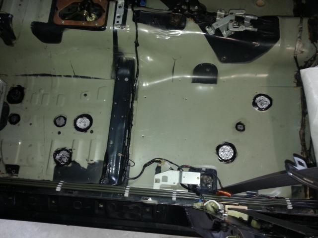

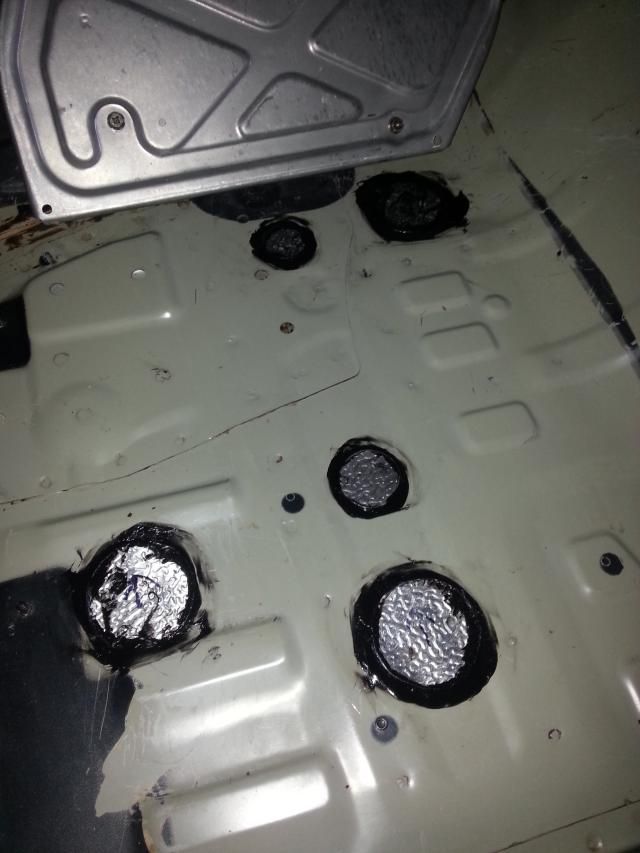

Had to plug up the body holes after I removed the heavy plugs along with the sound deadening....used some thin alloy and some horrible to work with auto sealant....looks worse than it is ;) 20141217_182010.jpg
The old wrx loom is in there somewhere?

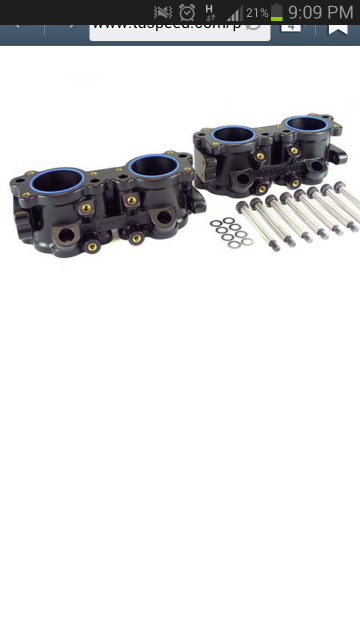

These are the cosworth tgv deletes I scored...will go on over the weekend hopefully!

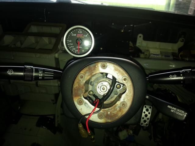

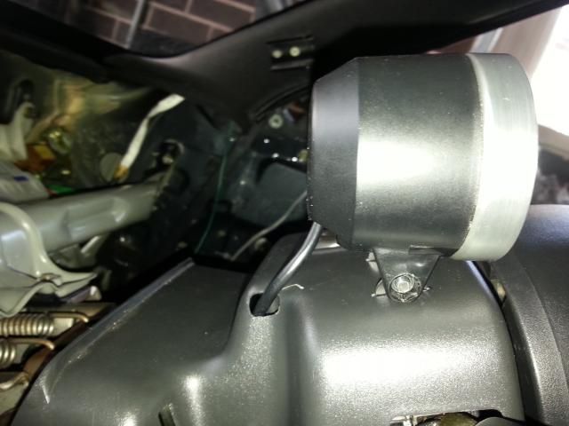

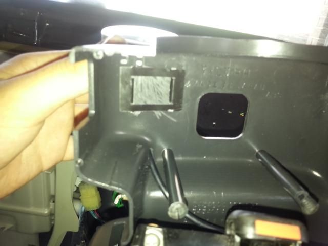

Fitted up the genome boost gauge today....made it tidier by mounting the foot pad under the steering column and cutting a hole to poke them through....look heaps tidier this way I reckon....just a dab of 5 min araldite to finish it all off
#317 CRUISN
Posted 18 December 2014 - 06:28 PM
Nice and tidy install.
Sikaflex 227?
Sticks like all fork!

Cheers Mark.....screw holes have had better days so ill probably replace the top bit later on.....after doing it I reckon I can do it a lot neater next time....but main thing is its not just stuck on with double sided tape lol
Sikaflex 227?
Pretty sure thats it Jas....great stuff...but omg its messy lol
