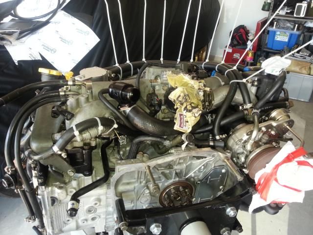

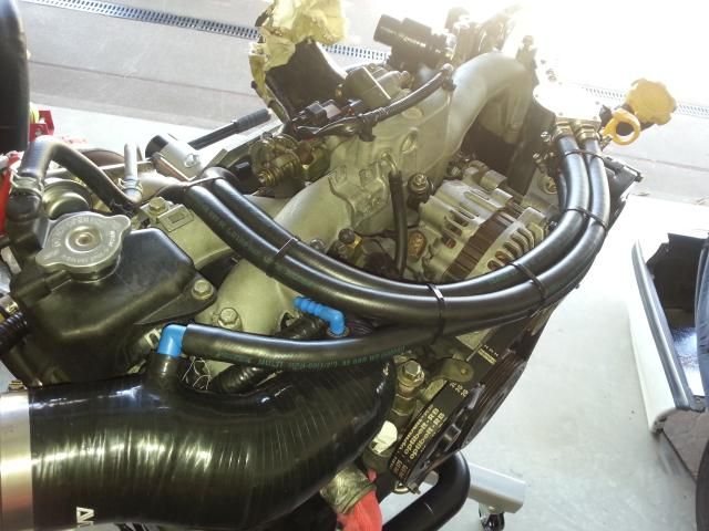

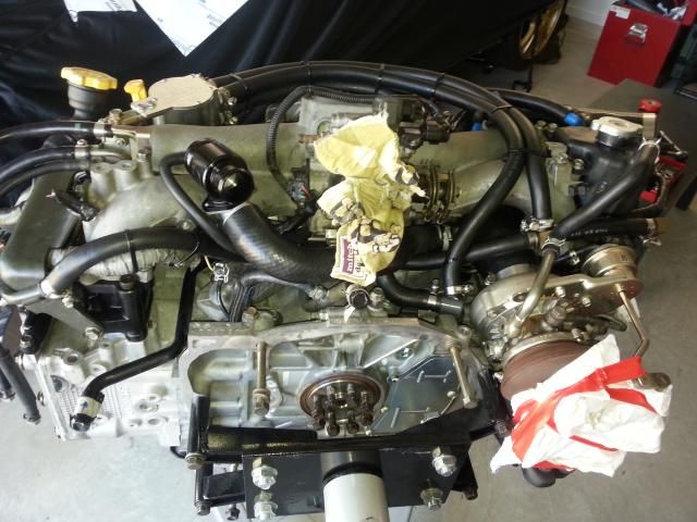

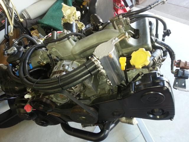

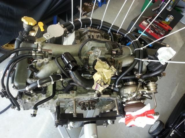

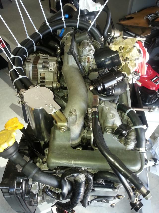

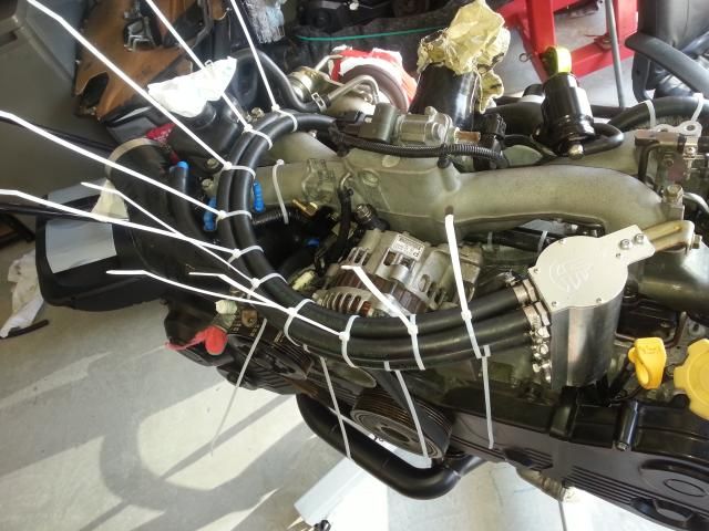

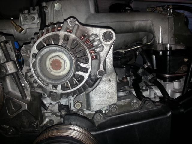

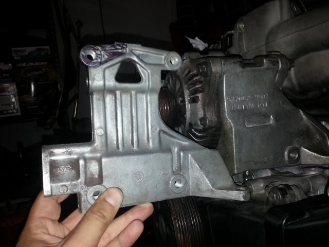

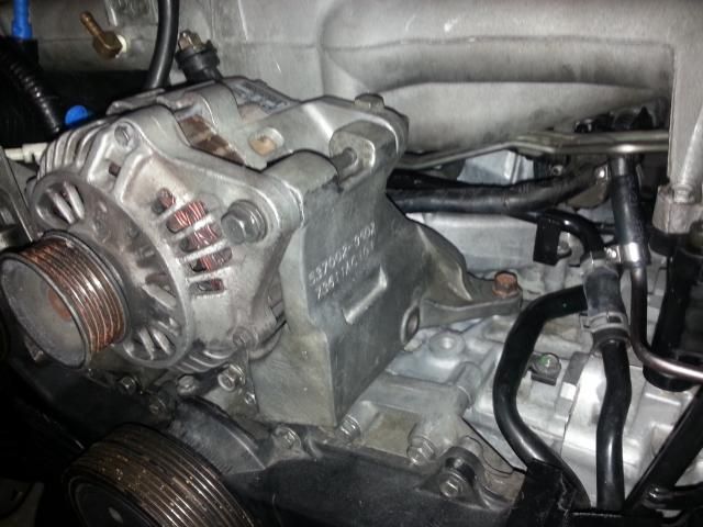

Posted 22 December 2014 - 11:24 AM
So the catch can install continued today.....had to cable up some bits under the manifold and bolt the alternator and power steering brackets up properly before I could start....and I also remembered that Chris (rallyee) gave me an already modded alternator bracket for removed A/C......which saved me cutting one up myself
Once that was on it allowed the pipework a cleaner run over the alternator
And the I chipped away at the pipework cutting and clamping as I went along..and using my endless supply of white cavle ties to hold the pipework together while I was positioning stuff....these ties will be removed once the black ties go on if anyones wondering ;)
All in all pretty happy with the routing of the hoses...and both head and pcv connections are in a fairly easy to get to spot on top of the turbo inlet....so more pics to come once I finish it off with the black cable ties and piss off all the white ones
And once this is done...its time for the car to get some more loving and get this dash loom finished and the interior back in

#348 CRUISN
Posted 22 December 2014 - 12:19 PM
Use back spiral wrap around all 4 lines. It'll look even neater than cable ties.
#349 Matt
Matt
  • 4,380 posts
  • Location:Lake Maquarie NSW
Posted 22 December 2014 - 12:23 PM
I was going to ask about black cable ties last night but though surely they will be changed. I was right :P
Coming together nicely mate :)
Hahaha no way would I leave the white ties on........I have about 3000 of them from work....so if I know im gonna chop them off theyre the ones I use ;)
Theyre handy as hell for this type of stuff...and for holding stuff outta the way......cable ties and duct tape are some of my most favourite tools in the garage lol
Hmmm never thought about that? I've never seen it that big local though?
Might have a look later on ;)
Cheers

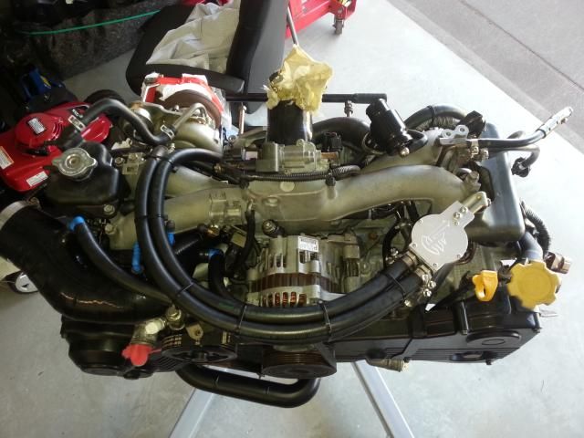

#350 Matt
Matt
  • 4,380 posts
Posted 22 December 2014 - 02:16 PM
All better in black :)

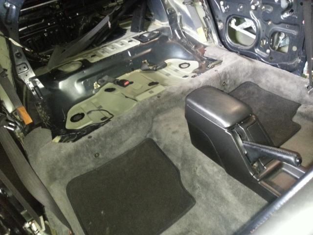

Posted 23 December 2014 - 12:14 PM
Dash is back in along with most of its trim bits....cluster back in later.....what a prick of a job lol
Carpet is back in after another good beating and vacuum to gwt the never ending sand out of it...seats should be back in tomorrow along with the rest of the dash.....door trims are still off for the vinyl wraping etc
