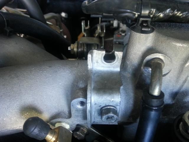

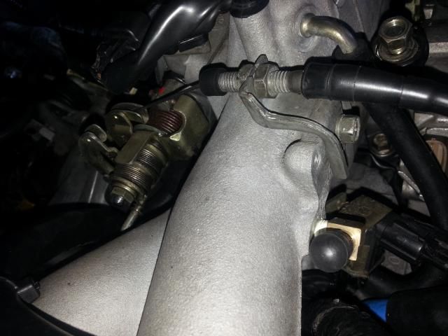

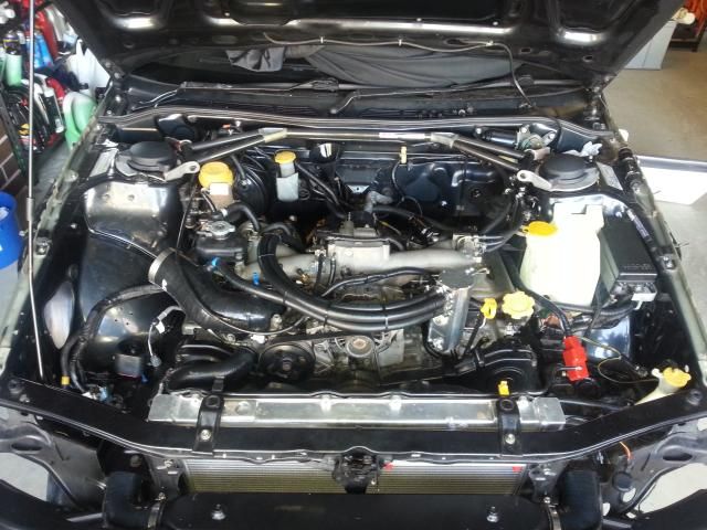

Had a hell of a time trying to sort out the accelerator cable since the engine went in.....thought it would all fit with the stock cable on the GD throttle body....but when I tried it the threaded secition was nowhere near fitting...which sucked lol
So I tried the GD cable after Rob brought it back over for me as I sold him the gd pedals....to only find out the cable in the rs is anchored off the firewall....not the pedal box like the newer stuff
WTF?!
Then I noticed the cruise cable mount sits a fair bit closer to the throttle linkage...hmmmm
So with a grinder in hand and no need for cruise control anymore I chopped the mount in half and used the mount for the cruise cable in the accelerator spot.....worked a fricken treat!!! Perfect fitment and no screwing around with changing cables etc...happy days!!!
See fits like a dream...even used the pulley cover bolt hole for a cable mount ;)

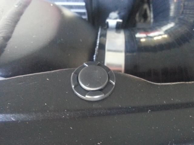

Scored a full set of the newer (much easier to undo) bumper clips whilst at the wreckers aswell for the front end...its all these small things that make the car that tiny bit better :))
Also chucked the STi strut brace on to get it off my shelf...th ends will be powdercoated with all the rest of the stuff in one hit later on and ill get rid of the overspray on the carbon that someone so nicely done lol

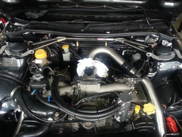

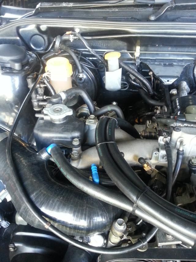

Spent half an hour on the beast today

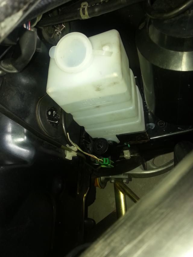

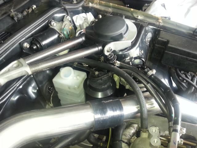

Noticed that the washer reservior was in the way of the cold fmic pipework as they now have to sit further out compared to on the old engine
Figured id just heat up the bottle with a heat gun and mould a groove to fit the pipework in..and while this did work..it really didnt look all that pretty lol..and was still kinda tight
So I figured id sort something else out....I have a 1.2l reservior off my 4x4 that came with the snorkel that I never used. I was gonna put it in the boot...but atm I couldnt be bothered running a line and some wires down the back...maybe later down the track
I then noticed now I have the cruise and ac bits removed I have a nice spot up against the firewall on the passenger side rail next to where I relocated the charcoal cannister....and low and behold it fit perfectly lol
Trimmed the angle mounts of the bottles holder and chucked a few holes in it and drilled some in the chassis rail and tapped them to suut some M8 bolts
All I had to do was re route the water line...and cut the the wiring as ill run a two core cable back alo g the passenger aide gaurd with the loom, back into the car and poke it out the old ac pipework grommet right next to the pump
Should only leave a couple inches of wire and otherwise look fairly neat and tucked away
Needs a clean...the bracket will get powdercoated with all the rest of the stuff after its all running..and a cable tie goes around the middle to tie it up against the bases back plate
