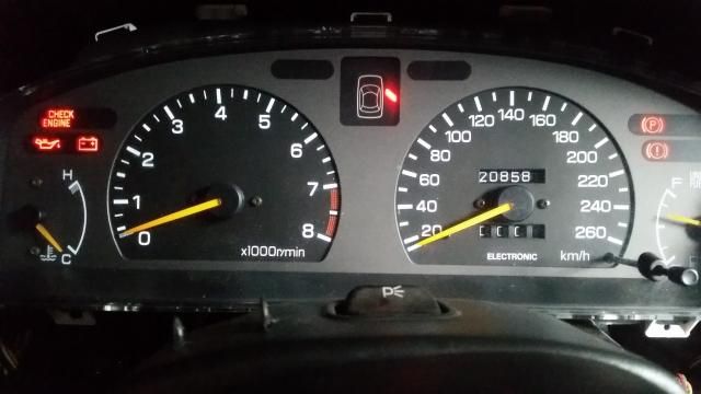

Can confirm in my RS CEL comes on and park brake light stays on regardless of handbrake position with key set to ON.
Thanks heaps for that...i have a feeling the park brake and brake warning light are connected somewhat till the engine starts
does the (!) Brake warning lamp stay on aswell until the car starts?

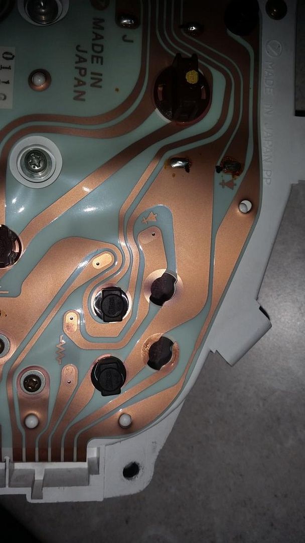

And ive solved the CEL...couldnt sleep as i was thinkin bout it...so got up and pulled the cluster
No globe in it :D....they must have pulled it due to the aftermarket ecu that was in it
So off to the wreckers in the morning

Yep brake warning light stays on as well.

Shows how butchered my loom was. Inever had the low brake fluid light come on. But then my check engine light came up as the passenger side door lol.

Sweet, well hopefully once i put this globe back in everyrthing is as it should be :D

All fixed :) bit of a relief i must say!

Dash is now all back together and works a treat!

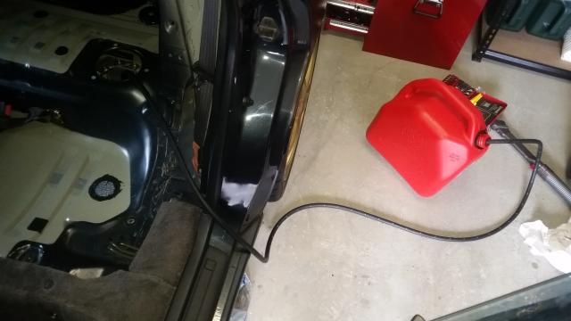

Now on to the joyful job of draining 50L of 10 month old fuel....ive managed to siphon it out without getting a mouth full of fuel yet lol

Sooooo...fuel tastes like ass lol
All drained and a full tank of fresh BP98 in the tank. Rear seats are now back in..so aside from the door trims the interior is back together!

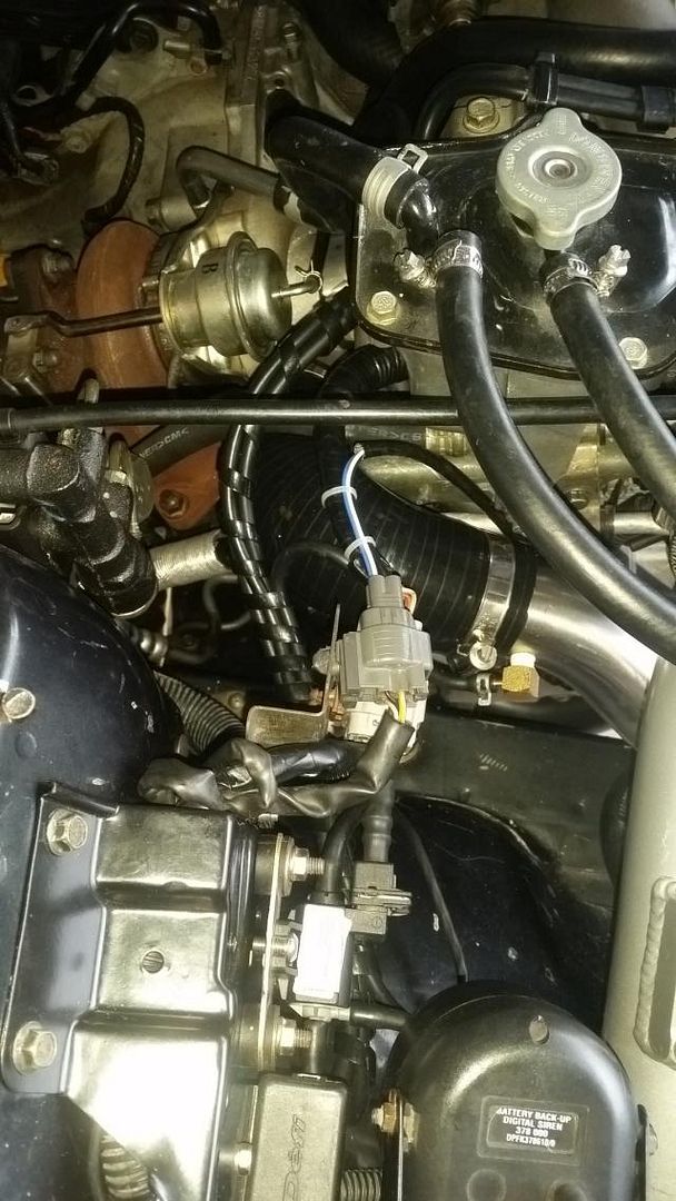

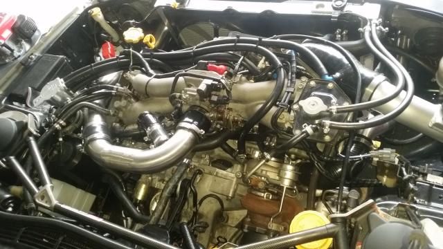

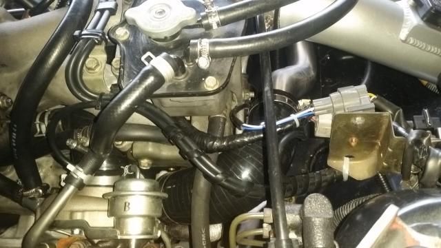

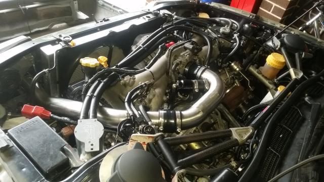

Vac/boost control lines are done! And look tidy i reckon, i used the spiral bits off a few clutch soft lines to hold and guide the hoses. I will have to unplug the wastegate and boost sense hose, link them together and bridge out the wastegate straight to the boost sense so i run on wastegate pressure till the tune, as its got a run in tune still on the ecu
Due to rotating the turbo, the compressor barb fouled on the tgv housing. So i had to remove the barb and put an allen key bolt in it with some 3 bond to keep it in there

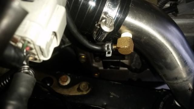

But alas, where dafaq do i get the boost signal from? I was gonna drill and tap the comp housing, but cbf as the turbo is installed already lol
Talking to Al (can not thank him enough, from my gen3 to this car he has been a wealth of knowledge and is always happy to offer assistance) boost is boost...so i just drilled/tapped and screwed in a barb into the first inch of the hot fmic pipework
Should work a treat ;)
so the engine bay is pretty much complete to be able to start the engine... (not actually complete obviously ;)..).....just need to clean the cold side pipework out and put a battery in

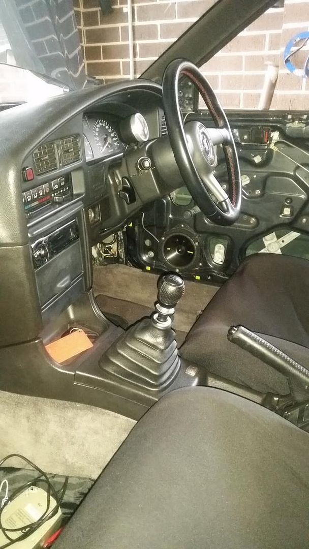

also put the accordian style RS shift boot over the 6 speed shifter....i have a gd sti setup to go on it eventually though ;)
