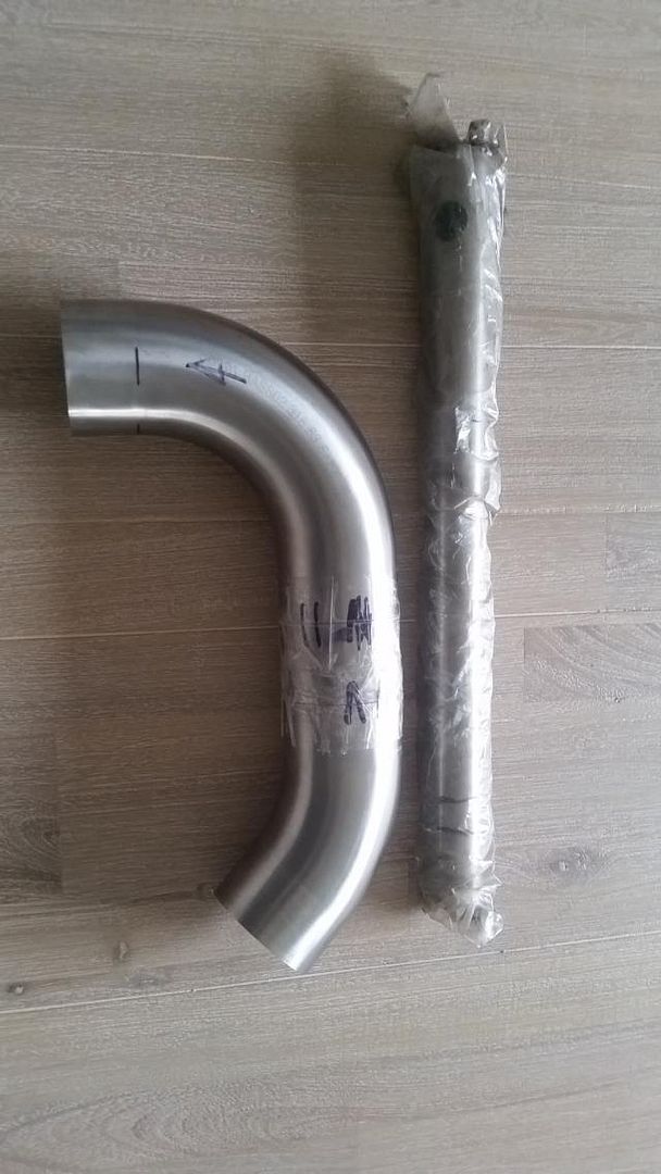

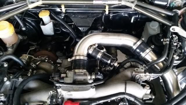

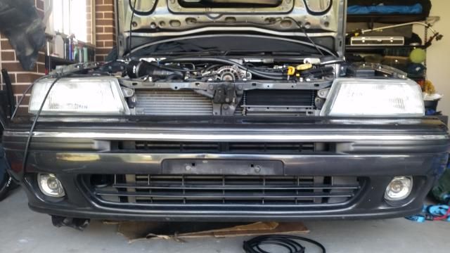

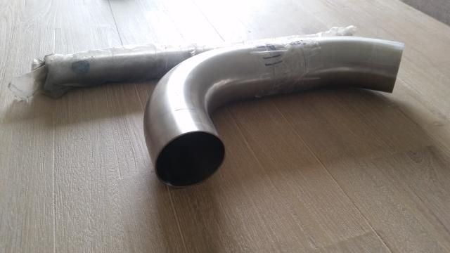

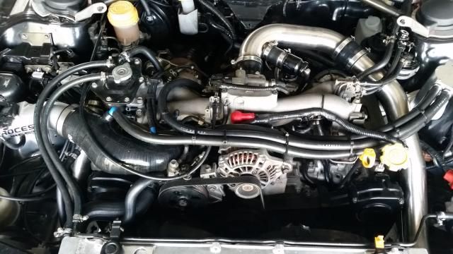

Was primarily waiting on a mate to ginish the fmic bend into the throttle body as the old one didnt fit...was gonna just add 11cm of straight tube to it, but that looked retarded, so i got some 90 and 45 degree mandrel bends, some straight 2.5 inch and some 34mm for the bov barb and starting marking it up for my mate Nick to tig together at work
after he tacked it all together i test fitted it and all was gewd! Also got him to cut the beads off the old pipes and weld them onto the new ones as no one seems to have a bead roller :(
Anyways its all together now and i used some 34mm radiator hose for the bov until i het some silicone pipe in black for it...probably once everything gets powdercoated in a wrinkle black like the gen 3 was
So now im that one step closer to starting the old girl

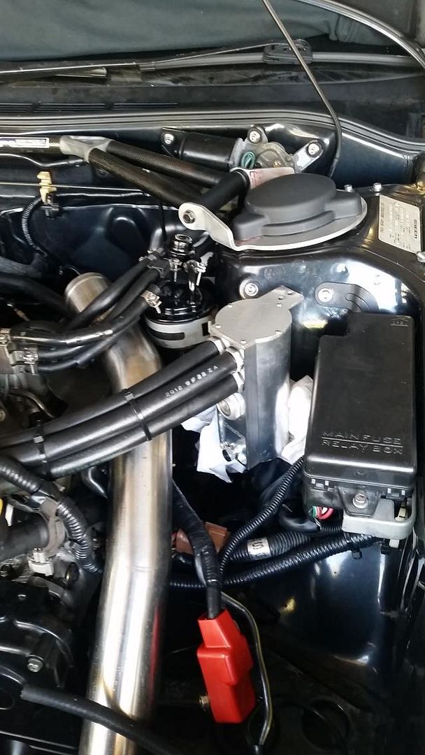

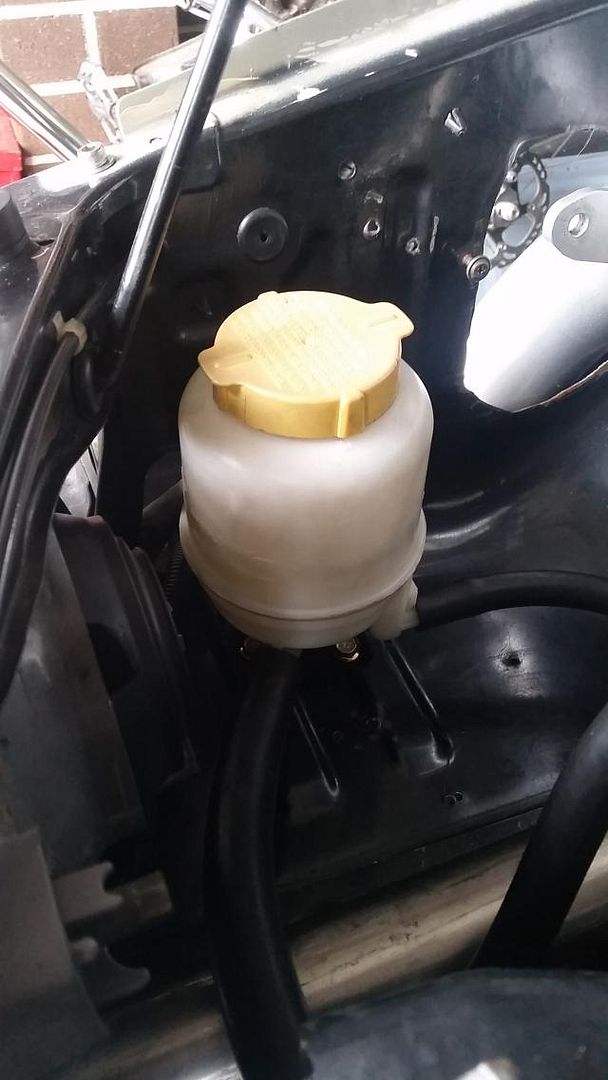

Also as you can see in the pics in the post above, i moved the catch can over to where the washer bottle was, as the pipes just touched on the bonnet the way they were :(
The pipes arent finalized as of yet and will be tidied up when i get around to making a new bracket for the can to bolt to the strut tower

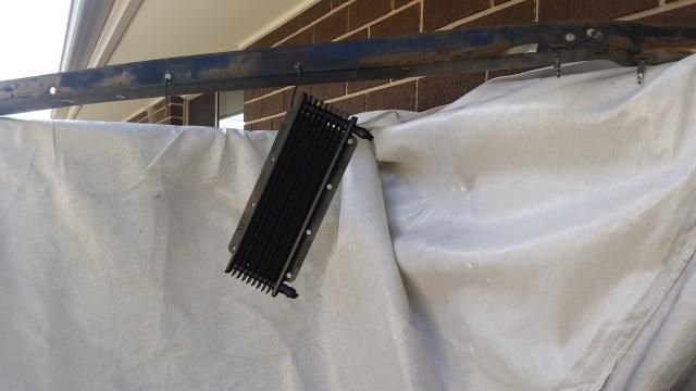

Also got the power steering setup all installed and roughly bled, got the PWR cooler painted black and used some leftover speedflow barbs and hose to connect it all up, came up rather tidy thanks to the extra room in front of the radiator due to no A/C
had to use a lancer ps inlet hose to get that bend into the pump as i gave my hose to Rob lol...all good...cost 50 cents approx ;)
Also scored a much bigger GD style ps fluid reservior whuch has better positioned hose barbs....and being bigger is a bonus

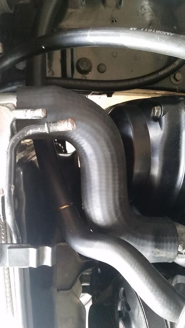

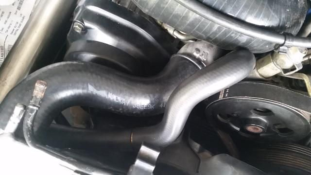

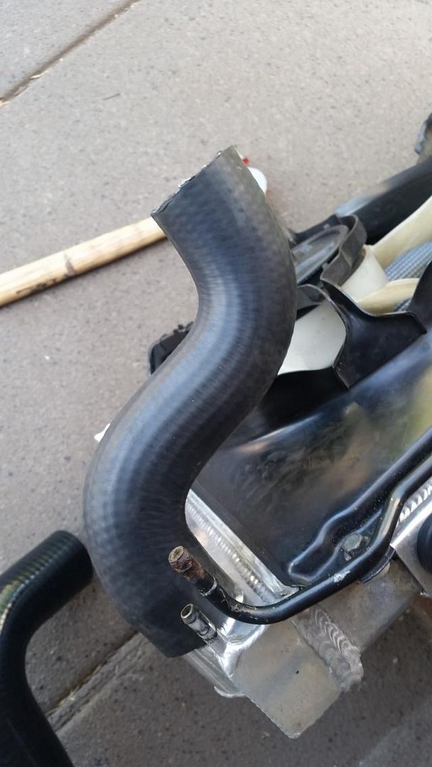

Next issue was the GD coolant pipe on the engine coming off the engine at a different angle than the early engines
So the gc hose wouldnt fit without kinking?! And since i had a newish alloy rad i dont wanna put a gd rad in just yet.
So down to autobarn i went and spent half an hour looking through the pipework for one that may work...and i came up trumps with a commo VL 5L V8 lower radiator hose...i thought it'd be close...but after i cut the section i need out i swear it was designed for it as it fit perfectly! And all the stores have spares...and it was $10! Not $38 like the subaru one lol

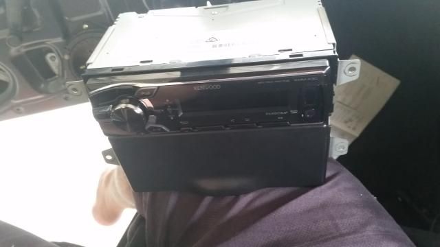

And last bit for the moment is that i wanted a stereo back in the car, as the car will still be registered...but i needed to ditch the heavy screen/dvd player one that was in it and find a cheap single din so i can use the 1.5 cubby hole i scored aswell
Along came the $99 kenwood media player...no cd player..just radio,usb,aux etc and weighs as much as a cd case...and is only 2/3 the depth of a cd player

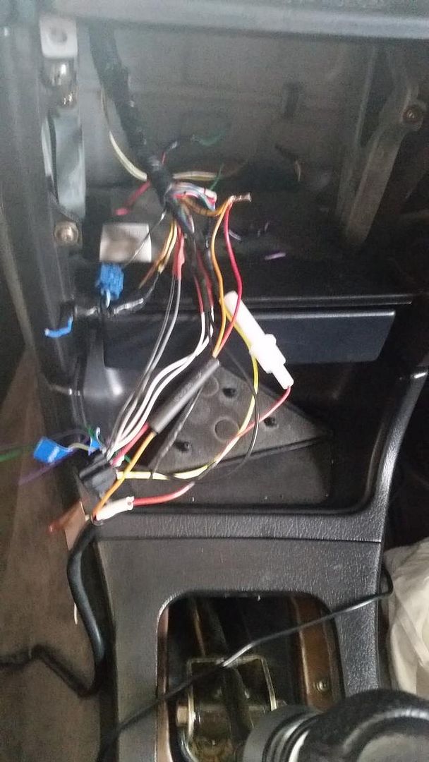

So i tidied up the wiring monstrosity that was a stereo install and wired in the defi boost gauge whilst i was in there so the controller can fit into the 1.5 din cubby
Came up super tidy, very light and plays music! Oh and i wired in some good kicker splits that i scored free to the front doors and will not be running rear speakers

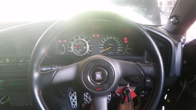

How come no check engine light on the dash?

Umm doesnt it come on..then go away after a sec?
Will check if it comes up next time

Nope just checked...no cel when switched to on?
Will give Al a call in the morning maybe
Will check the globe tomorrow aswell maybe

sure am!! Gotta stop myself though and double check everything before i just jump in....gotta figure out why i jave no cel up first

Cheers Cam! Gotta diagnise why dafaq no cel comes on when switched to "on" first....fuel pump primes as it should and everything else seems fine....but the cel is nowhere to be seen :(
Will check the globe first up....fingers crossed thats all it is!

Just realized your low brake fluid light is on. Didn't think it came on with all the other lights, unless you have low brake fluid?

Yeah it is....pretty sure it stays up till yhe car starts...a pic Rob sent me of an rs showed it and the park brake on?
With the key in the on position (engine off) does your handbrake light turn on and off with the lever going on and off?

Can confirm in my RS CEL comes on and park brake light stays on regardless of handbrake position with key set to ON.
