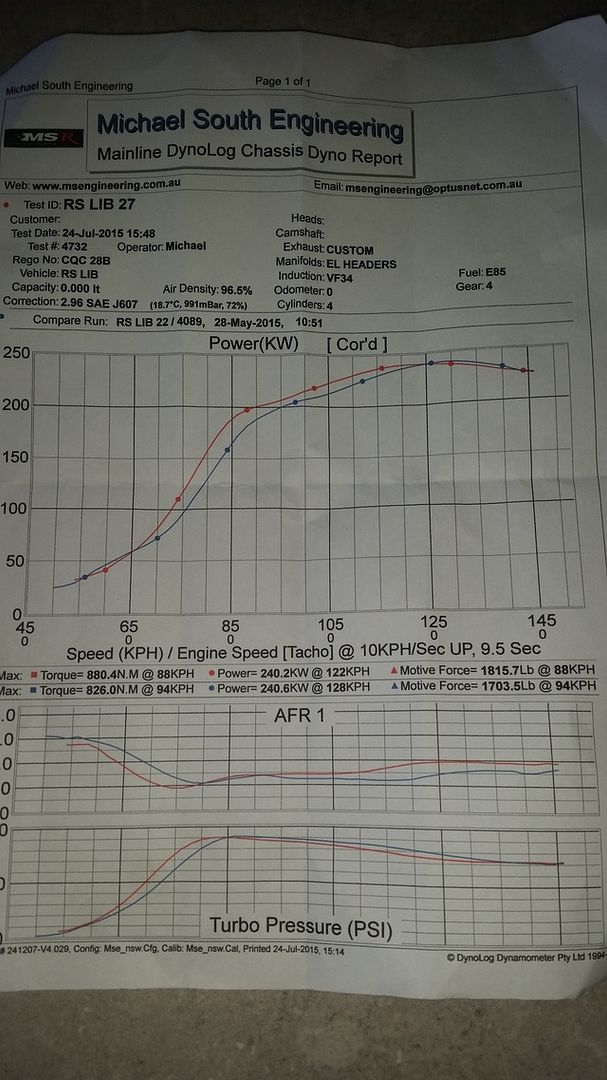

Fueling issues
Fark! lol
DW300 pump is not performing it seems :(
Seems its performing like a dw200?
Mick even spent the time to try an adjustable fuel pressure regulator on the return but the pump just couldnt supply the juice
Slightly annoyed to say the least
But this is the price you pay i suppose ffs
Gonna try a bigger pump and delete my oem fpr to just run an adjustable
Annoyed...but we just need to keep pushing forward
I will get this thing working perfect!!
But...the bigger intake definitely brought on the power much earlier which is good :)
But no more power yet

#1008 Matt
Matt
  • 4,380 posts
  • Location:Lake Maquarie NSW
Posted 25 July 2015 - 11:05 AM
This is the dyno sheet from yesterday
Even though we couldnt make any more power due to fueling...you can see that the bigger CAI allowed the turbo to reach full boost earlier and brought the power on much earlier and gave a touch more torque and with less boost required :)
The thing wants to make more power...just needs fuel lol
But you can also see on this sheet how the car now leans out due to the fuel pump being unable to supply the fuel
Blue is last run....red is the current tune
fingers crossed the fueling fixes planned fix this issue finally
