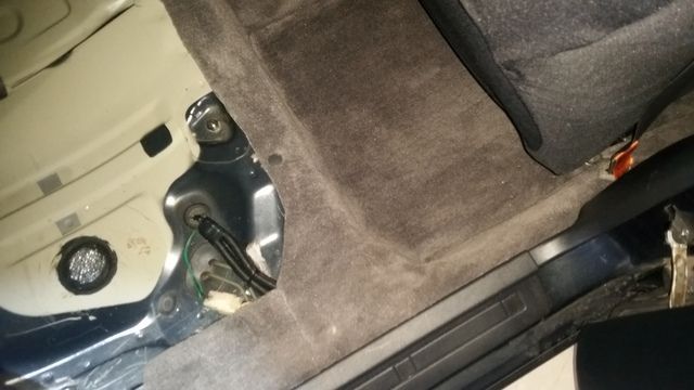

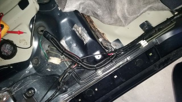

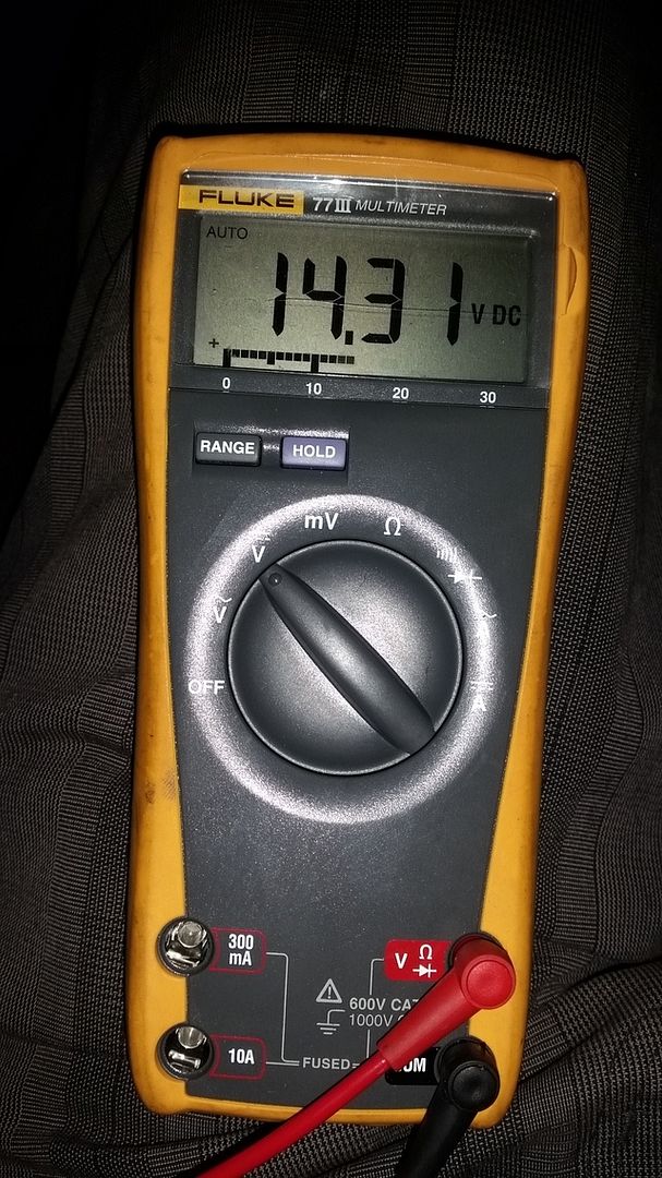

So after some searching around i found no issues at all with any connections in the fueling circuit
But the pump was suffering low voltages due to voltage drop
Getting a 0.4v drop just at rest with the car off
About 10.4v when priming (12.22 at battery)
And about 13.2v whilst idling at 7.8A (14.41 at battery)
After lots of research i found that its an issue with the fuel pump controllers dropping voltage....bigger wires help (i already have these) but arent the full fix
Enter the dedicated positive feed straight off the battery

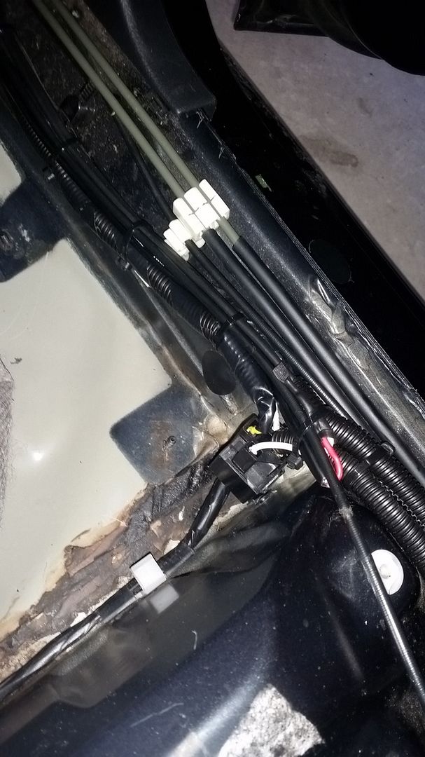

Wanted 10 gauge (6mm2) but could only source 8 gauge (8mm2) meh..the more the merrier lol
Ran a 3.6m feed from the battery to the pump area....that went into a 40A relay and then to the pump
The relay was switched by the original pumps positive from the controller to the pump and then to ground
So the ground between the pump and the controller is still oem but is a much bigger wire the whole way
I also added a 10 gauge cable to the chassis in addition on to the fuel pump controllers ground to give it a better chance
after all this i was getting a 0.01v drop at rest
On prime the volts went from 12.2 to 11.9v
When idling im getting 14.31v...with 14.41 at the battery
And the pump now only pulls 6.1A at idle compared to 7.8A earlier
So at idle i get a 0.1v drop the whole time
yet to give it a drive to see what it does..but can only be better :)
Was gonna tuck it all in to the boot...but found a nice secure and well hidden spot to mount it on the way
Should be big enough?
Fit pretty neat...all well protected
all hidden
new idle voltage
so all in all a big win i reckon...seems to want to kick over better aswell.
But still take 4 or 5 goes due to the e85 lol

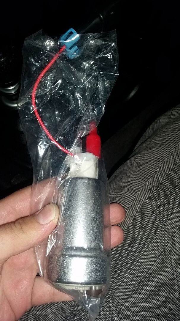

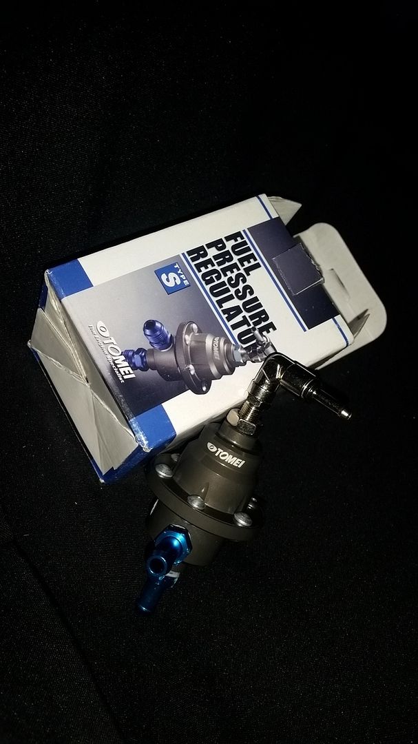

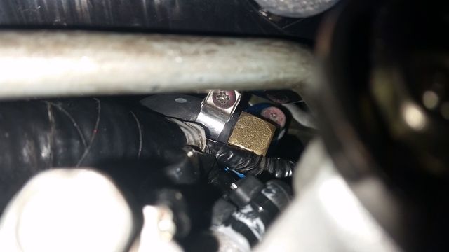

In light of the mucho bigger 460L fuel pump going in tomorrow...i needed to delete my OEM fpr as it gets over run with the bigger pump and typically doesnt keep up

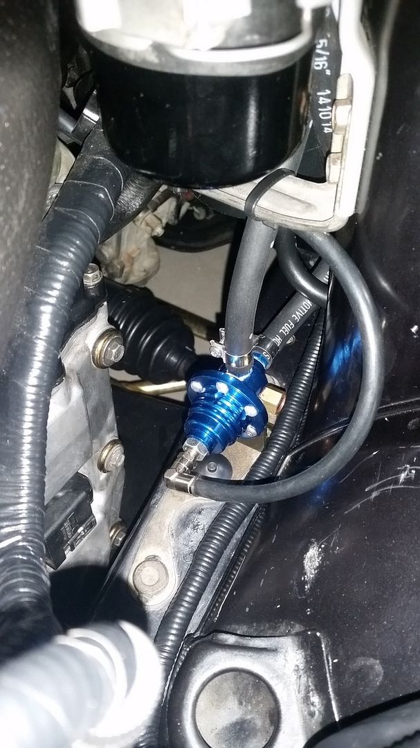

So a trip to pro speed straight after the tune saw me grab the new walbro, a fitting kit, a fpr delete plate and a tomei adjustable fuel pressure reg to get rid of the temporary tomioka one mick installed on the dyno (much better quality)
The tomioka reg was leaking when i left msr due to little to no thread sealant...so i fixed that with some 3 bond 1215 on all the thread and let it cure for 24hrs
Did the same for the 90 degree barb on the fpr delete plate
Then pulled it all down to swap the reg for the delete plate, and properly mount the new adjustable regulator
The reg will be swapped when i go to micks next so he can set the base pressure how he wants (4 bar i think it was)
Delete plate was a bitch to install lol...needed to trim about 5mm off the barb to ensure it didnt kink the hose...fts perfect now :)
regulator is mounted on the chassis rail...fairly hidden...and will be more so once the catch can gets installed over it

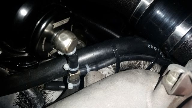

teed into the BOV vac line for the new reg...as mick says if the line fails it'll never seal the BOV and will stop the engine boosting....ie for safety ;)
used a steel t piece...and will swap the white ties for black ones asap ;)
New E85 proof walbro 460 pump...its huge!
Fancy regulator to be installed

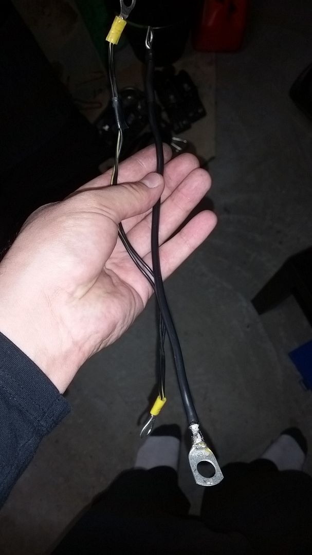

More tidy up today
Whilst im waiting for the water to get turned back on at the house (major inconvenience lol), i thought id fix up something that ive been meaning to do since the swap
With the resin Cosworth TGV deletes i installed, i obviously lost all connection to the chassis ground for the intake
This is an issue as all the ECU grounds go to the intake!
I had a temporary set up with a set of paralleled wires going from the intake to the alternator bracket which is bolted to the block
Now this works absolutely fine, but looked shite and probably wasn't the absolute best set up
Now I could have just bolted the earths straight to the block, but the OEM wiring is formed to fit the intake...so I just left them where they're supposed to be
With a fair bit of spare 10 and 8 gauge wiring handy, and some heavy duty crimp lugs i decided to do it properly
Piss easy job....just a 10mm hole lug one end, and an 8mm hole lug on the other end
Pre tin the cable ends, crimp new lugs on, properly solder lugs to cable, add heatshrink and bolt to engine
Done..you can see it going from the ground wires on the intake to the alternator bracket
and this was the old wiring next to the new stuff...crappy and small vs big and properly done......ie overkill lol
