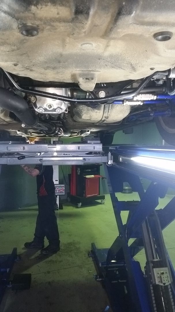

At the aligners getting a rough setup so im not crab walking off the dyno lol
one thing of note is i may have to pull the r180 again to send it away to set the backlash
As its a bit klunky on gear changes

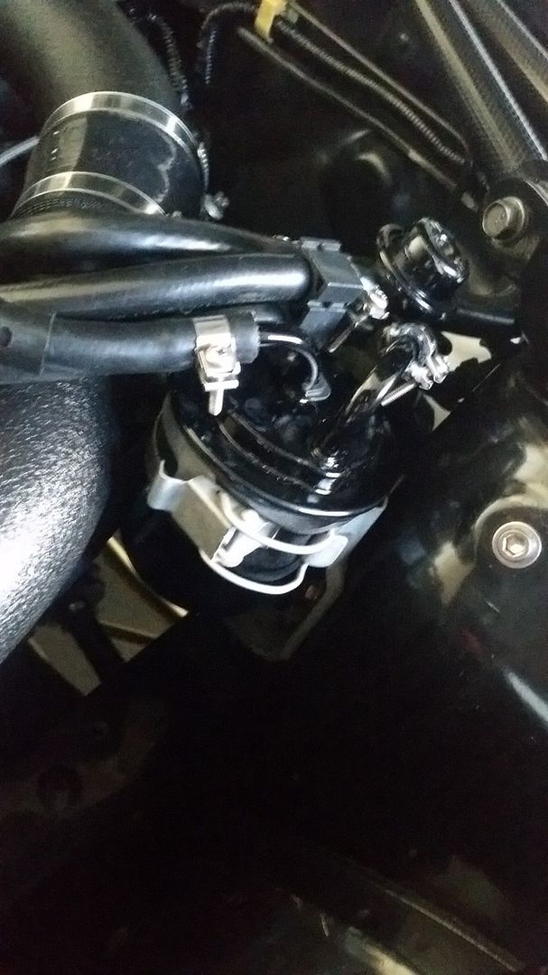

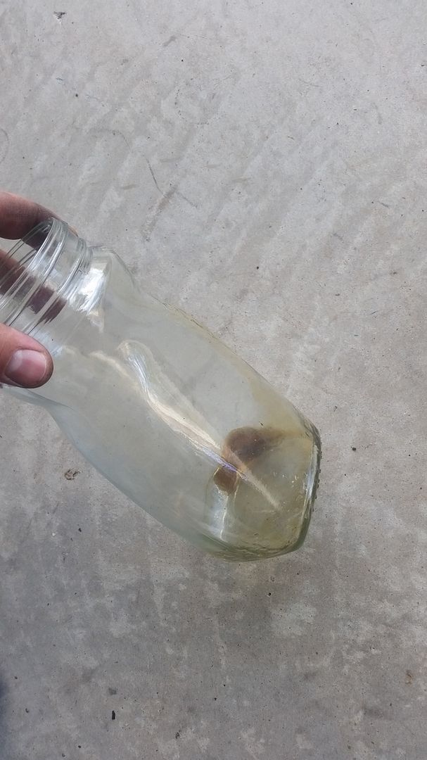

2: inspect and clean the oil catch can
This is the first time ive opened this up since installing it, and was half expecting sludge as ive seen on tonnes of other e85 powered cars
There is a touch of brake fluid in the container aswell...so its actually less ;)
What i found was perfect....lucky to be 10 to 15ml of nice clean oil...no sludge...and no oil making its way back into the intake
i think where its sitting it is keeping the can nice and hot..so its keeping the sludge at bay
Excellent!
Another job done :)

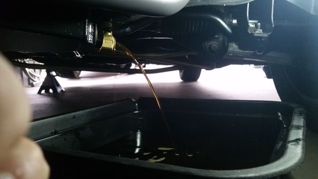

Posted 24 July 2015 - 11:36 AM

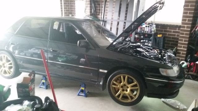

So the day has come to throw the old girl back up on the rollers :)

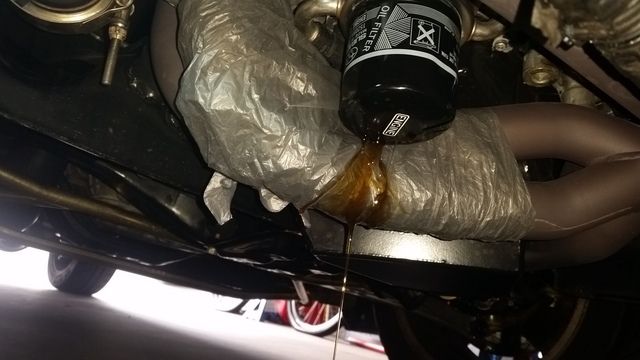

Even though the oil is still fresh, i thought for a bit of insurance id change it out for some fresh stuff and a new filter

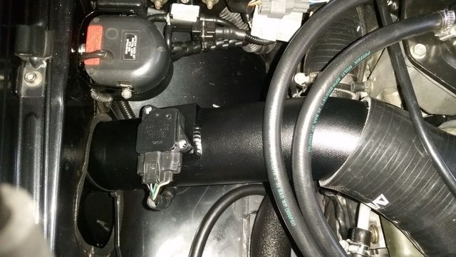

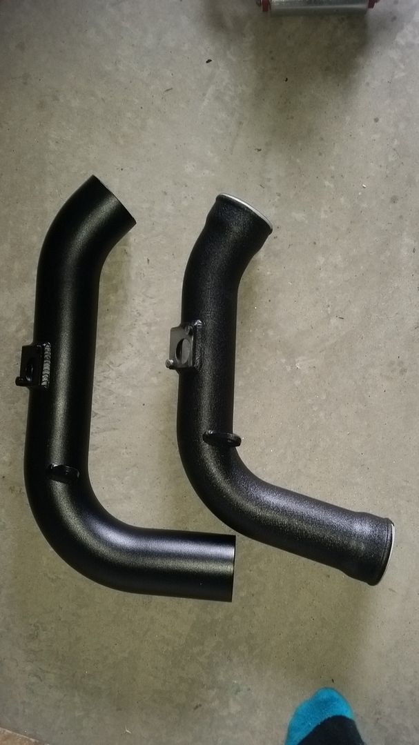

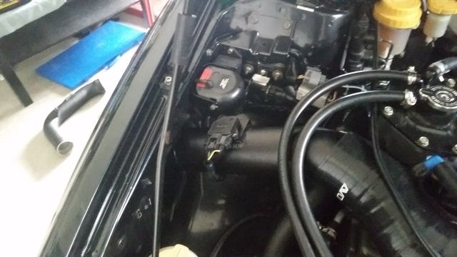

While the car was up i also test fit the new 72mm intake to make sure it was all good
It was spot on...bit different angles but a bit of tweaking and its all gewd :)
Shame i had to remove it again..just to install it again in the carpark at MSR lol
Meh its an easy change i suppose

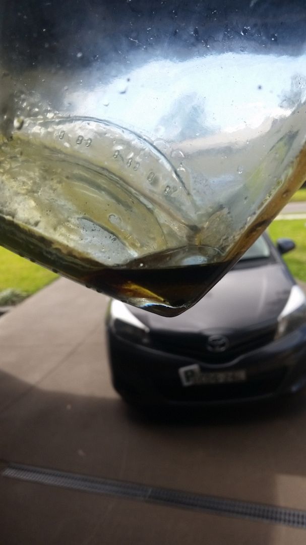

#shedlyf
the oil was super clean...e85 life i suppose
one silly bit about the killer b headers is that oil goes all over them if you're not careful lol...worth it though!
Little bit bigger
