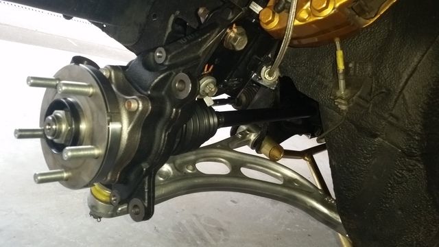

More pics of the fun today....lunch now, but will get the tie rod ends on to the new set up and start rolling the guards
New rack feels smooth as! And the shorter ratio is awesome...good to have a quickrack again like the gen3 :)

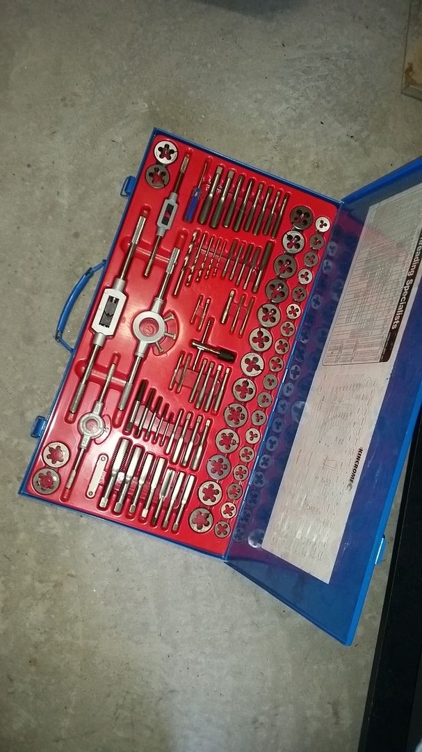

and the one piece of equipment that i feel was the saving grace of this whole car build....had saved me a hell of a lot of heartache lol

Those bolt in hubs look mint
#967 Matt
Matt
  • 4,380 posts
  • Location:Lake Maquarie NSW
Posted 18 July 2015 - 04:02 PM
Yep theyre pretty damn meaty!! The bearings are massive compared to the standard rs ones lol
6 gun did an awesome job of modding the hubs to fit all the early stuff...everything just slotted together perfectly

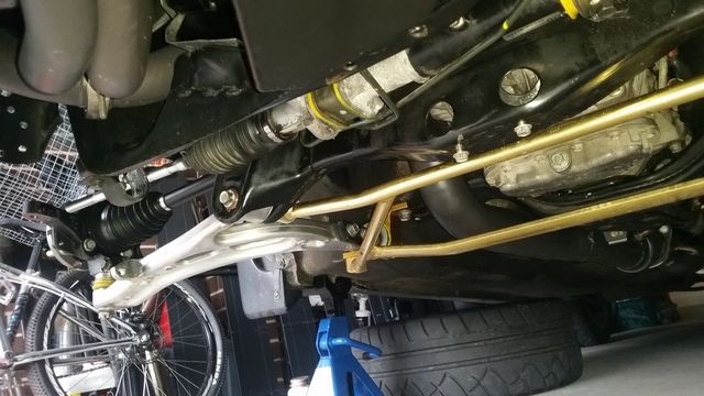

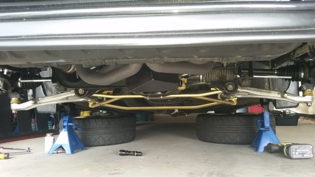

So its all in....took a lot longer than i had expected...mainly as i had to redo stuff over and over again :(
Got fairly over it this arvo hahaha
Found out that the new arms have added castor in them...so with the free castor mod and the ALK i fitted a rim and it was jammed hard up against the bumper?!
Removed the free castor mod....still way too close
Tweaked the alk back and it still hit
Removed the alk and fitted the sti bushes that came with the arms...they are crazy solid?! Maybe these were spec c arms?
After all this it was perfect....a touch more caster than i had with the gc8 arms and the other mods...b it doesnt hit the bumper any more :)
New track fills the guards so well now! Going in for an alignment in the morning, but even with a rough eye and tape measure alignment i have no scrubbing so far :D
New rack feels so good! Bit heavy at carpark speeds...same as the gc8 quickrack i had was..but becomes perfect at speed
Even though i centred the rack i ended up with more lock to the left...about 1/8 of a turn on the steering wheel
After yanking the steering wheel off and moving it a few notches it is now spot on and much better
Also after having more than enough of cars fo the weekend...i decided to bump the rear coilovers up 4 turns lol
Im done now....no more!!!
For a few days atleast lol
Only one pic atm...more later
