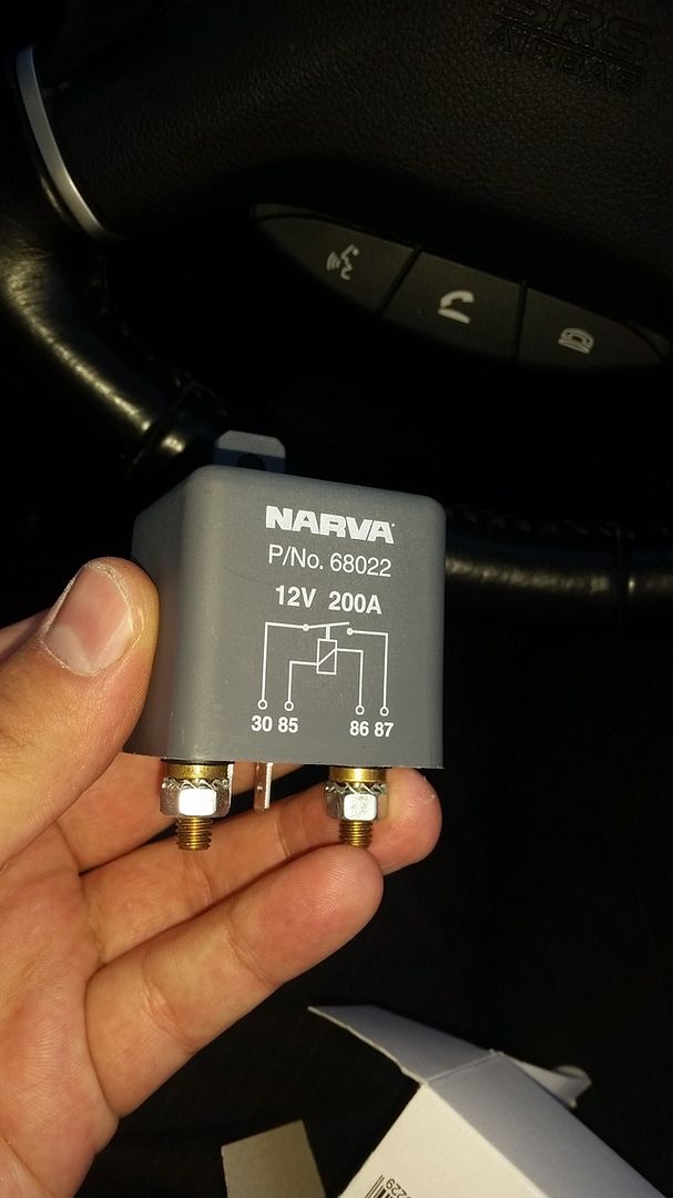

So with this in mind i went about fixing it up to keep me content with it all...first stop i wanted a relay that i could bolt the cable to..ie not having crappy crimped connections that could fail
Enter this bad boy....ordered a 100A as they are the smallest amperage relay that has the 6mm stud terminal....but got a 200A lol...same size and weight though ;)

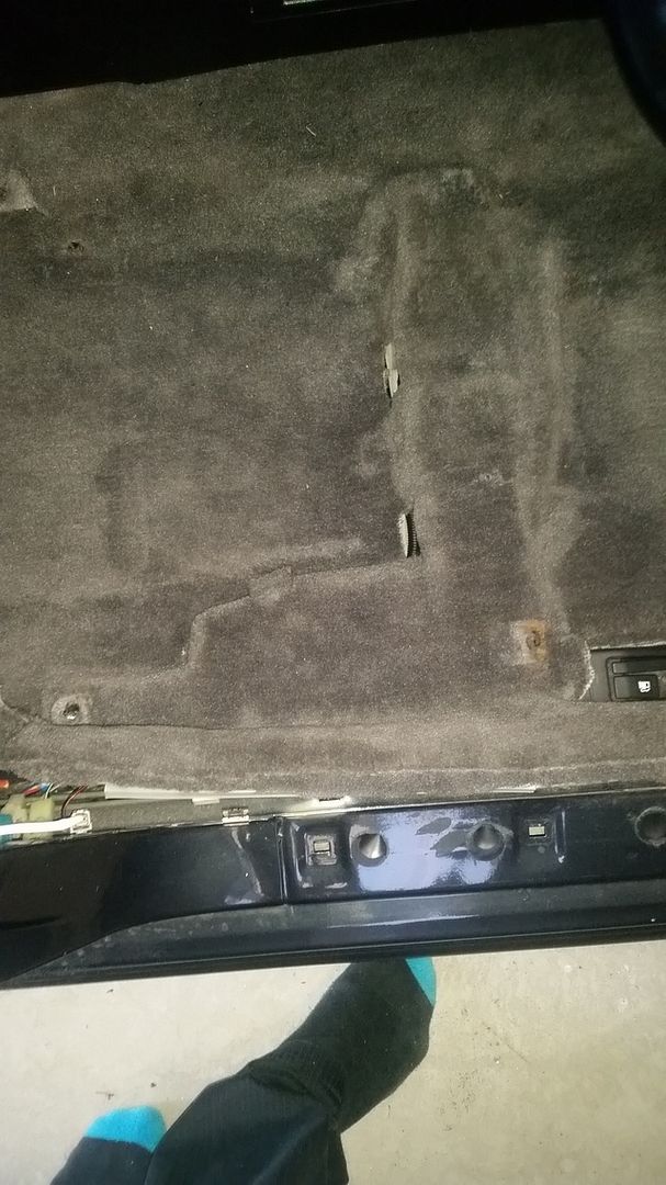

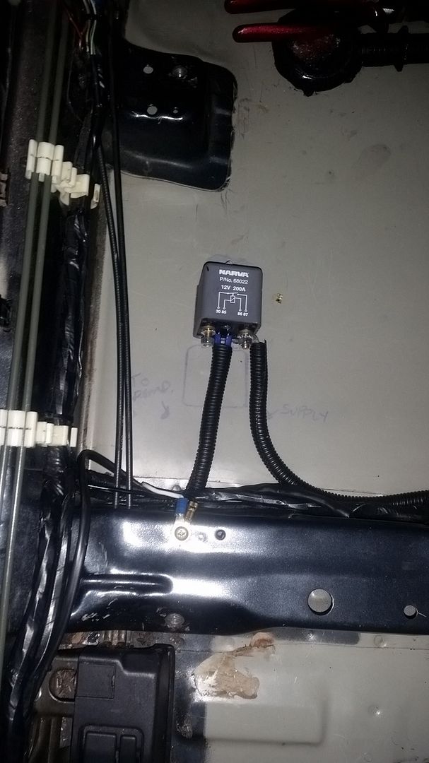

I needed to find a more suitable spot to mount it as it wouldnt fit where i had the 40A relay....and i didnt want to add any more to the cable from the battery....so under the drivers seat was a perfect spot with a preformed hump already there :)
See with carpet over it it is all gone
Bolted it to the floor...and sealed up the bolt hole to keep it water tight (still yet to run the cable to the pump in this pic)
All the wiring isnt finished yet as it needs to be soldered and heatshrinked, then all cable tied together ;)

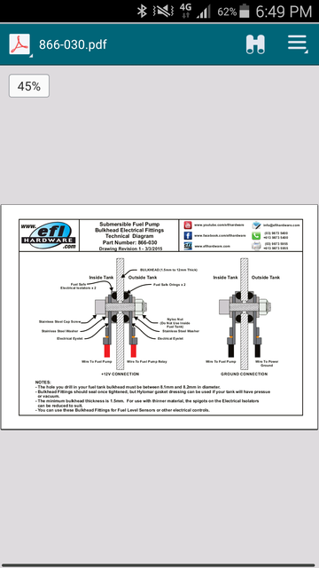

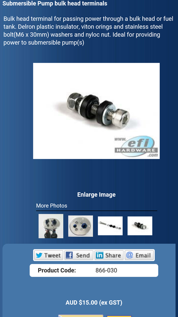

I will be running an 8 gauge positive directly to the tanks pump lid and using electrical bulkhead conectors drilled through the lid to bypass the OEM plug on top of the lid to remove any points of failure
Ill be adding my own sealant to these to ensure theyre vacuum tight...and adding an extra nut on the outside so they stay tight when the wire is removed for lid removal
Another thing im doing is running an 8 gauge black wire from these bulkhead terminals straight to the fuel pump controller to uprate the ground wire aswell as the positive

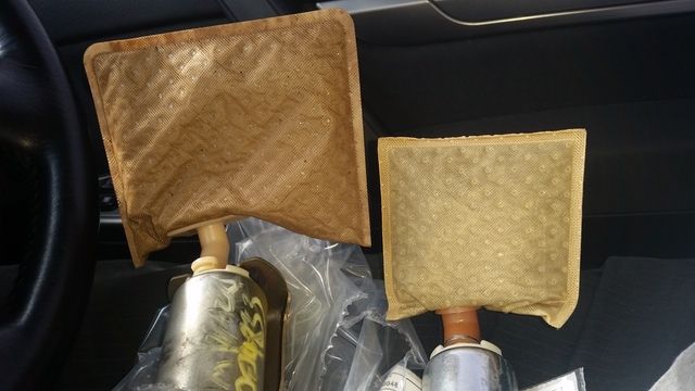

In other news i got my STi anti slosh box...but it didnt have the OEM pump strainer...and the walbro ones are too small and shitty, and they create more issues with fuel surge which is what im trying to alleviate lol
So i scored a cheap as used assembly with an OEM strainer on it which after a tidy up in fuel looks the goods :)
OEM on left...Walbro on right

Looks like a starter relay. :P
#1080 Matt
Matt
  • 4,380 posts
  • Location:Lake Maquarie NSW
Posted 06 August 2015 - 04:29 PM
Its a motorbike starter relay pretty much ;)
Real hard to get a relay with stud terminals unfortunately...100A is the smallest ive ever seen
And the 200A is the same size and doesnt seem heavier
