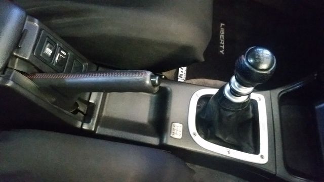

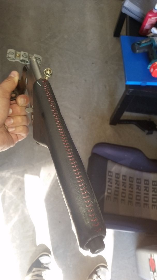

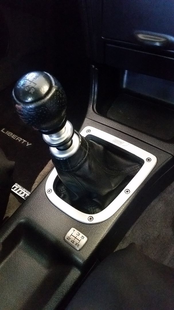

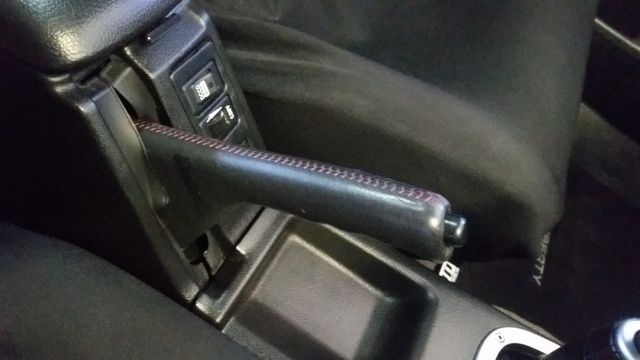

Scored a cheap as chips bugeye STi handbrake lever with the sexy red stitching recently...wanted it as the RS lever is flimsy as fork when pulled hard and of course has no red stitching lol

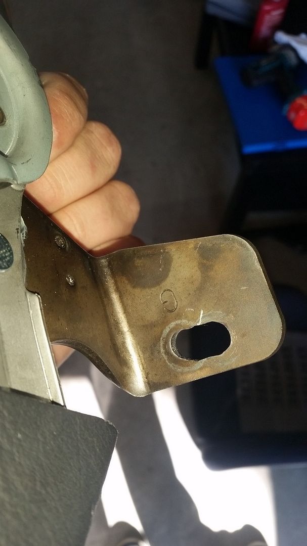

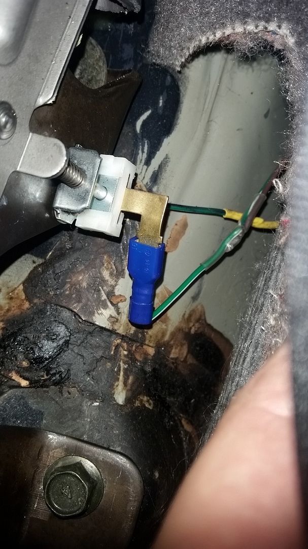

Piss easy to install....just needed the front hole elongated approx 5mm to line it up properly, and a bit of wiring changes as my RS park brake switch wouldnt fit it...so i just cut and crimped on to the STi switch
The new lever is heaps more solid, but to make sure it was as stiff as i can get it i added a big washer to spread the load over the front bolt bracket....worked wonders!
Dremel to the rescue!!
Mmm red stitching to go with my other bits
Huge washer to spread the load
Small wiring changes needed
And done...feels stiff as fork now

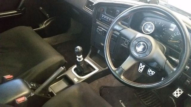

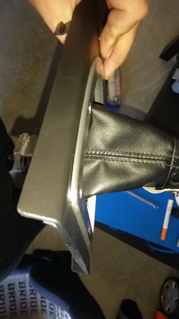

Also i scored the final bits i needed for the V7 alloy STi shifter surround
Took some forking around, but the dremel and some patience made it easy as
The surround wouldnt sit flush with the panel as its not as curved as the STi one, but i added some small screws to pull the two together...came out tops!!
Also needed to hack a bit off the lower panel to clear everything...but after all that it looks so much better than the ribbed RS boot :)
Bit of cutting and it fit a treat, gold screws are pulling the surround tight to the panel
More cutting
Sits fairly flush now :)
Let the fapping begin!!!
Ive got a Redline shift boot coming atm with red stitching aswell just to top it all off ;)
Thanks for watching!
#1104 duncanm
duncanm
    wha' who ?
  • 2,019 posts
Posted 17 August 2015 - 12:57 PM
very very nice job on the shifter surround

#1106 Matt
Matt
  • 4,380 posts
  • Location:Lake Maquarie NSW
Posted 17 August 2015 - 01:16 PM
Cheers mate! Was easier than i expected and changes the look of the interior so much
Porn. Always thought the accordian boot on the RS and early impreza looked poo
Haha yeah i was torn actually...i hated them, but kinda liked mine on the 6 speed shifter lol
So i was unsure whether to swap them.....i am no longer unsure...it looks amazing :)

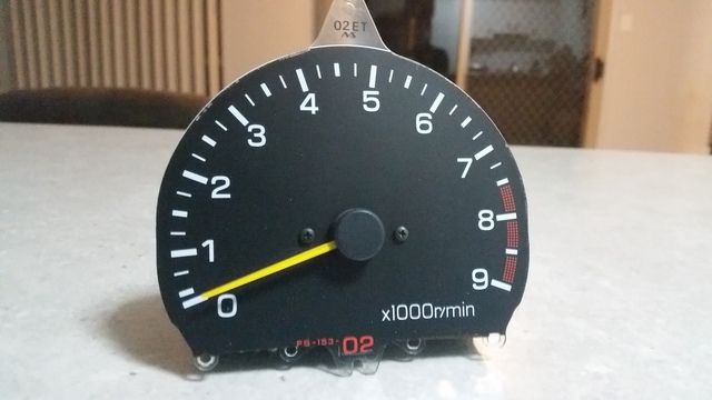

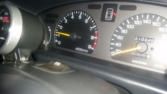

Posted 20 August 2015 - 07:22 PM
Small photo update
Big thanks to Adrian (Reevesy) for selling me a 9k tacho cluster for a great price :)
Once i saw Miguels i was uber jealous and had to have one lol
Took it out of the old cluster this arvo...very easy to remove!
And willbe going back in tomorrow...possibly with another rev related item ;)
Now the tacho will match the engine mucho better
More pics once installed

9k tacho installed....so easy...took all of 10mins
Works a treat :)

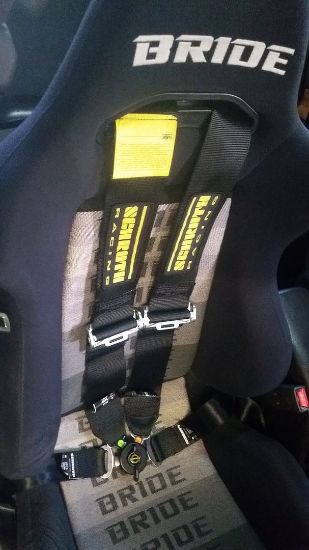

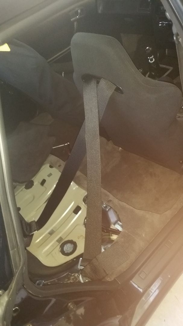

Im planning to do my first hillclimb in a month or so and many more afterwards...so decided to start getting some safety gear so that im protected a lot more...gotta take care of #1
Decided i needed to get a harness with ASM (anti submarining technology) which stops you from slipping out the bottom of a 4 point harness in a crash

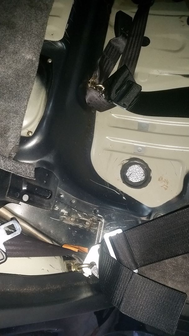

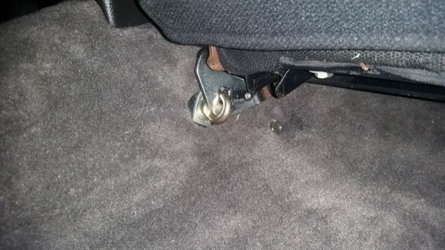

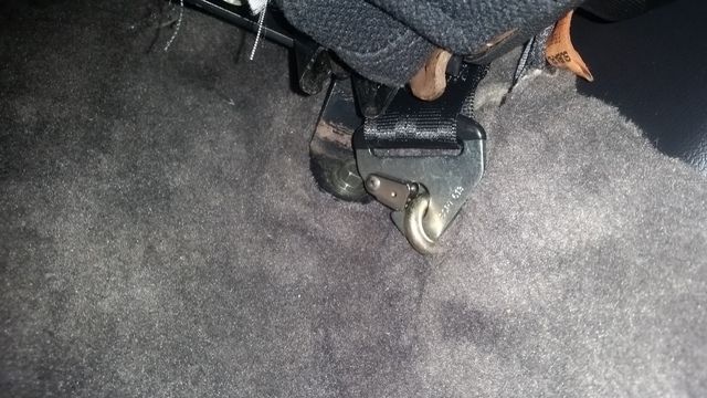

Ended up with a Shcroth 4 point Clubman Saloon ASM II in black ofcourse...it is a clip in which allows me to swap 4 seat belt bolts for hi tensile eyebolts
This allows me to remove the harness with just a few clips as the eyebolts stay in all the time
And the mounting points
All bolts were cut to the same length as OEM and loctited in to be safe :)

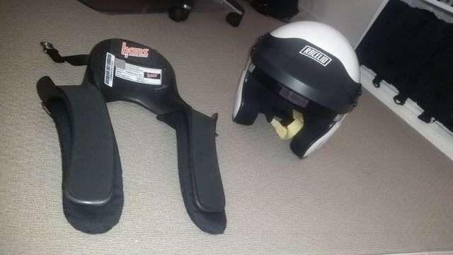

And after deciding i dont like my full face helmet in the car...i looked in to a good but cheap open face helmet...and in doing so was getting more and more convinced that a HANS device is a very valuable investment...particularly after watching this relatively slow crash
http://jalopnik.com/...rash-1532535262
And the beauty is theyre now heaps cheaper than a few years back ;)...heaps cheaper lol...whilst $500 may seem a lot....i think its well worth it for the extra protection offered
Revolution Race Gear had a sweet sale package of a Racelid Jet open face helmet (bell mag7 copy) and a sport 2 HANS device with the required posts
Such a good deal, and even better when i got the harness...and just wearing it all in the car you can tell how much more protected the neck is from damage
Safety first people ;)
