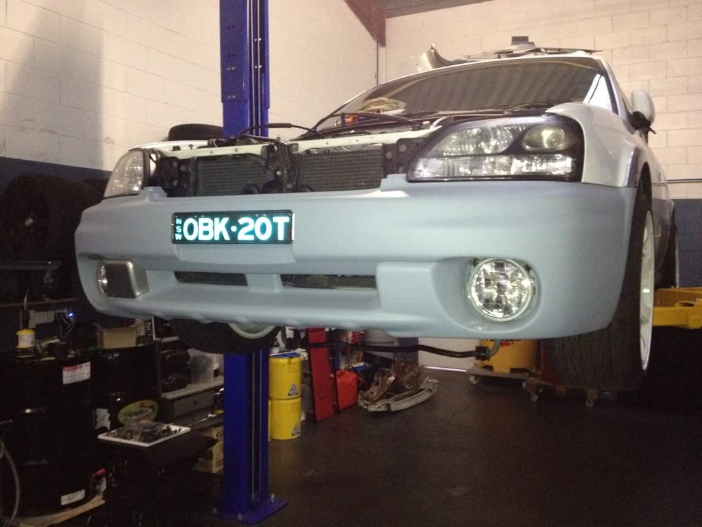

Also, pics!
Plastidip works a treat!
Top mount sandblasted...
Looks mint. :)
Dump pipe on.
New front bar, awaiting paint. New plates.
Almost!!!
[03.SUBY]
