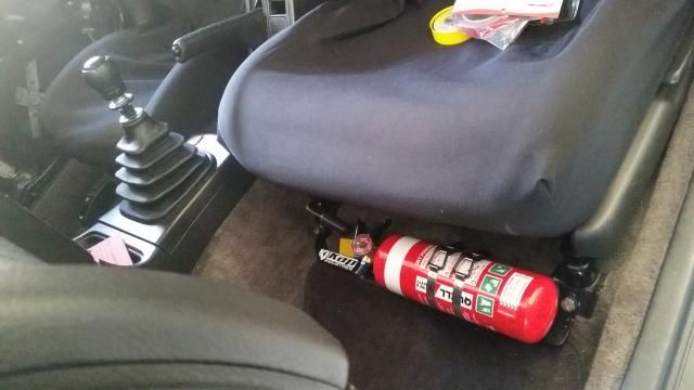

Posted 07 March 2015 - 05:02 PM
Got a free half an hour today, so knocked a few little bits of the list
Deburred, filed and cleaned out the cold side intercooler pipework and clamped it all up, put the horns and headlights back in properly
Also got a fire extinguisher whilst at bunnings and mounted that to a bracket ive had sitting around....had to drill out the seat bolt thread that has been crap since i bought the car...rethreaded it to 12mm 1.25 and put a hi tensile bolt in...need a slightly longer one...but itll do the job for the time being

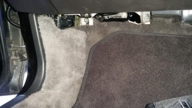

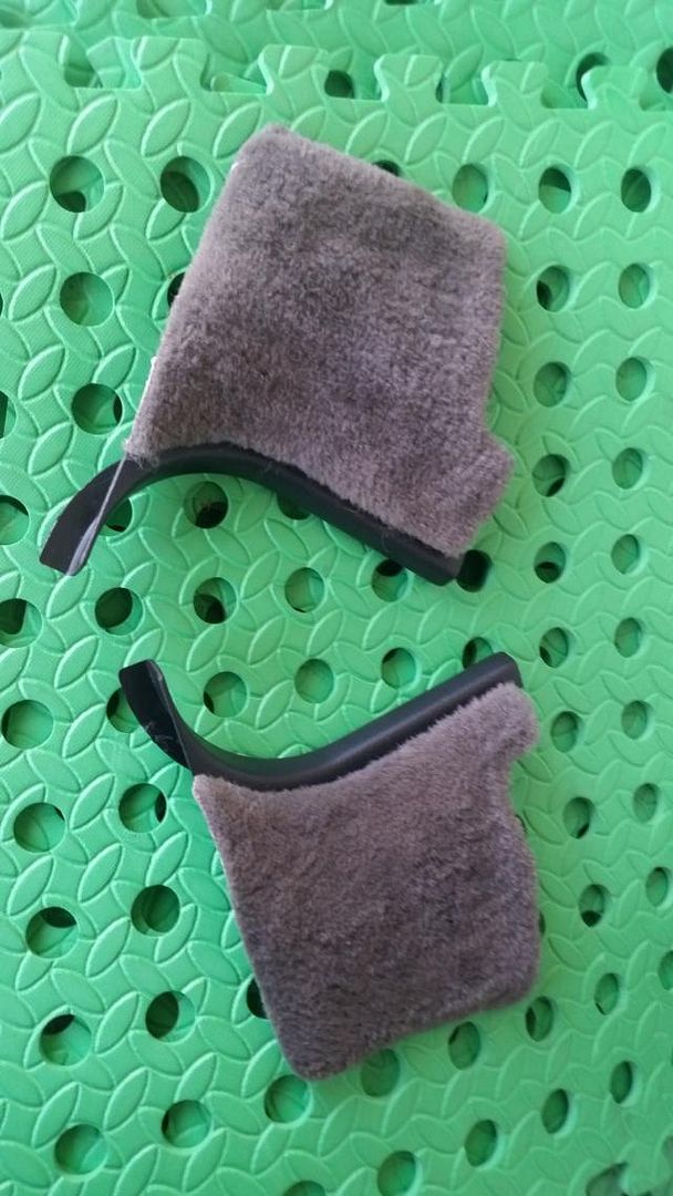

And due to fitting some series 1 legacy carpet out of a wagon and it being a grey i had to swap the new carpet on to my old rs kick panels. Found a new contact adhesive that looks the goods and tore the old stuff off and glued the new stuff on....completes the interior that touch more :)

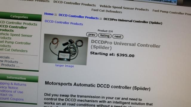

And as hinted above, i am just waiting on my dccdpro uni controller with oem sti switches to arrive to help control the 6 speeds centre diff
I was heaps happy with the one in my old gen3 so why ruin a good thing ;)

Also after much swearing working under the dash (i hate it!!) I got the dccdpro installed....tests out all good electronically...will see how it goes once the car is on the road
