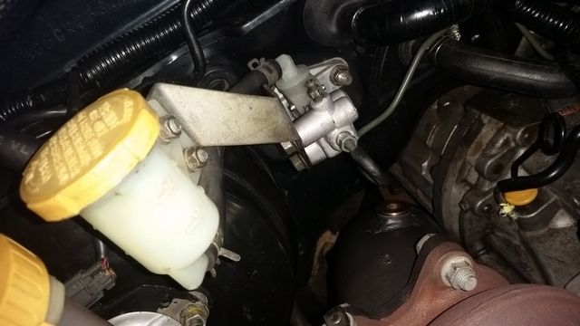

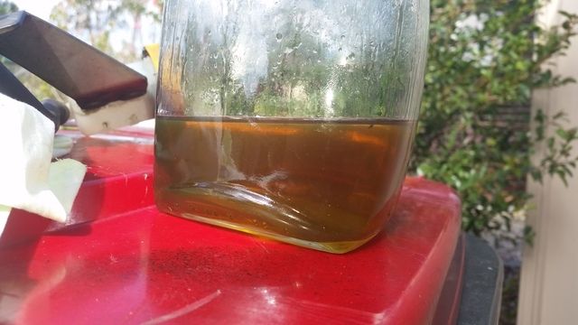

Clutch is fixed!! What a mind fork of 3 hours that was!! I wanted to smash something hahaha
Slave just would not pressurize? I cleared all air bubbles though in a slow fashion
Then after over 3 hours of removing and bleeding and pulling vacuum and everything possible it started to pull in fluid ju st as i gave up lol...pumped it for like 5 minutes after this and it heaps better!!!
Need to fiddle with the clevis for pedal free play in a few days....but atm its awesome!!
Still shudders ard if downshufting to 2nd with a rev match/heel toe....gotta get my skillz back again as i drive a slush box daily lol

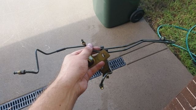

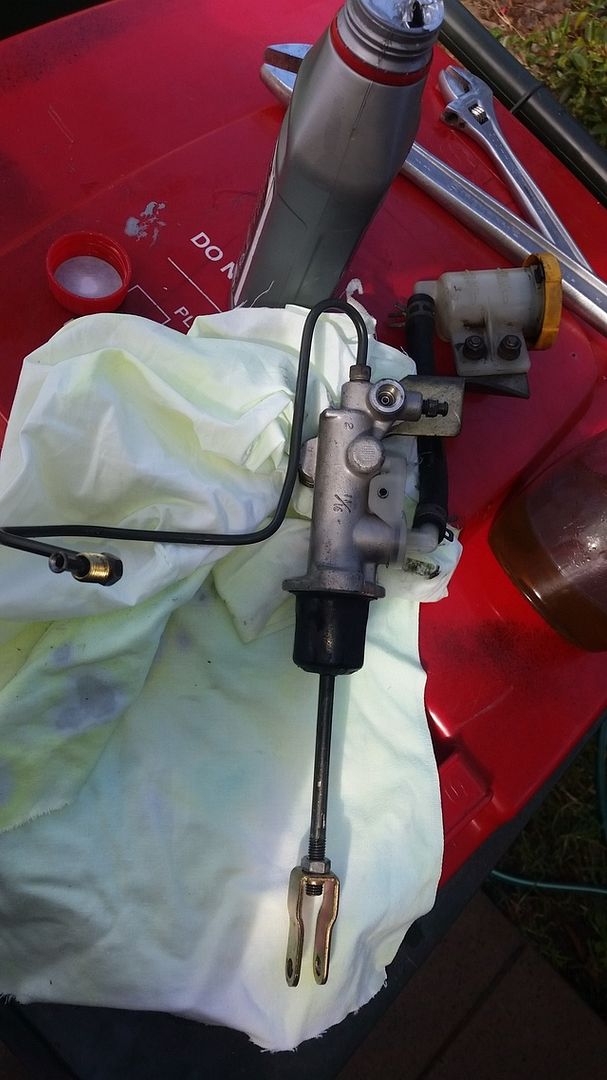

But pretty much all i did was create my own gd spec c single line master from a gd wrx multiple line (ones with all the extra pipework)
They are all the same master cylinder...all you do is remove all the pipework except the one coming out the very tip as thats your feed to the slave....or in my case use the rs pipe with a bit of bending to suit which saved me a bit of time
To get this
remove all this
bench bleed it to clean it

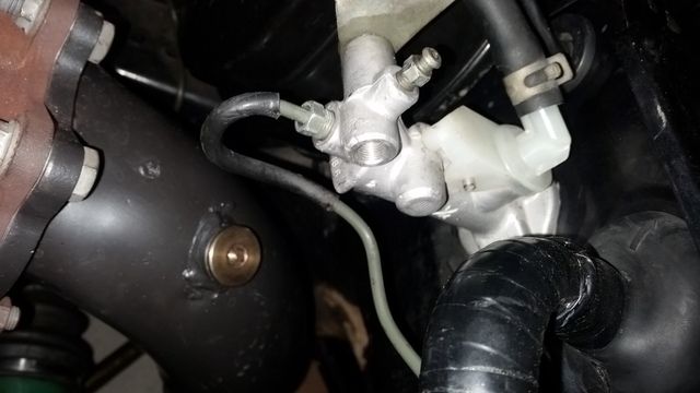

and bolt it up...and bend the pipework to suit
That nipple does nothing now...its connected to the threaded hole under it...just clean them out and leave them empty
Its now matched to the right slave...where the rs master wasnt the correct match in bore size
Picckup is still around the 3/4 mark...but its better and more predictable then engaging in the last 3mm :/
So ill probably give it one more bleed tomorrow and its all good to go to paint :)

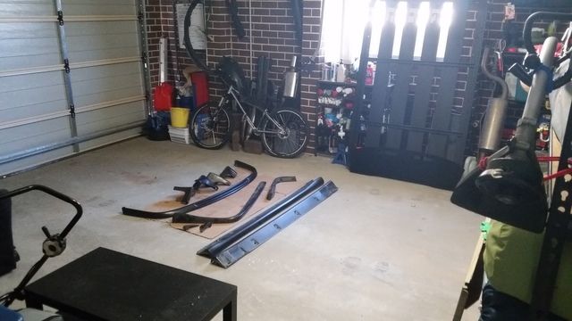

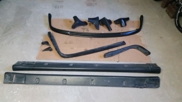

Whilst i have the space, im going to do a little bit of painting myself
everything here will be getting a wash, sand back and smooth and coated in a decent rattle can satin black
Will leave the rusty mud spats brackets bare until powdercoating and send them off with the rest of the bits going for satin black powder

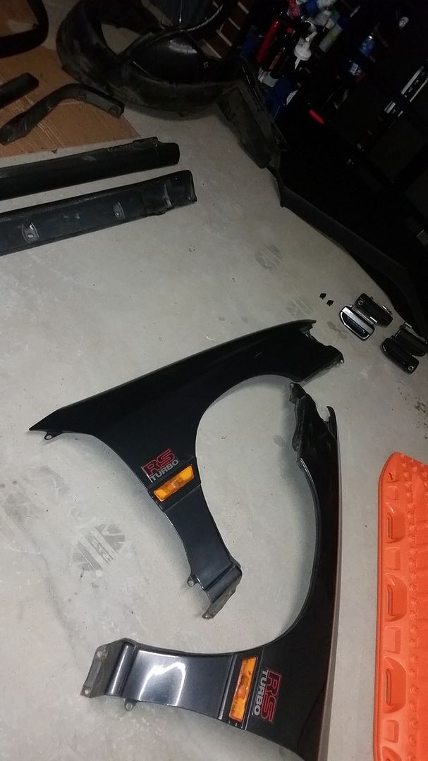

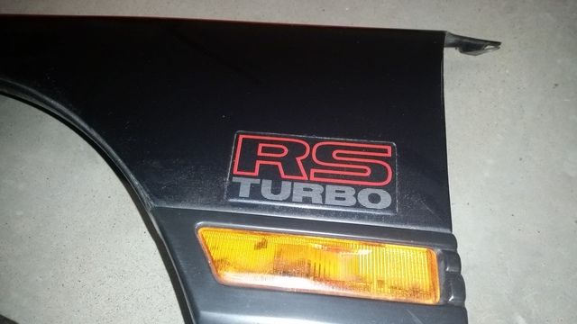

better door handles, a pillar trim, inner guards, steering column cover and some nice rs guards in that awesome 222 colour
Done an amazing job of packaging it and everything is perfect :)
And the guards have the rare bubbled rs logo which is noice
all will be going on as soon as the car is back along with a whole host of bits
Smiles all around :)
