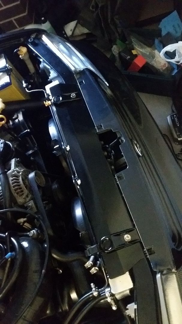

A bit more black added to the engine bay today
A zerosports radiator diversion plate that has been temporarily blacked out till i do another powdercoat order
Hides the alloy radiator a touch which is a good thing

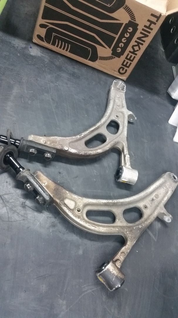

But of tine to kill at work...so spent some more time prepping some bits for the GD track and r180 conversion
Put the r180 shafts back together with fresh grease and new boots after a full strip, wire wheel and clean...much better now, and will get a lick of paint asap

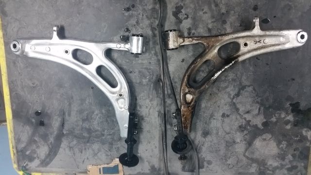

Also scrubbed the gd sti front alloy arms up to almost new as they were filthy!! Cone up good with a quick hit with steel wool
Before (and this was the good side)
And side by side before and after

Also i pressed out the gd sti standard front bushes on the control arms and put whiteline GC8 press in motorsport bushes as ive had them for 5 years now waiting to use them lol

Posted 08 July 2015 - 04:03 PM
Are those spherical bearings in the GD arms? shiny shiny looks good was wrapt with how mine came up too.
#919 Matt
Matt
  • 4,380 posts
  • Location:Lake Maquarie NSW
Posted 08 July 2015 - 04:04 PM
Nope as said in the above post theyre whiteline motorsport grade press in bearings
