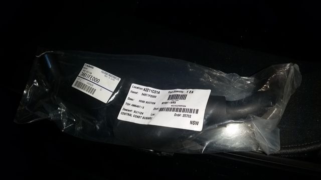

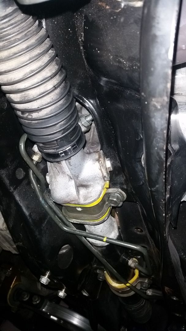

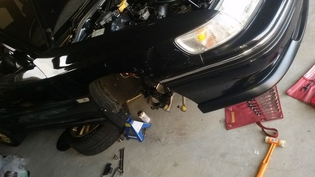

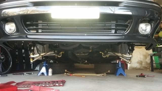

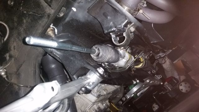

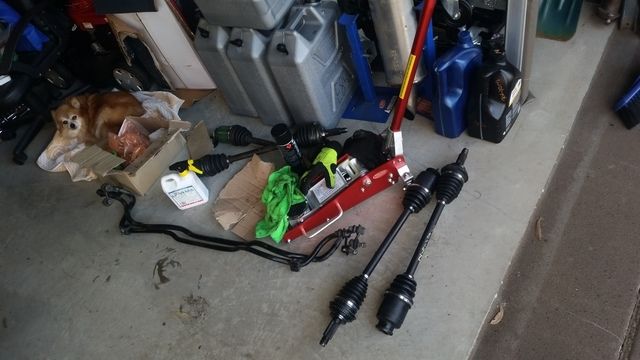

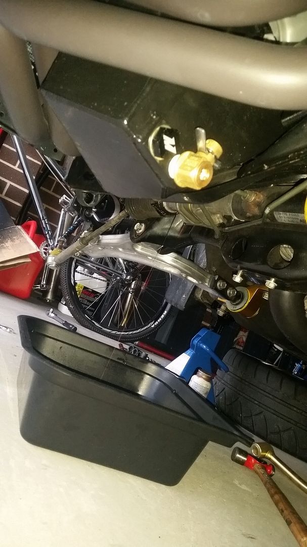

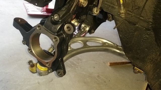

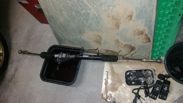

More time spent on the old girl today
Pulled the control arms, hubs and steering rack ready to swap it all out
I only had the arvo free...but i still ended up getting the GD arms on, along with a quick refresh of the bushes. Also got the 05 sti knuckles installed, fe440 quickrack bolted up and the lines plumbed in....just have to swap tie rod ends tomorrow, replace the pump suction hose and the steerings done
The guards will need a quick roll tomorrow due to the extra track, and the car will get a rough measurement alignment before going in for a local alignment on Monday
Found out the gd sti swaybar wont fit as it hits on the dent for the up pipe...despite hearing i could.....but the aftermarket swaybars are straight where it hits
So at a later date ill grab a whiteline bar for a gd and fit it up
In the meantime im putting the rs 18mm back on but will be adding 2mm to 3mm off washers to wach end of the seaybar links to space it out properly and keep the links at the right angle
And only one more week till the retune...im fairly excited lol
So long 2.7 rack
OEM PS suction hose to replace the mitsubishi lancer/DIY hose i have atm
