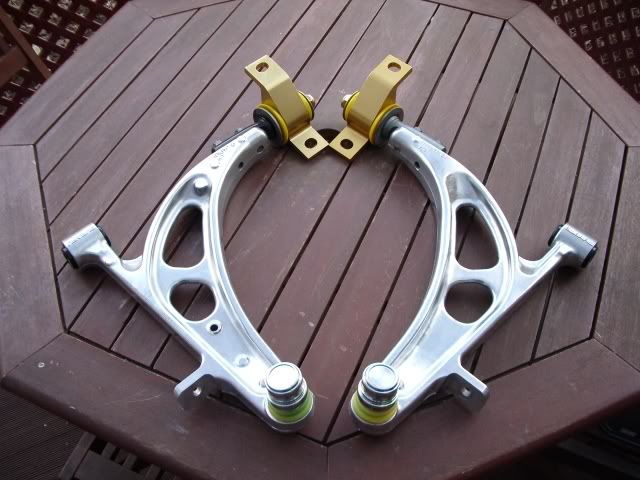

Yep figured as much lol
All gewd :)
#922 CRUISN
Posted 08 July 2015 - 04:53 PM
Shiny! :D
#923 Matt
Matt
  • 4,380 posts
  • Location:Lake Maquarie NSW
So very shiny!! This is why you should do yours Mark ;)
#924 CRUISN
Posted 08 July 2015 - 04:58 PM
I contemplated it....... but got over the thought quickly. :D
I polished the ones on my Gen2 GT...... :P
#925 Matt
Matt
  • 4,380 posts
Posted 08 July 2015 - 05:01 PM
So nice! Thats how shiny the gen3 one were...i spent hours on them lol
These got 15mins of my time and that was it...i just wanted all the crap off them
Looks like you had the same front bushes as i have?

Posted 08 July 2015 - 09:18 PM
Dem arms, dat alk, dat roll centre kit
#927 Matt
Matt
  • 4,380 posts
Posted 08 July 2015 - 10:26 PM
Its certainly a killer combo ;)
