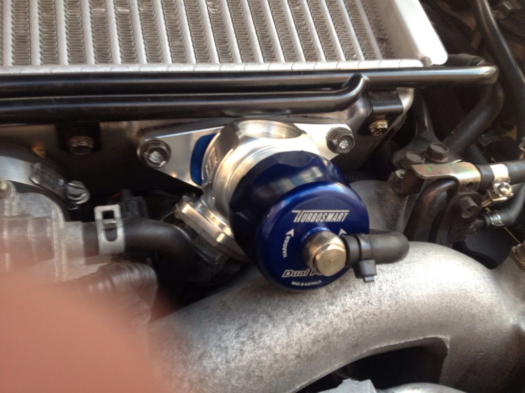

#213 Sam
Sam
  • 1,971 posts
  • Location:Coffs Harbour
Posted 09 August 2012 - 10:22 PM
Much better :)
Dual Port!

#214 Ben_20EJT
Ben_20EJT
  • 2,397 posts
  • Location:northen beaches
Posted 09 August 2012 - 10:29 PM
plumback only mate.
#215 Scott
Scott
    Formerly LiBeRtY Gx AwD
  • 1,498 posts
Posted 09 August 2012 - 10:31 PM
i got one of these!
have you got the trumpet and the blanking screw top?
i have about $1.80 of 20c pieces shimming it up
#216 Sam
Sam
  • 1,971 posts
Posted 09 August 2012 - 10:38 PM
plumback only mate.
Huh?
i got one of these!
Yeah but the trumpet won't fit on there because of the lines that run along the top mount...?
What's the blanking screw top?
[03.SUBY]
#217 Scott
Scott
  • 1,498 posts
Posted 09 August 2012 - 10:43 PM
ah ok, the bov normally comes with flex hose to replace the metal lines, so you can run the trumpet
the blanking screw top is for if you need to run it plumb back if you ever get defected etc ive never used mine tho
#218 Sam
Sam
  • 1,971 posts
Posted 09 August 2012 - 10:50 PM
Ahhhhh yeah I understand now. There was a vacuum line in the box to replace that solid line..
And yes, I noticed the blanking plate. :)
What do you mean by the 20c piece trick though?
[03.SUBY]

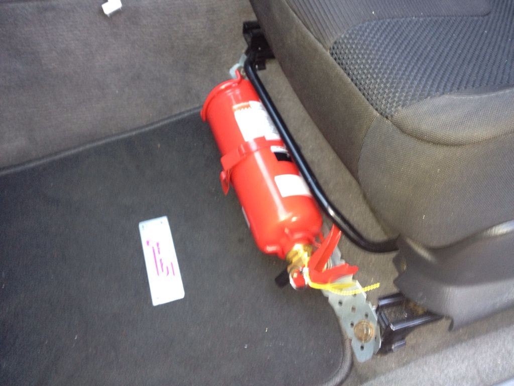

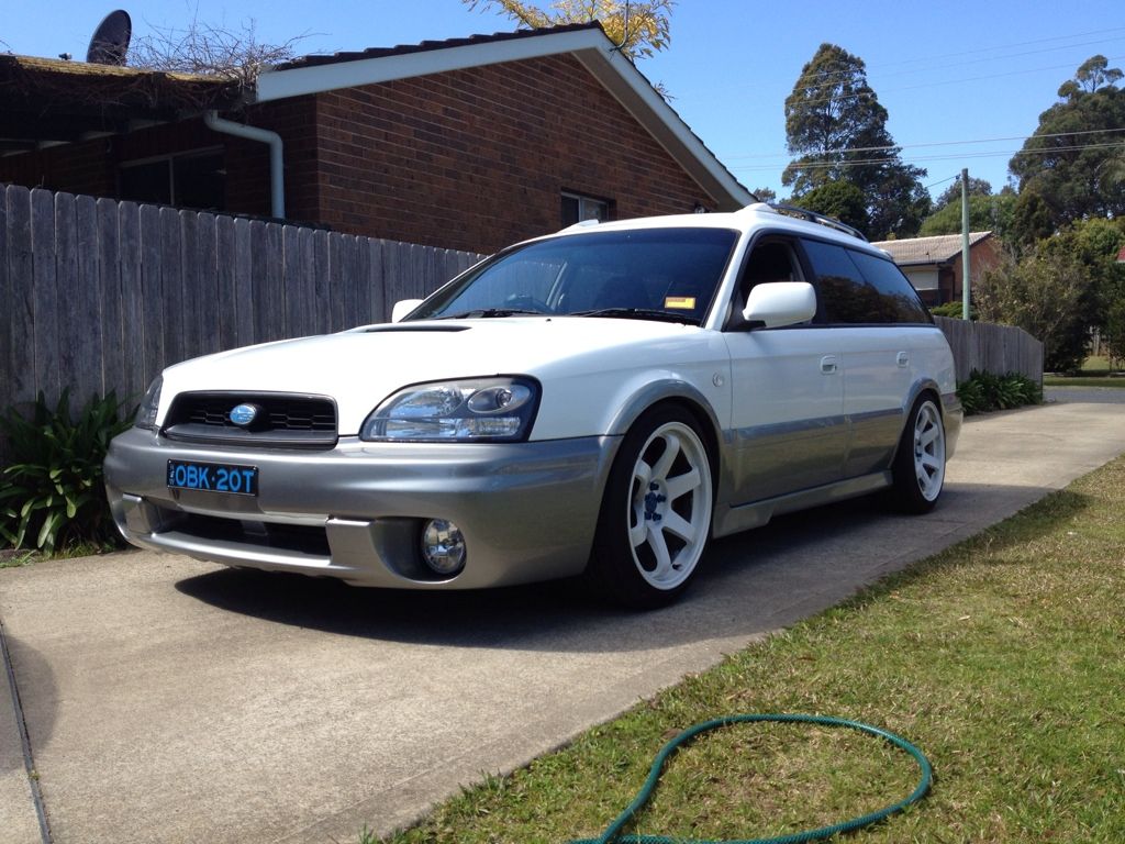

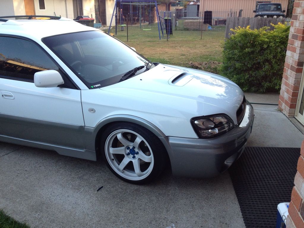

Posted 24 August 2012 - 04:52 PM
Righto guys, update time!
Car is running fairly good, other than the strange noise as if it is pinging when on full boost..
I have had the front bar and bonnet resprayed to their factory colours.
Very happy with the paint job!
Gave the car a wash/polish/wax the other night and detailed her right up...

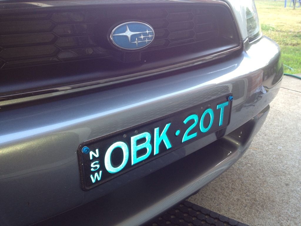

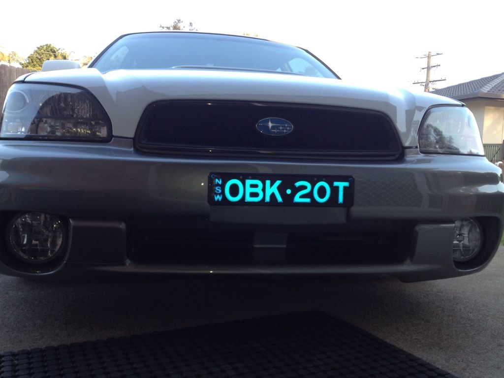

Got some little blue screws for the number plates, looks 100% times neater IMO.
I am entering powercruise in Brisbane at the start of next month, so I decided to install a little fire extinguisher, just to be safe.

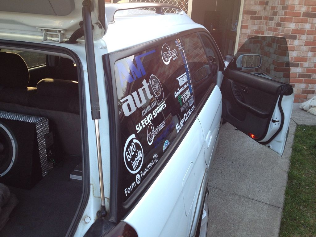

And stickers!!!
Most of the stickers on there are from people/business' that I have used to source parts, do work on or got information from during the conversion.
The sticker fad will probably die off, and Ill end up taking them all off hahaha.
