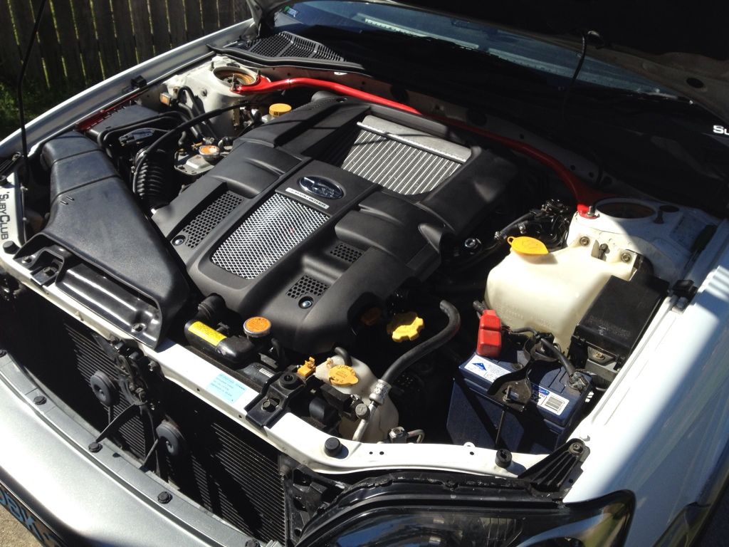

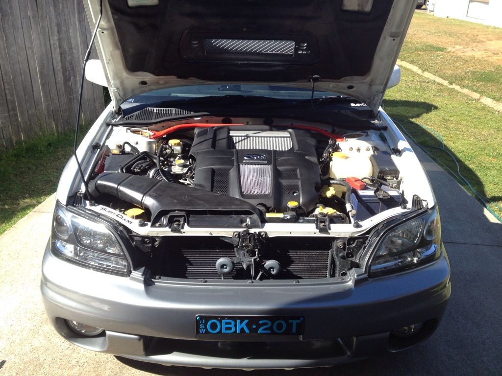

In other news, the engine cover came today.
Not to suit this engine, so I got to work with a pair of pliers, a file and a drill and its on there!
Cleans it up pretty good i reckon… What do you think?

I'm not sure if the TMIC has enough exposure to the venting given by the bonnet scoop.
Pinging is a little bit concerning.
Had it up on a dyno? If it truly is ping, it'd certainly show there.

I will be cutting a bit more plastic from the left hand side of the cover, to allow a bigger opening. Just need to get myself the proper tool to cut it...
And not as yet. The only 4 wheel dyno in Coffs was being repaired and should be fixed by now. The tuner doesn't get into Coffs until the start of next month.

Looks good sam, its an idea to make up a custom scoop surround to seal to the face of the tmic, as the tiny b4 scoop struggles to feed the wrx/sti top mounts...from my experience anyway ;) i had to add a lip to my scoop to get a just adequate feed to my sti cooler
Without a seal the air just goes around the cooler, not through it
And pinging sounds scary, take it easy on the loud pedal until its been gone over on the dyno, you dont want to destroy the engine...with the new turbo and exhaust its probably leaning out a tiny bit on boost and spiking higher than the ecu wants
